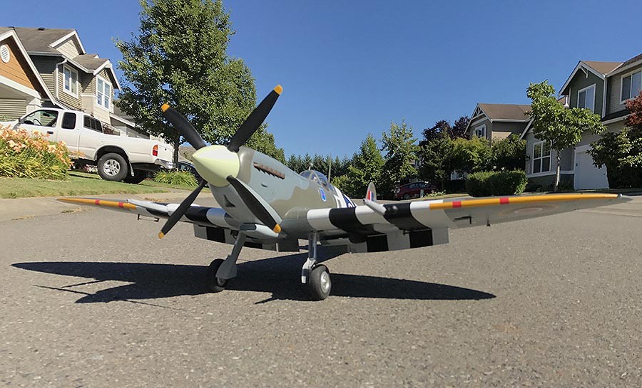

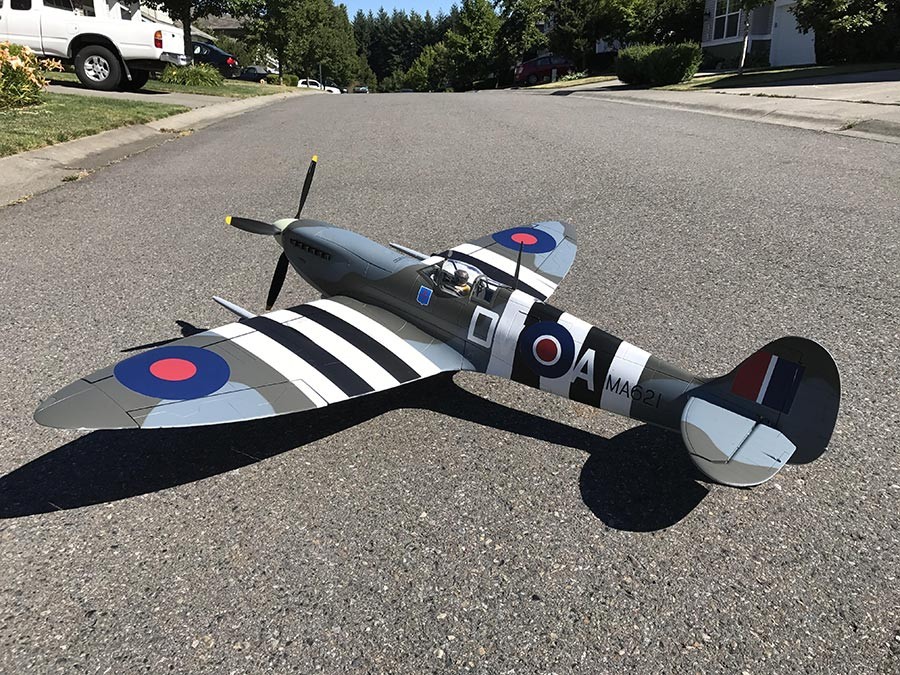

      Thanks! I used rattle cans. Fast Drying Flat White and Flat Black enamels from the local hardware store. Worked great. No primer necessary. Actually I found the yellow LE decals to be very easy to put on. Just took my time and used my thumbnail to smooth any creases over the edge.
      She's all done! Now I can just focus on flying and mediocre landings! LOL

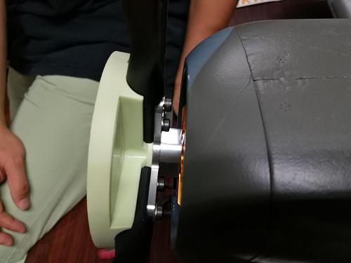

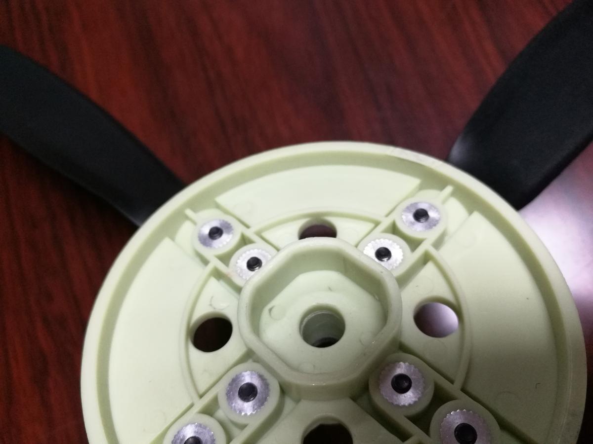

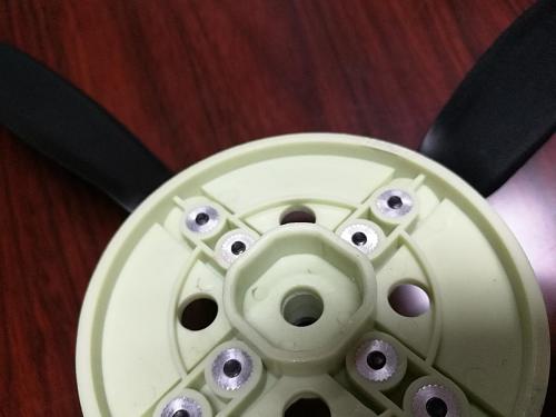

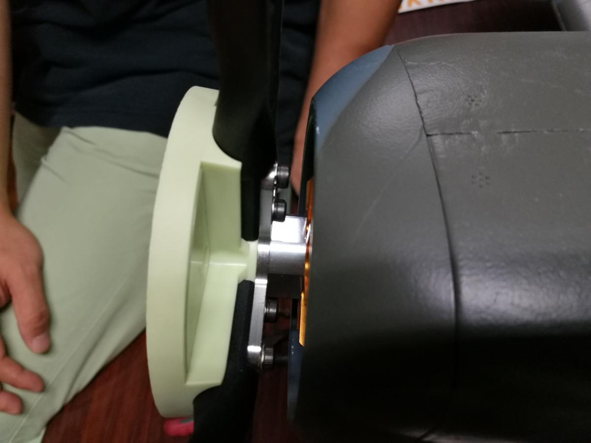

                                      Good link to a good overview. To add to that tutorial, here's a picture I took at the factory yesterday of the spinner backplate, showing a small line of mold flash in the center hole through which the prop shaft passes. This may be contributing to the tightness some people have encountered. If your backplate is especially tight, sand down this mold flash line as needed. Wobbly assemblies are bad, obviously, so err on the side of tighter rather than more loose.
                                      Click image for larger version  Name:	IMG_20170729_125025.jpg Views:	1 Size:	73.9 KB ID:	90142
                                      The tolerances are very tight, by design, and a good indicator before final assembly is to slide the backplate on backwards to verify the proper fit. It should slide on smoothly but snugly, all the way back as shown here:
                                      Click image for larger version  Name:	IMG_20170729_122932.jpg Views:	1 Size:	58.7 KB ID:	90143
                                      As always, never use the barrel nut to tighten the backplate over the prop adapter base. Align it by hand and press fit by hand, all the way down. Don't overtorque the barrel nut, either. A half turn past hand tight is sufficient.
                                      We can't put a Tru-turn level spinner ($120+) in a $349 1600mm PNP. I love heavy steel and milspec machined aluminum spinners, too, but that's not in the cards for any of the big foam warbird Mfrs. Some attention of the existing PNP design during fitting and assembly will yield optimal results, as with any prop assembly.

                                        Thanks Aros...I planned on rattle cans as well. Did you use a clear coat after? The Testors I tested on another plane was also a flat finish, but looks much flatter than yours. What brand did you use? You also have me thinking I may go ahead and try the yellow decals. Just to be sure...as mine seem to have a weird inconsistent finish...I know someone said they are peel and stick, but do they have the top film on them to be peeled away also? If not then mine may not be usable, but if the inconsistency is simply the peel away top sheet I should be okay.
                                        Yours looks AWESOME !!
