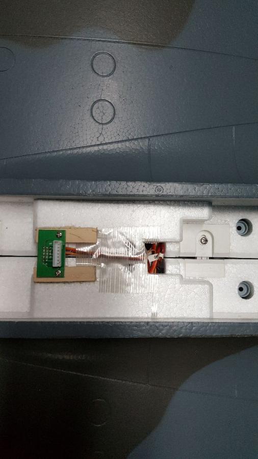

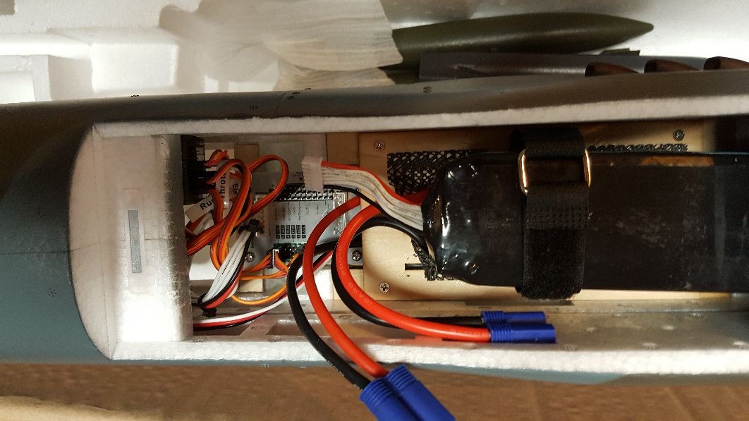

        my fix for the blue box of fiddlyness:
        i used the 80mm a10 quick connects and some very short y connectors. they will just barely stuff into the wings and some glued in plywood strips give enough clearence. everything fits snug. the wings have to be transported in one piece.
        some more ply and the mainboard in the fuse with the reciever directly above.
            That is a great idea. I wonder if the Tigercat controller will work the same?... Or even the FMS one?
            Which connection modual part is that on the actual wing?
                Its the wing connector from freewing 80mm a10 https://www.motionrc.com/collections...nnection-board
                there is also a cable and mainboard. Just goto the spare parts page of the freewing 80mm a10.
                if you want to transport the wings seperate and still use this connector you will need to cut into the foam a bit.
                ive got the fms a10 as well. I prefer the freewing method. The fms a10 connector looks like its going to cause problems eventually

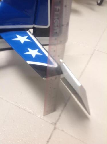

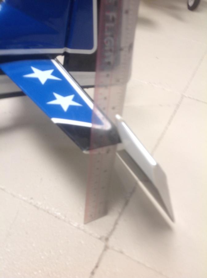

                          After I reduced the elevator throw for good flying characteristics I noticed that the plane did want to nose over a little easier on grass while taxiing. I will program high rate elevator with lots of throw for taxiing only and use middle and low rates for flying.
                              I use as high a rate as I can program for elevator for ground operations. It's easy enough to flip the switch when flying. I do this for every tail dragger I have.
