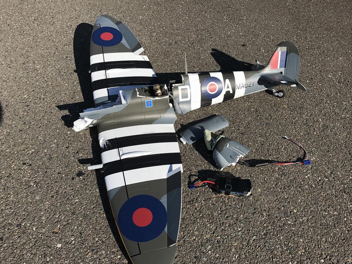

        I just got back from the school in fact. I had not heard back from anyone. I went there yesterday and it was still up on the roof. I tried calling the principle, I left a message and still nothing. I know this is not on their list of priorities with school getting ready to start. So I decided to drive over there again after work. It was still on the roof. Luckily, I found two willing custodians who had no problem going up to retrieve it for me. Risking life and limb! (I did mention I can't afford any ER bill so be careful, lol!)...

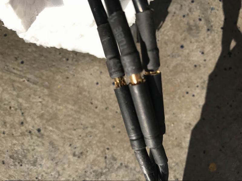

        Preliminary examination shows that the ESC to motor connections were in fact loose. However, that could have occurred on impact so there's no way to know definitively if that was the problem all along. The servo leads were still secure in their ports on the receiver. So no free replacement bird for me. There's just no way to tell if it was something on the manufacturer side or something that occurred on my side.
        I suppose it's salvagable if I REALLY wanted to see it fly again, but I rarely like to put "Franken-birds" back together. I will likely let the Friendly Vultures have at her. LOL
        (Speaking of, the first FV humbly asked if he could have the gear, however I do have a spare starboard gear that is still in the bag I will be happy to sell). I will likely prefer to sell a bunch of stuff to one person then spend the time mailing out several pieces to different folks. Just PM me if you're interested.

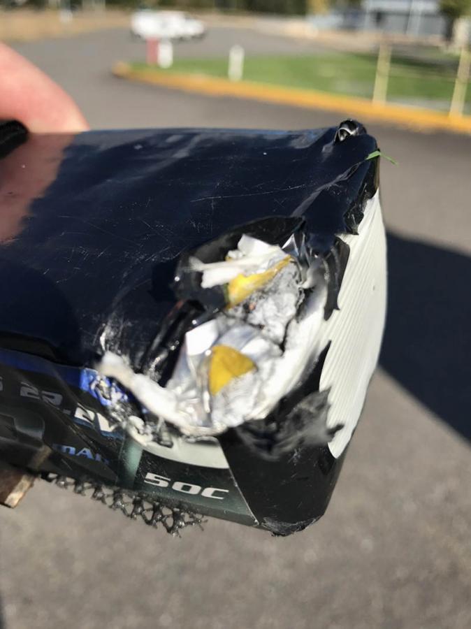

        I think I am as ticked off that the Admiral 6S 5000 was destroyed as much as I am of the Spitfire crash. It was a new battery that I used for my A-10 and Avanti. :Angry:

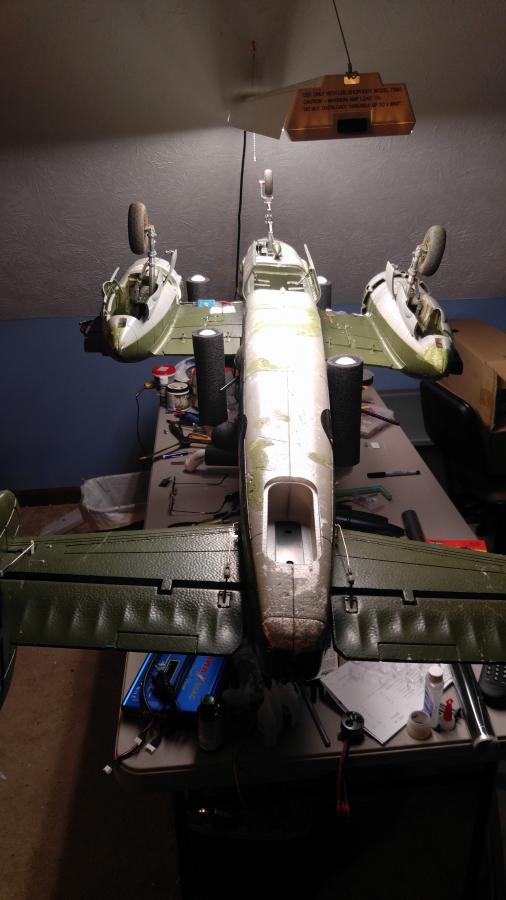

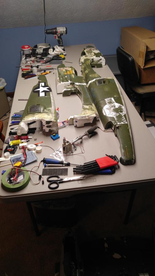

ID:	95053Click image for larger version

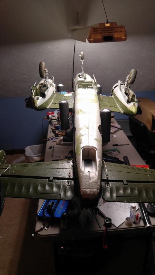

ID:	95054 You can fix that :) Speaking of frankenbirds, Here are pics of my LX B-25 I bought used.
            AMA 424553

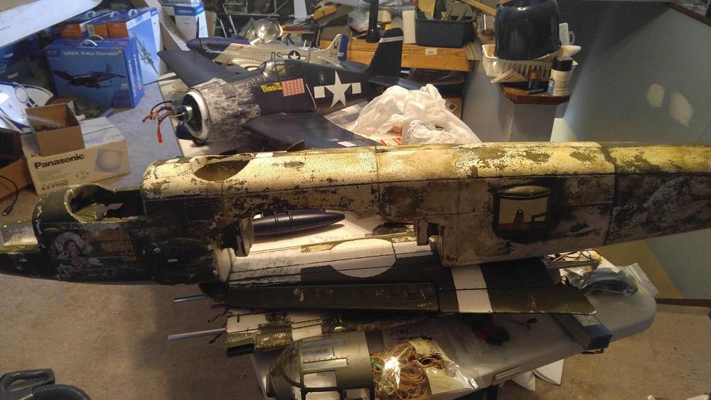

            • One more, look how it was bent to the Rt. Click image for larger version
              AMA 424553
              • Greetings all,
                Just had a quick look at my esc connections as well and they were separated by about 3/16". Put them back together tight and used some Blenderm tape around the joints then velcroed down the esc with a small patch about 1 inch square.

                  • If my crash can save even one other Spitfire than she didn't die in vain. Please, everyone, double check and secure your ESC to motor connection before your next flight. I have a strong feeling that was the cause of my crash.

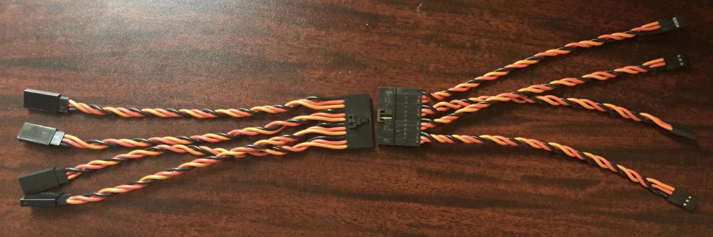

                                  • Hey guys I just picked up a neat product to allow me to transport my plane with the wings off. Currently I am cramming my Spitfire into the back of my SUV. While the plane fits in there is much room for other planes. While I have now issue taking the wing off there isn't much length on the wires to the wings. I have watched a few other guys with big Trojans, P38's and Warthogs use a four into one connector I thought I would pick one up. I was worried about the contacts but this product is made well and I have witnessed it in use at my local club for a few years. Anyway I am just passing this one to fellow enthusiasts.
                                    Enjoy,
                                    Jeff
                                    • You didn't mention whose product it is :Confused:
                                        They are by Electro Dynamics. I use several on my big birds. They are really good. You can get different sizes here.....
