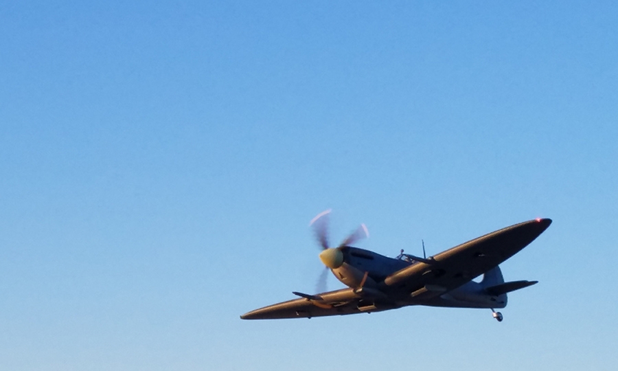

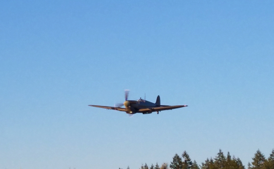

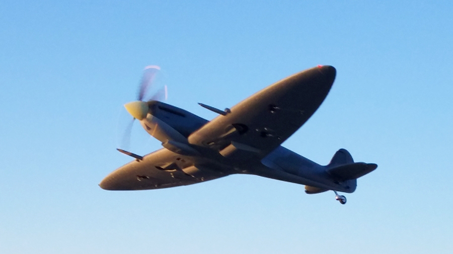

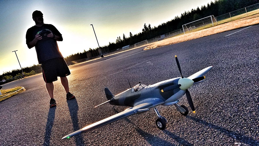

                                Just got back from a successful maiden. My old buddy I used to fly with was there maidening his Avanti. Happy to say both of us brought our planes home in the same condition we brought them in. :Cool:
                                Flew great, very scale, needed little trim. Not a speedster by any stretch but perfect for those scale, graceful flights. Beautiful profile, especially at dusk. My buddy took a few shots with his cell phone below. Now it's time to mask her up for the invasion stripes. Anyone else having trouble with the cockpit mirror staying put? I sense some epoxy in its near future. I did have a little trouble trying to get the backplate on to the hexagon shaft head but a little sandpaper and it went on fine. No issues with the threads and nut, thankfully.
                                My first Spitfire and it was worth the wait! Looking forward to the next flight!

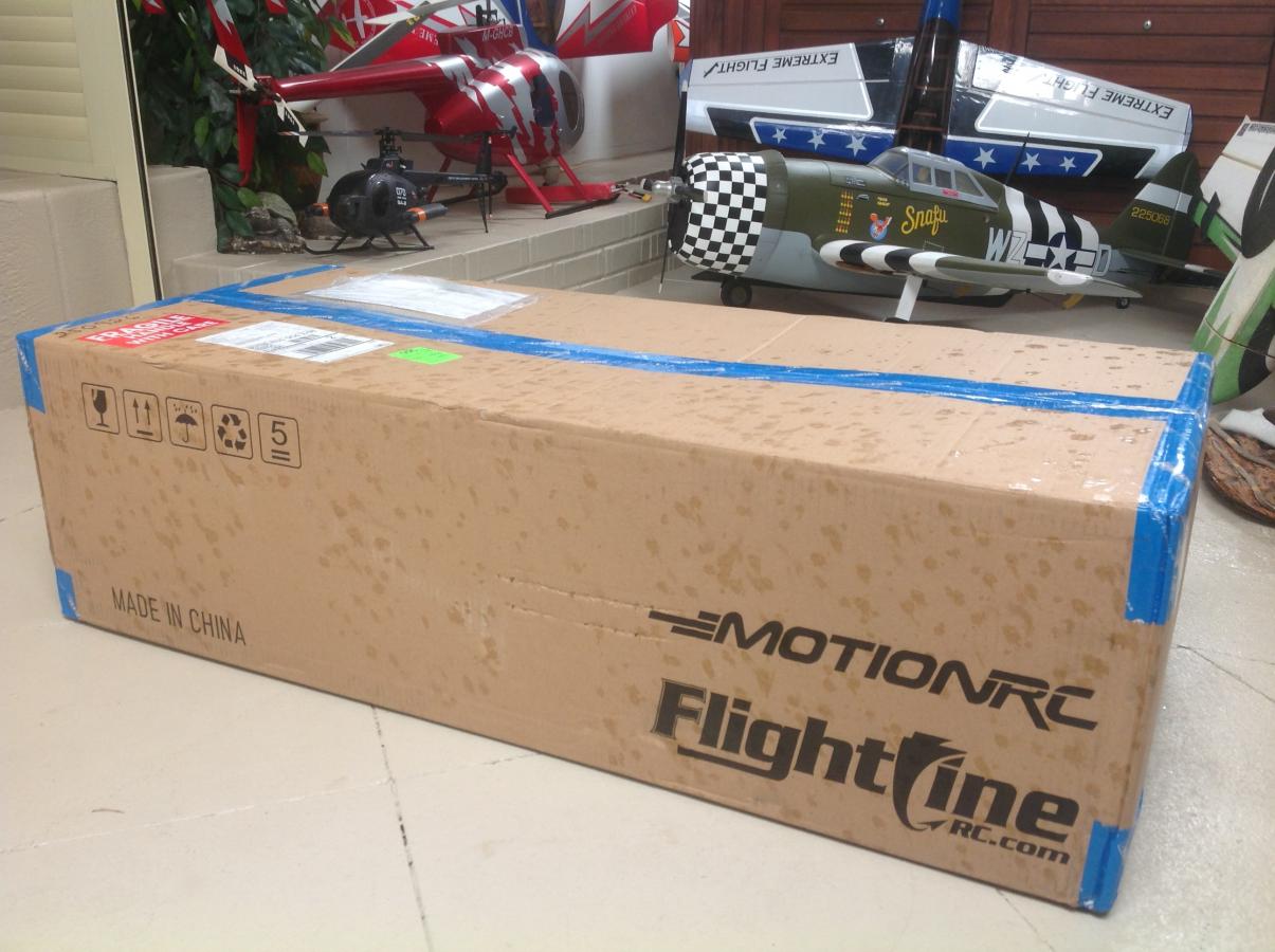

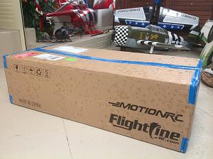

                                        In other news.... MINES HERE! Woohoo! And wasn't supposed to arrive till next week according to the tracker. Got a little wet just then off the truck (it's still bloody raining cats n dogs here), but considering its epic trip the box is in pretty good shape. (As usual). Was wondering if I get a free motion cap or something as the world record holder for most kilometres from factory to customer? Just sayin... :)
                                        Click image for larger version  Name:	IMG_1324.JPG Views:	1 Size:	120.1 KB ID:	89806
