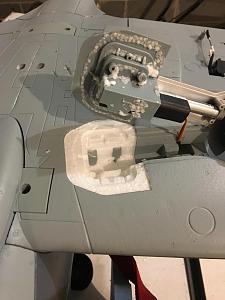

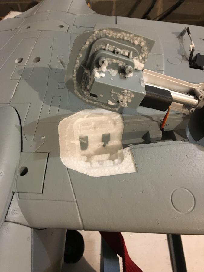

    Been out flying all day (but unfortunately, not my Spitty). My gear pull-out looks almost identical to Aros'. I've used Gorilla Glue in the past for plastic-to-foam repairs (I like Foam Tac for foam-to-foam).
    One note of caution when gluing the gear box back into the gear well- remove the motor/trunion before gluing the plastic housing back in place. On my F-86, I was making this repair and left the trunion in the plastic housing. Some glue then seeped in between the plastic housing and the motor/trunion box, bonding it to the plastic. When I later needed to remove the motor/trunion box, it wouldn't budge after I'd removed the fasteners. I finally had to drizzle some acetone onto the trunion housing, to soften up the glue enough to pry the trunion box free. Doh!

      Well Oxotnik, I was a casualty of that. I went to cycle my gear and the one I epoxied was glued open and would not cycle. DOH!!! :Loser:
      So I spent the flight with the gear down/dirty to practice more landings. Not looking forward to trying to get it working again after my epoxy douche job. :Dizzy:

            Aros, I think that you're in for trouble since you used epoxy. One another gear rebond, I had some GG expand into the motor/trunion box. It got into the gears. I had to pull the guts out and pick all of the glue out of the gear teeth. Once that had been completed, the motor/gears worked just fine. I'm afraid that with the epoxy, you may into a new motor/trunion unit. :Confused:

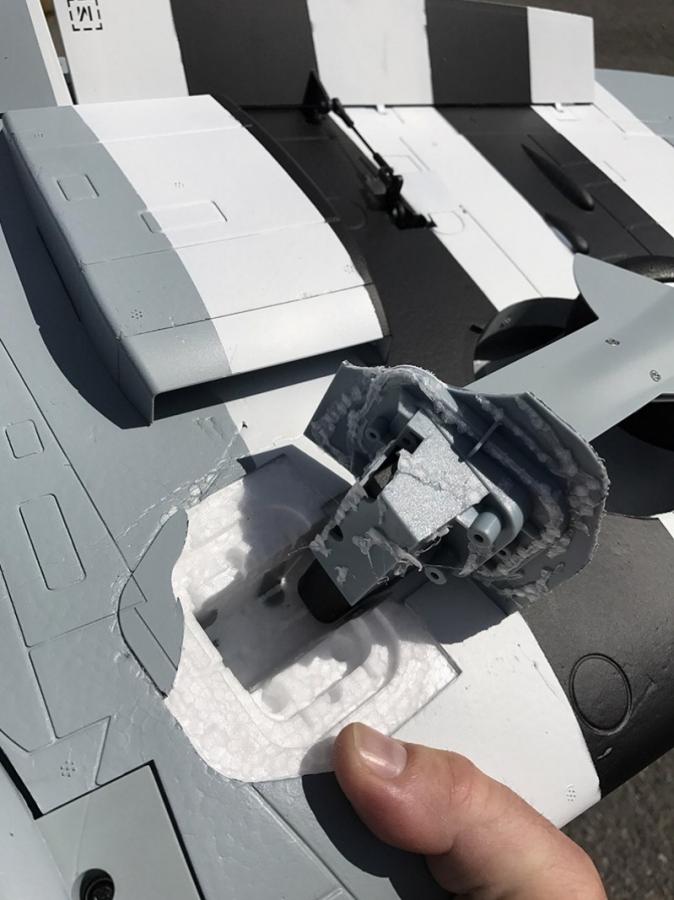

              Every foamy that I've bought has had a crappy bond of plastic to foam. Every gear box has pulled out of the gear well, often on easy landings even, such as what Aros had described. On my Spitty, I'd set it down a little hard, but it shouldn't have been hard enough to knock the gear out. On my F-86, second landing (and it was a good landing on a grass field), and the gear pulled out.
                I think you're absolutely right. Should have listened to the advice on the Foam-Tac. Sigh.

                        If your a gambler.....place your bet on the NO. Every manufacturer including FL has had issues with inadequate glue usage on the e-tract plastic pockets.
                        There are individuals doing the glue, not robotics applications so the quantity/spread consistency of gluing is a variable from one operator to the next.
                        I learned over the years that continuous turf duty will eventually weaken that sappy/rubbery glue they use and a retract will pullout........some sooner :Scared:and some later :Thinking: and some maybe never. :Whew:
                        As a matter of principle anymore I inject the translucent white ( 1 hour cure) Gorilla down into the sides of these foam pockets at the plastic edges.
                        The Gorilla will seep into the nooks and crannies of the foam and voids left by crappy glue application and firm everything with no more issues.
                        Here's the dispenser I use:;)
                        https://www.amazon.com/QTY-100-Dispe...ispensing+tips
                        These dispensers slip neatly on the tip of the Gorilla nozzle. I make sure it stays put with a little wrap of 1" wide masking tape on the tip/needle joint.

                            Just got back from a flight cut short from one of the retract housings popping out on landing. Was a nice greaser, roll out looked fine and then suddenly it tipped on a wing. Something to look out for. I am going to epoxy the housing to make sure that doesn't happen again.
