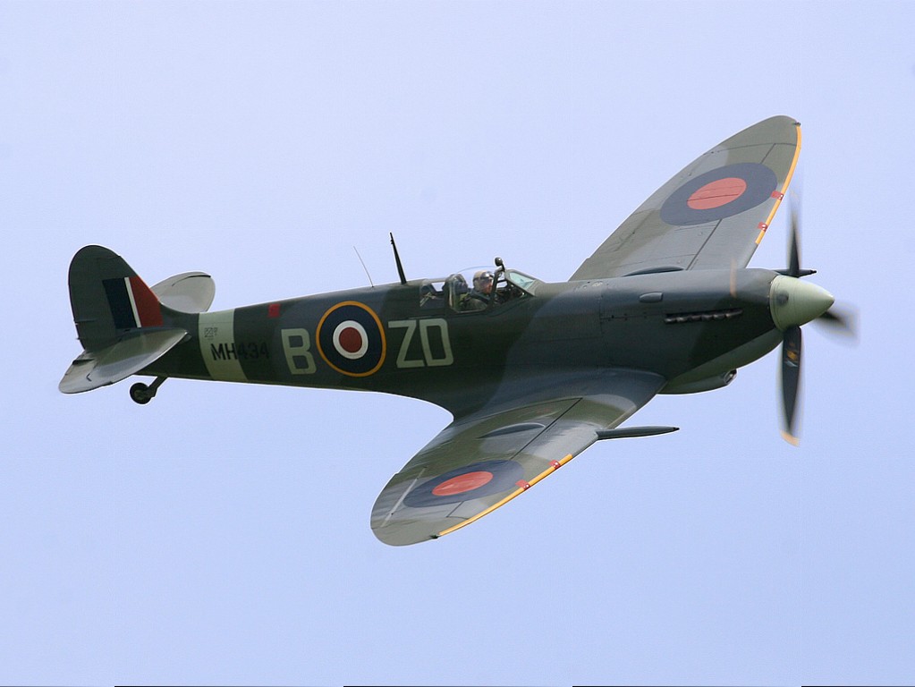

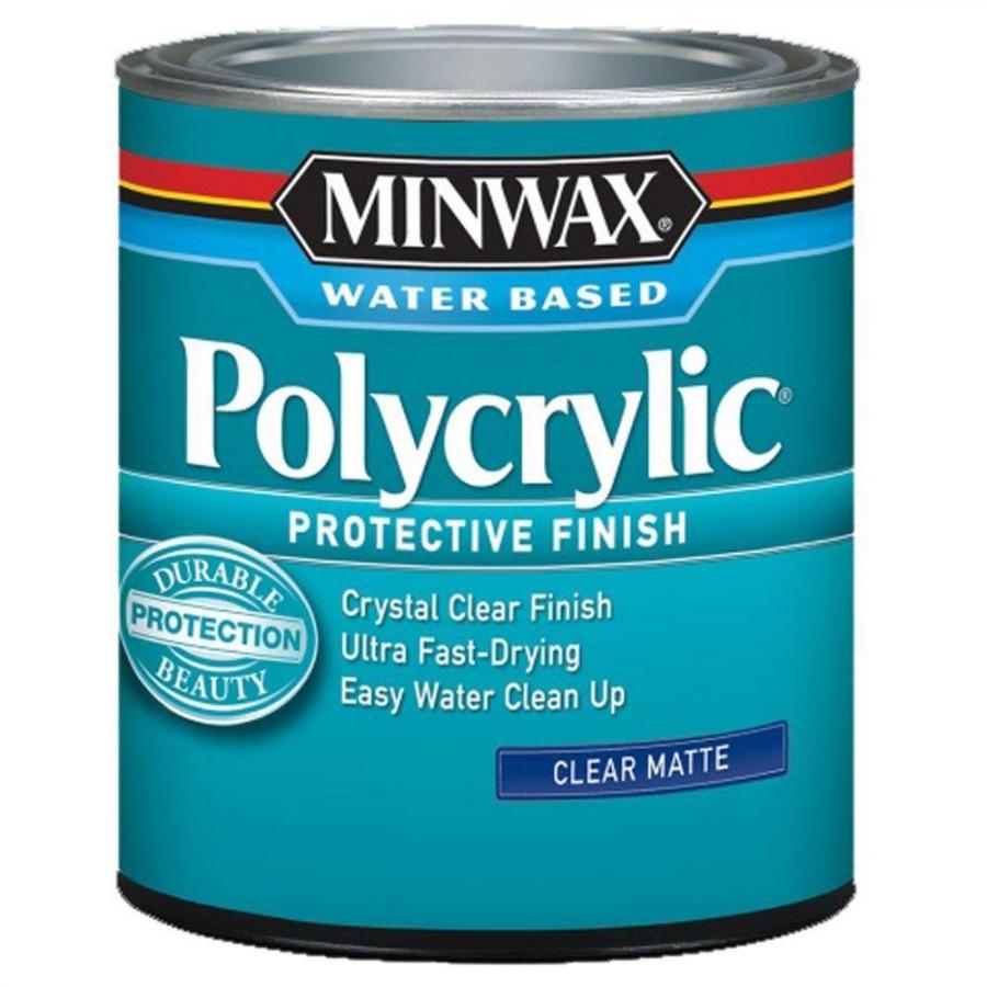

                              Hey all, i'm thinking about making the finish of the plane have more of a slight shine to it, like this spitfire instead of dull foam. The product i'm thinking of using is Minwax Polycrylic waterbased clear Matte.
                              • Oxotnik
                                Actung, Spitfire!
                                • 931
                                • Huntsville, AL
                                #1135
                                I'd suggest the UV resistant Polycrylic
                                Warbirder
                                • radfordc
                                  • 375
                                  • Lansing, KS
                                  #1136
                                  I think I'm going to try this spray: https://www.hobbysquawk.com/forum/rc...-acrylic-spray
