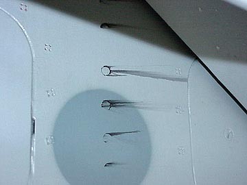

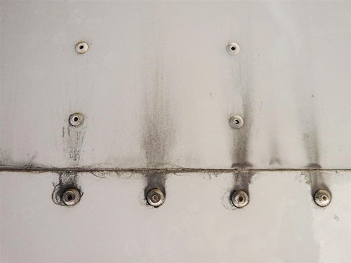

  • Aircraft that go to sea on a carrier live a terrible life compaired to their land based counterparts. Regular 14 day wash jobs are out due to the lack of fresh water, spray cans of Turco are used instead to clean the surfaces. The stress of carrier landings takes a toll on the airframe causing rivets to loosen the length of the fuselage between the wing and tail. Salt water gets into those voids and causes bleeding rivets as we called them. Repairs that need to be made are painted over in the patches and spots they cover. Flying schedules routinely cause a very crunched amount of down time to cover inspections and repair. It’s all a vicious cycle that is destroying the airframe at a rapid pace. I believe all Spitfires had magnesium rivets shot into aluminum skin and this would have caused Seafires to really bleed from dissimilar metal corrosion due to salt water contact. In my 48 month Navy tenure, I spent 23 months of that at sea in an A-6 Squadron just to show you the the amount of time those airframes were also at sea getting their tails flown off. After an 8 month cruise they just looked awful, like old spotted leopards as one CO put it...
    Looking at the attachments one would think oil had leaked out of these rivets and while it will, it’s actually the rivets suffering from corrosion and the bleeding that takes place once they loosen and have a void created.
    Any high stress area of the airframe will exhibit this pattern of degradation on a carrier aircraft. Also, Navy aircraft are not permitted to have chipping and worn off paint like their land based versions, as bare aluminum will suffer direct surface attack from salt spray. It’s a corrosion control measure that results in spotty repairs at sea.

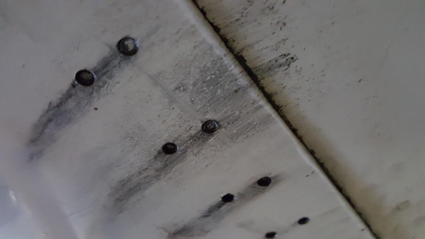

    • Access panels were also damaged on a fairly regular basis due to the windy conditions on deck. Corner repairs were common place with the affected area being touched up with fresh paint. Panels that required daily removal were always subject to the most damage.

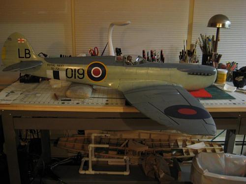

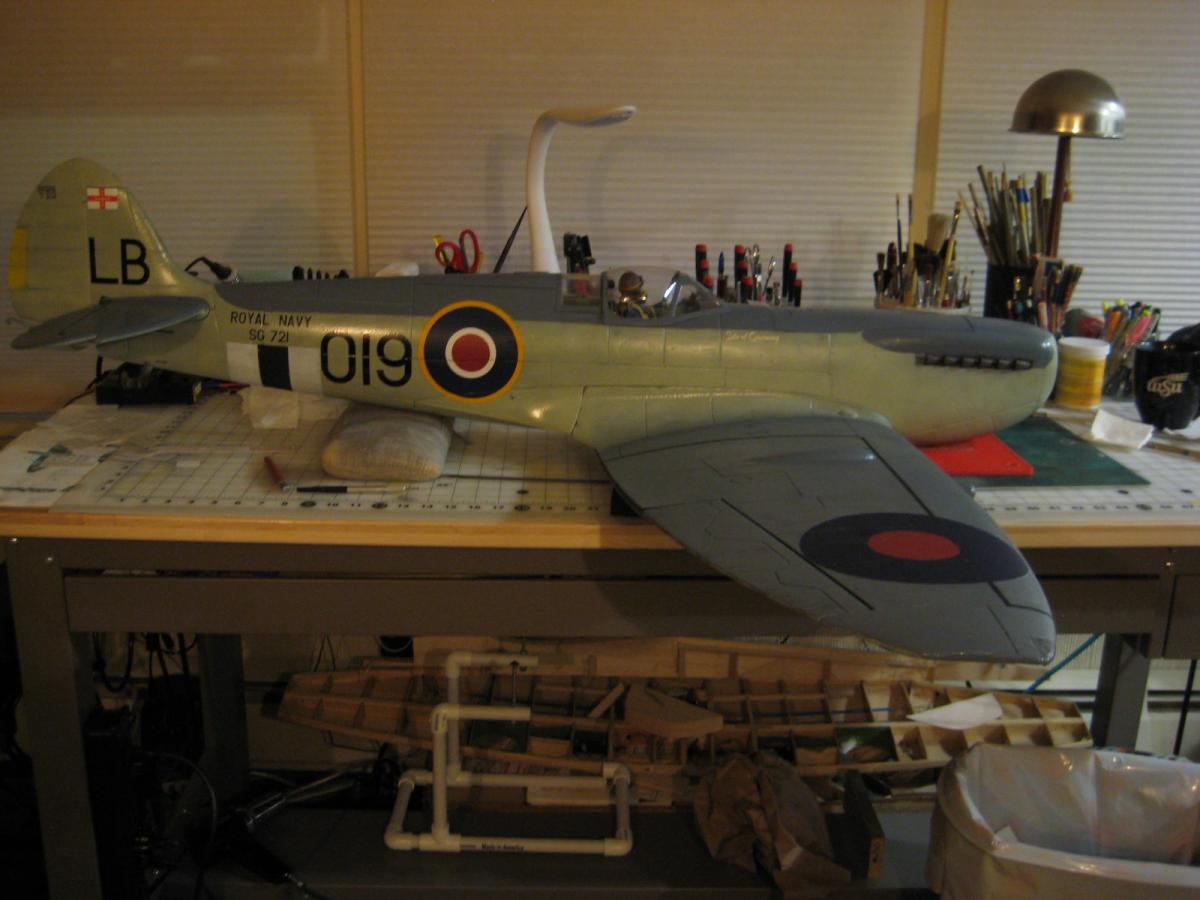

                • Hey Ya'll, I was hoping to get more done today, though 'she who's authority exceeds my rank' says we're going shopping. So we went. I got gum, she got outdoor Christmas stuff that requires my assistance to install. As it should be, I suppose. Anyway, almost all the markings on the port side plus the Invasion Stripes today. Looking forward to weathering next. Best, LB

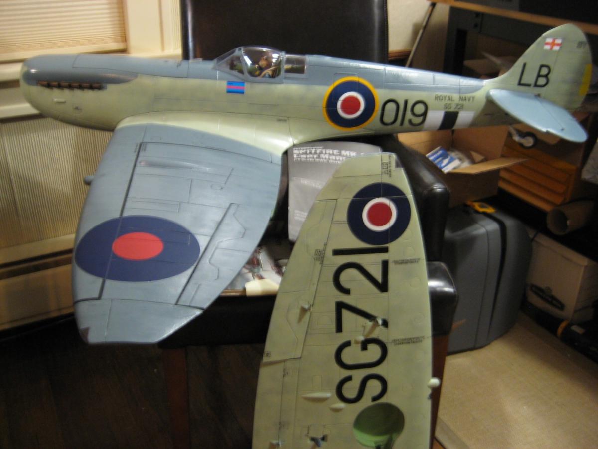

                      • LOL You Guys are Cracking Me Up...Starboard getting closer. Oh and I've been researching "dirt, oil, and grime" pictures on these beauties and one could spend a month making it dirty. Next, after the rest of the Callie Graphics is another clear coat and then the dirt begins. Best, LB

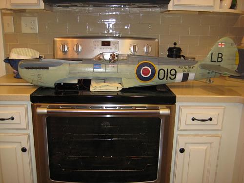

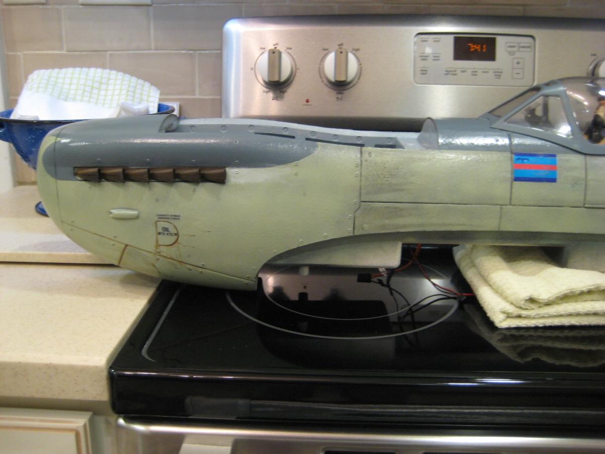

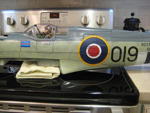

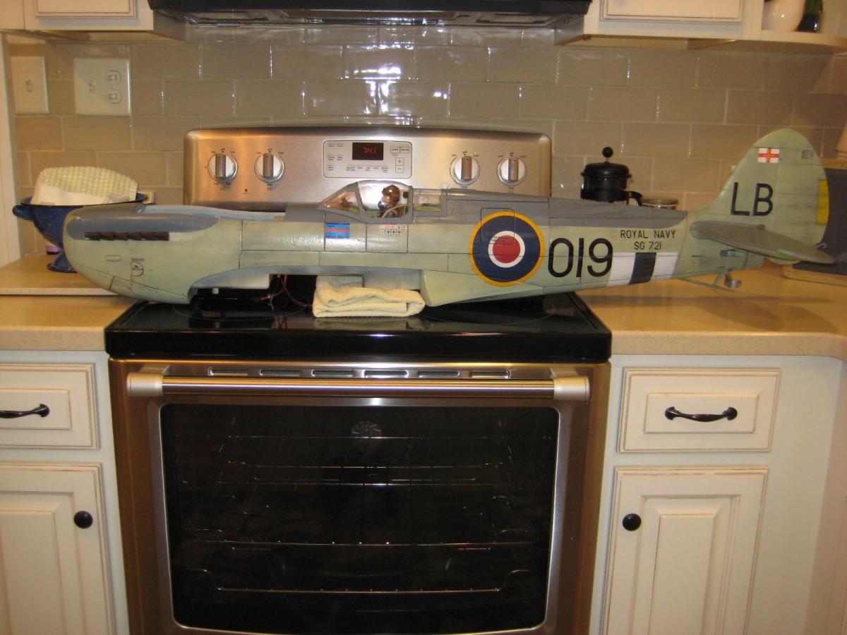

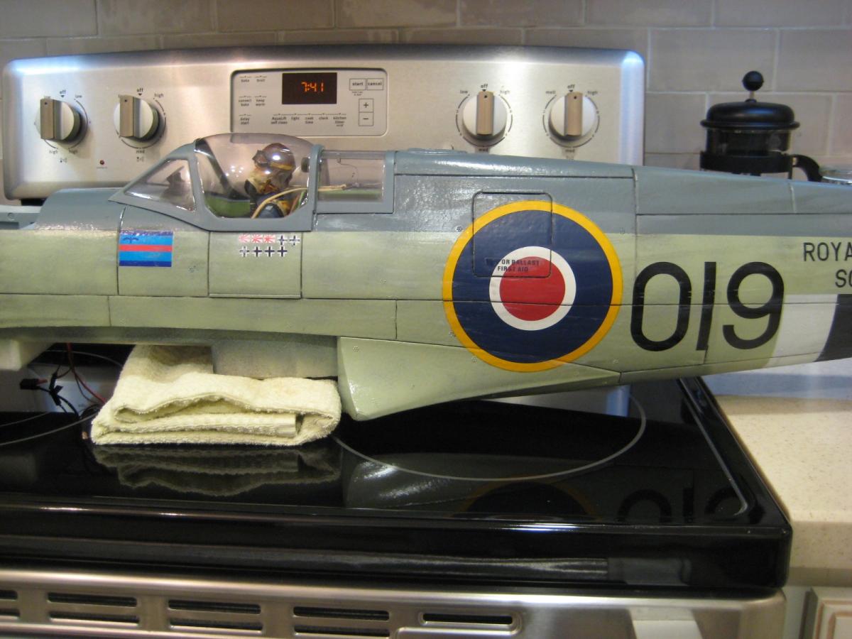

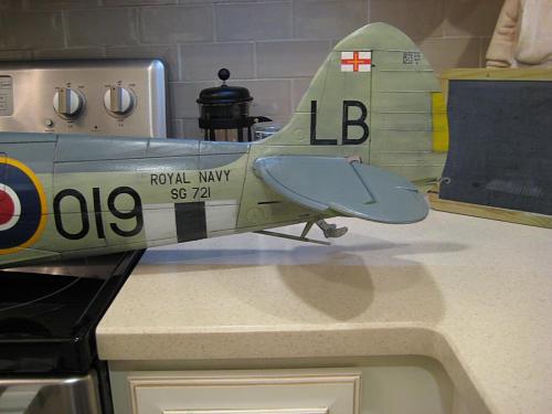

                            • Ya'll, Just a quick post since Tammes let me borrow the kitchen lighting and her stovetop to shoot a couple pix. My weathering was slow going at first, though it goes more quickly when one throws caution to the wind. I AM using the oil pastels with mineral spirits. Very forgiving, I must say. If you overdo it, just dampen a p-towel, wipe, and start over. Thank you, Minwax. Port side pretty much finished until I add the wing and begin blending the fillet. Happy and Blessed Thanksgiving to all. LB

                              • You do realize that the stove should be in the OFF position when doing photo shoots.... IF not, then the pastels won't be needed, but the smoke streaks will be vertical instead of along the slip stream...…
                                • Lol its off brother.
                                  • HA!!!! I was joking, of course... But after looking at the pics again, it is very obviously OFF... All four (4) burners..... OR heating elements, or what the hell ever they are called now!!! HA!!! Happy Thanksgiving!!! Off...… ;)
                                    • Lol! Absolutely and to you as well, good humor is hard to come by these days, glad there's folks here that have it :)
