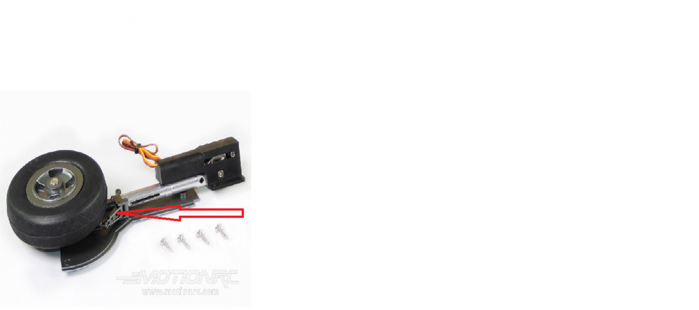

                                    So after 35 successful flights I had a bit of a rough landing with a cross wind. While my damage was only cosmetic. I am a little annoyed that I can't find this simple part by itself. I am sure other fliers might break this part too.
                                    Does anyone know of a replacement for the plastic cosmetic linkage on the landing gear. Please see in the picture with the red arrow. I don't want to spent $35.00 to by a complete assembly just to get this one tiny plastic part.
                                    Thanks
                                    Jeff

                                      Hi CDN_Iceman, sorry to hear about that issue. Unfortunately, that small part isn't available as a separately purchasable spare part; frankly this is the first I've seen it requested in the world. I suppose there are two feasible options, neither super easy but both at least possible.
                                      The first option would be free from us, which is always nice :) I could send you an .STL file of that linkage for you to 3D print yourself or have 3Dprinted locally. It's a small plastic cosmetic non-load-bearing part, which is an ideal candidate for 3DP. I'd be happy to convert and send the necessary file to you. I did the same process for Stuart the other week when he lost his Spitfire's stock plastic cannon. Quick and easy!
                                      The second option doesn't require a printer, but would require patience: You could contact our tech support team at www.motionrc.com/support and ask them to enter this part in their New Parts Request form. From there, the request would be sent to the factory and they'd take the necessary time to evaluate, issue a new part number and price, advise a production time, then we'd order it (and a bunch of others since we can't order just one of something on a mass production line), then they'd ship it to us, whereafter we'd be able to sell it and ship it to you.
                                      Fingers crossed you have access to a 3D printer... otherwise, contact the tech support guys and they'll do their best to get your request into the process.

                                        #1979
                                        WOW Thanks for the quick reply Alpha. I can certainly print the part if I can get the .STL file. While the plane is functional. I will be able to fly at my clubs electric event tomorrow. I like to have my planes looking great. Thank you once more.
                                        Jeff
