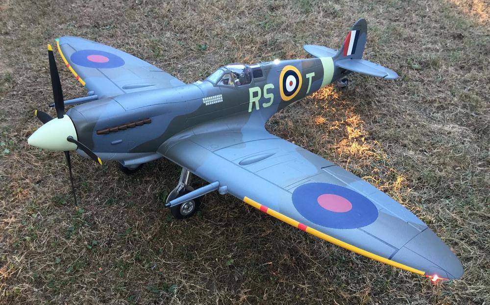

    The 1600mm Spitfire is 1/7 scale. Lots of great livery’s at Callie Graphics for sure!

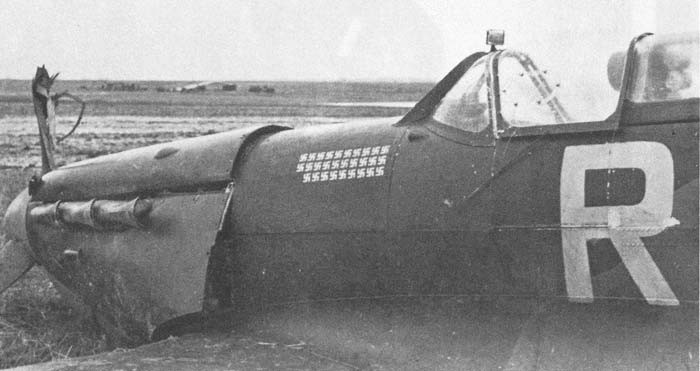

    Flew my Robert Stanford Tuck RST three times today. Always a favorite at the field

    Brought down by ground fire 28 January 1942 ... POW

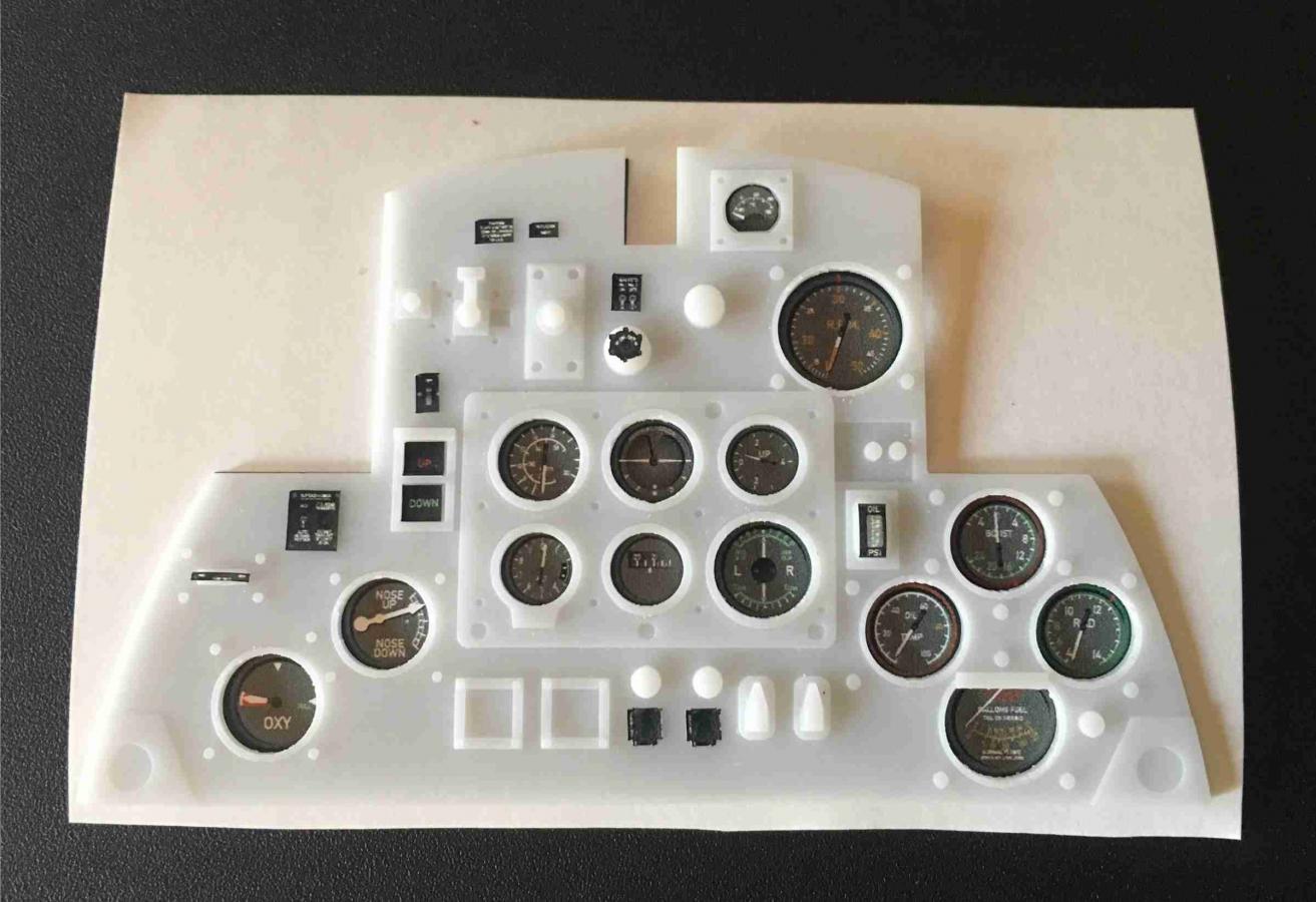

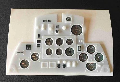

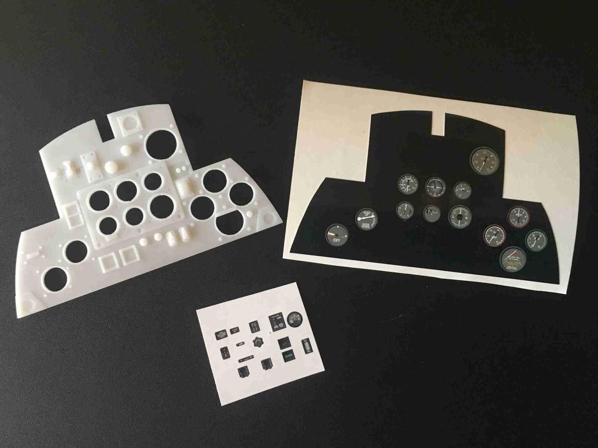

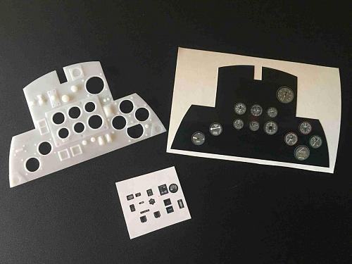

                            A customer just sent me a panel so I could create gauge graphics! Here is a link:
ID:	146733Click image for larger version

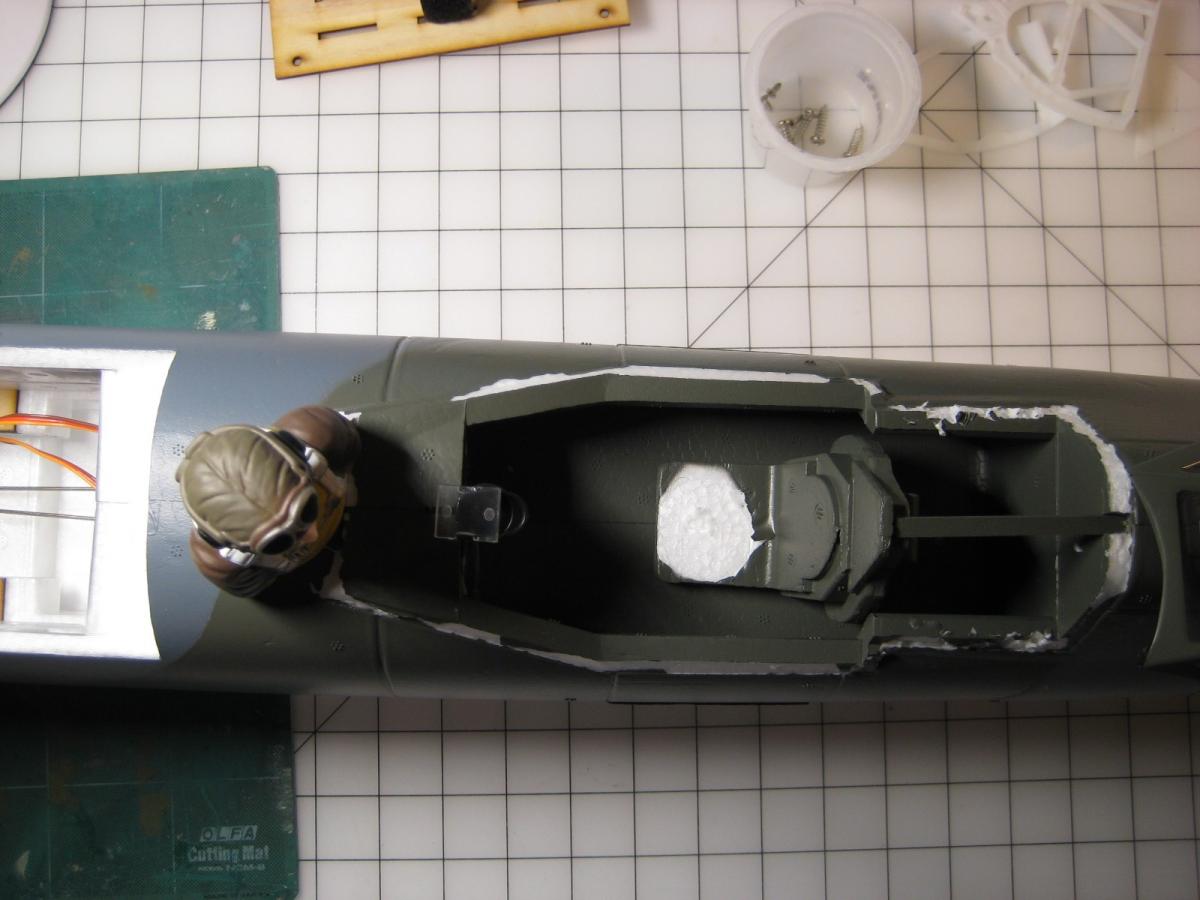

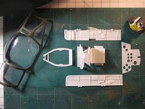

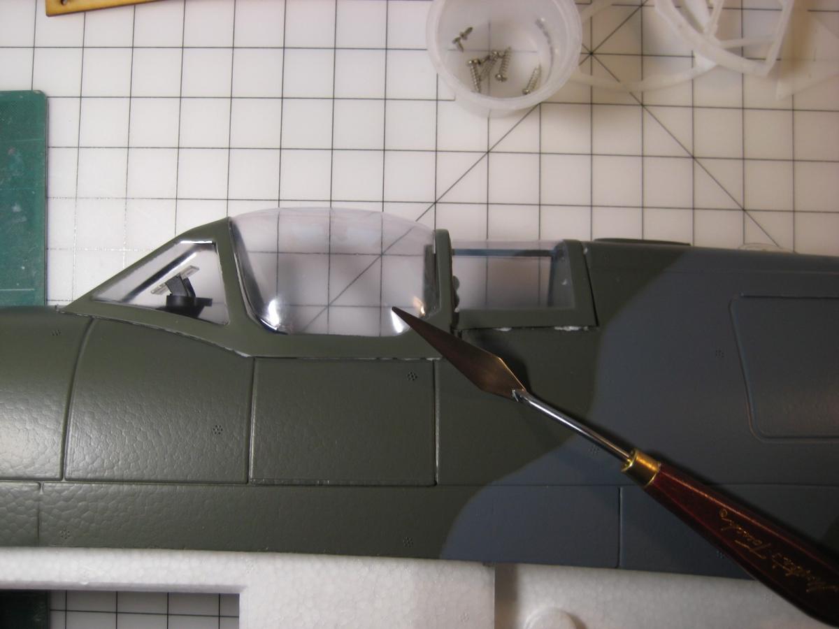

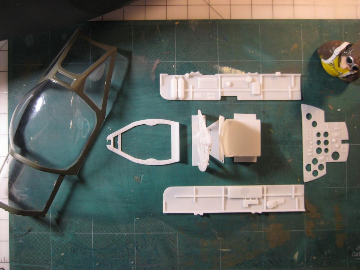

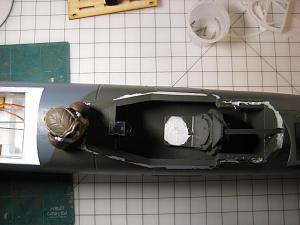

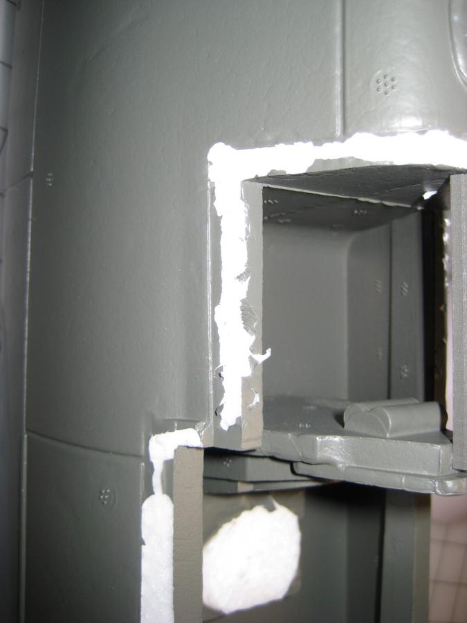

                                  Hey Y'all, I just started the cockpit mod using the Motion RC 3DP parts. There isn't a dash cover so I'll make one to avoid the 'gatoring' under the windscreen. Used an artist paint spatula to ease the canopy off by starting on the lower sides of the 'turtledeck' but as you can see the Flightline glue is formidable; easy fix. The Brit pilot was reluctant to give up his career, but so it goes. No screws just 'yank' 'im out as he is glued to a foam pedestal and is easily removed. The pilot seat and fuse former will need to be surgically removed as well. Save the longeron bit (Balsa or eq I think) or simply make one from something similar. My cockpit kit had an issue with a twist warp on the large bulkhead but figure I can correct that with a little heat. There is plenty of room to add more details for those with the inclination. I will post pics again when there is some progress. No instructions required really, just the guts to remove the canopy; after that, it's self-explanatory by the fit, i.e., rounded edge of cockpit sides go to the rear. If you did not know, Callie Graphics has a photo instrument dial sheet for $4USD. I ordered one and it just hasn't arrived yet. Best, LB
                                  Click image for larger version  Name:	IMG_0002.JPG Views:	1 Size:	76.8 KB ID:	147262Click image for larger version  Name:	IMG_0004.JPG Views:	1 Size:	88.4 KB ID:	147263Click image for larger version  Name:	IMG_0008.JPG Views:	1 Size:	43.1 KB ID:	147264Click image for larger version  Name:	IMG_0010.JPG Views:	1 Size:	97.5 KB ID:	147265

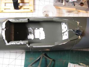

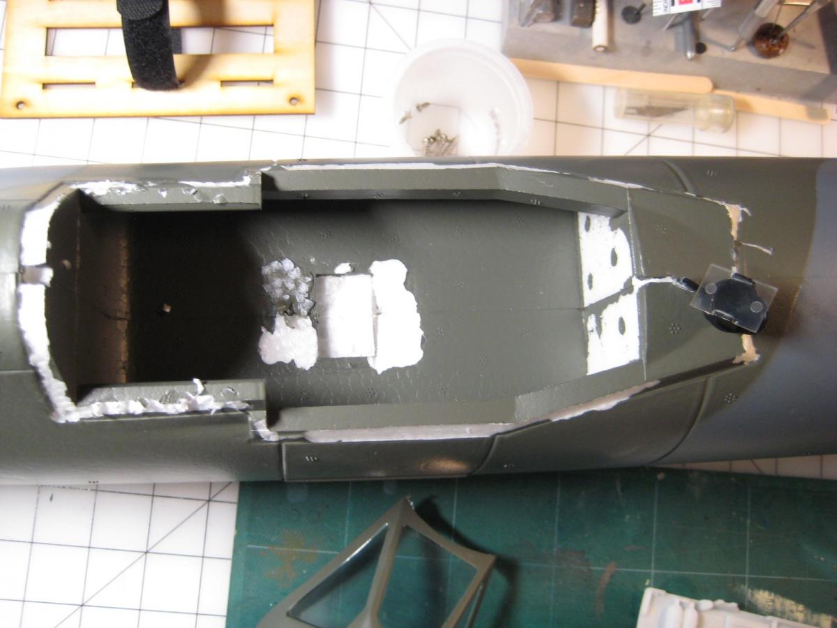

                                    Quick PostScript--the seat and gun sight pulled out easily as these are simply glued in place. No damage, no Xacto. lol
