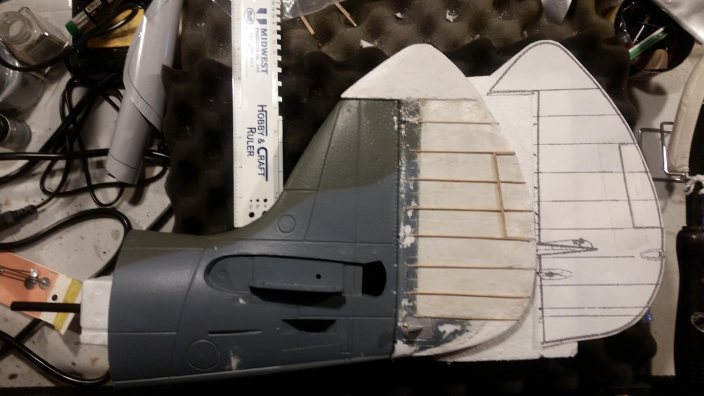

                                          The proposed 3D printed Instrument panel maybe somewhat less than scale and may not fit my old warbird...?
                                          And, may I suggest that you up-size this Spitfire design one more time to a 2000+mm wingspan...
