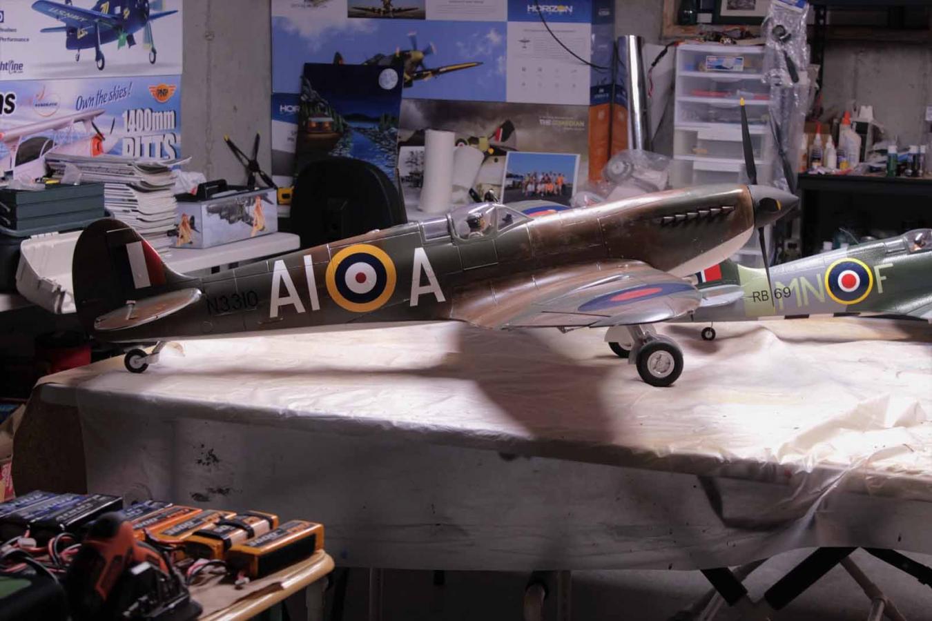

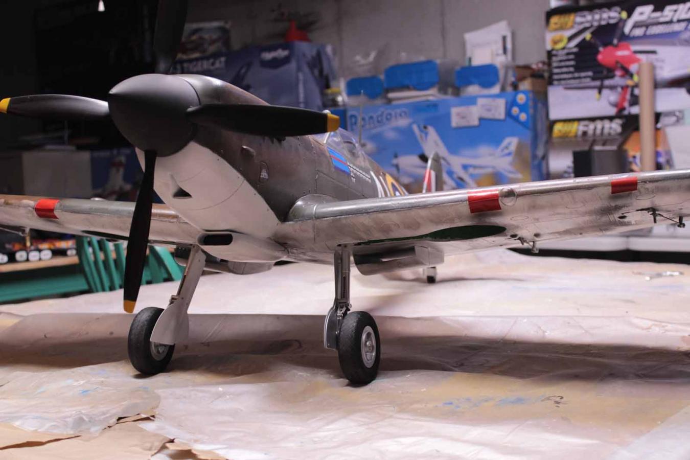

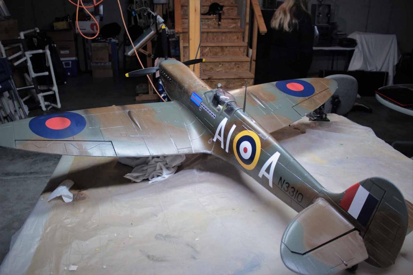

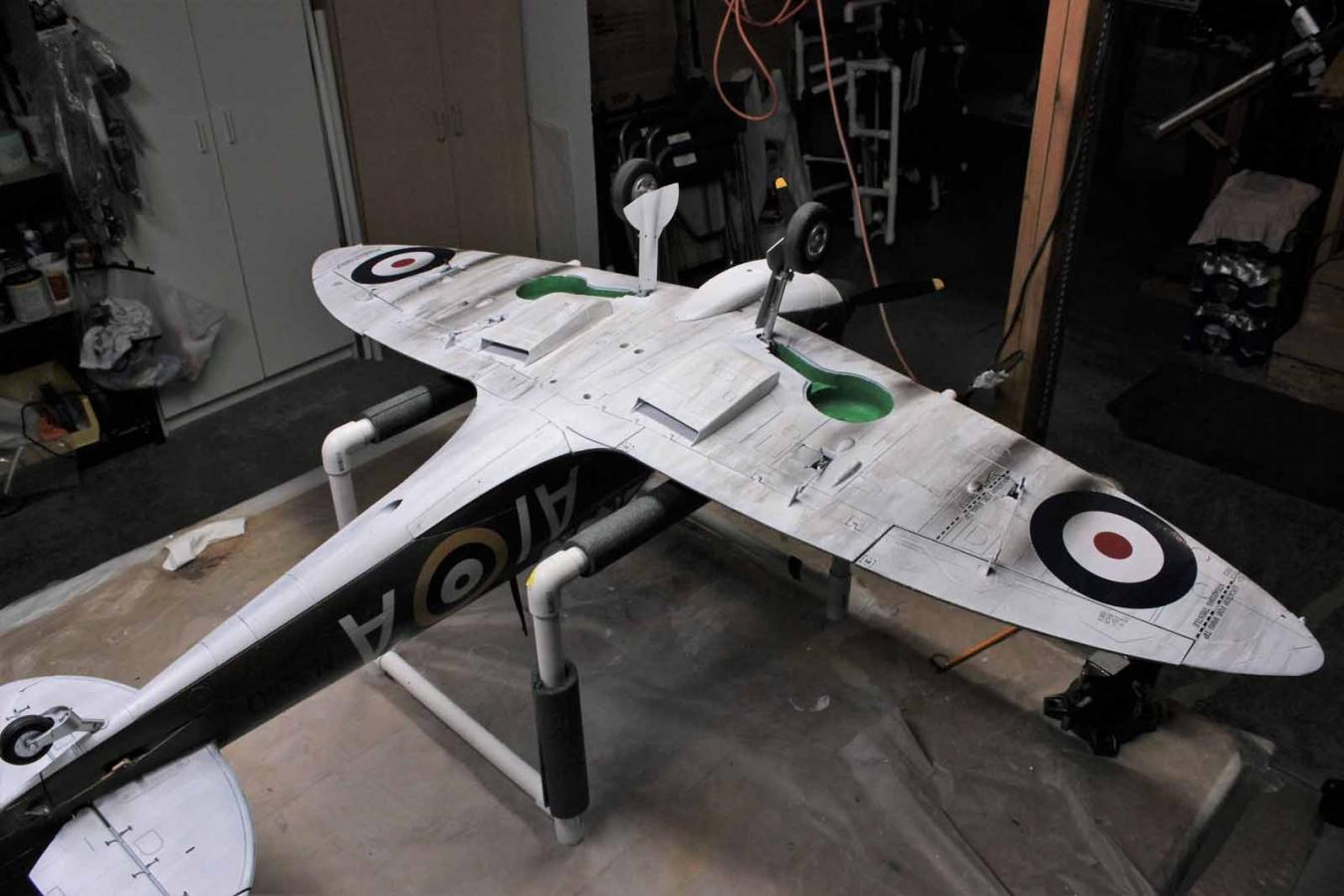

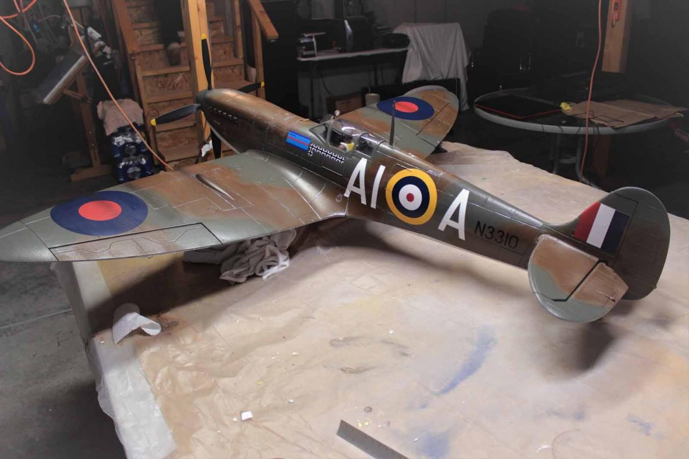

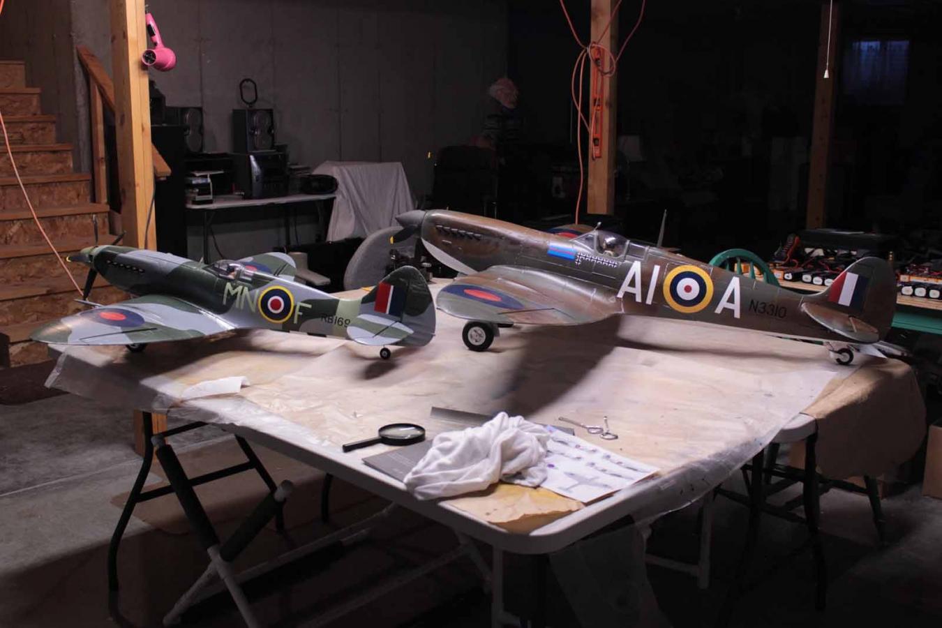

                                Ok guys, the final paint work done and decals installed today. I coated it with Minwax satin to seal the decals on and it turned the colors darker, so to use it as an advantage, I scumbled the paint on, leaving some areas flat and covering some to give it a worn look (distressed) The 'dirt' on the undersides was a very thinned out mix of black and nutmeg, applied with a bit of papertowel and dragged front to back. Keep in mind that these planes were flying from grass strips and it wasn't a particularly great Summer contrary to popular belief, hence the dirty undersides. I'll let her sit for a while and see what I think...
