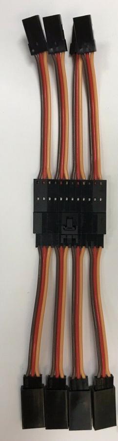

            I just ordered a set of the Multi Servo Connectors for my Spitfire. I have them on My Carbon Z T-28 and they work great. Just one plug for each wing and you are ready to go!!

              Wow, those are outstanding, where did you order them from? I'm just finishing making the Hansen Hobbies polarized latching connections to accomplish the same thing and getting rid of the blue box, but I'm having to actually make the connectors; lots of cutting wires, soldering and crimping the female/male leads. :triumph:

                I saw those at the field. I don't like the length of the connector, balancing the wing on the plane and my hand and having the connector plug a skew. but the biggest problem is the contacts are Nickle plated.

                  I don't know who makes the ones shown but there is a site Electro dynamics .com that carrys them and the contacts are brass.

                    OK, just finished rewiring the control surfaces on the wings, removing the blue box. Flew it earlier this week and had some electrical glitches on the control surfaces, so when I got it home, I noticed that 2 of the negative power leads into the blue box were loose, coming out. :poop: At that point, I decided to rewire the whole thing cause I got tired of plugging 4 connections into the blue box putting the wings together and connecting 4 servo connections to the fuselage leads going into the receiver every time I took it out. It was such a "pain in the lower drain" and no doubt caused loosening of the wires every time I yanked them out. :triumph:
                    I did the same thing with my Stinger 90, using Hansen Hobbies 5 pin Latching Polarized Housings and Gold Terminals. No doubt it was a pain stripping so many wires, soldering leads on and connecting the terminals, but once finished, it was well worth it. :hugging: I now have only one 5 pin latching connection to hook up when installing the wing to the fuselage. I also made a separate connection for the lights, but that's another story. Like the true idiot that I am, I forgot that the blue box must have had a voltage reducer in it for the lights, and of course this Einstein :face_with_monocle: just hooked them up without a light controller. Needless to say, they were incredibly bright for a few seconds and then burned out. :sob: So now I'm left with only 1 connection to make for all 6 wing servo's, but no lights (something nice to have but gone for now). I left the wires as short as possible to keep from having to pack a bird's nest away, but it still long enough to make an easy connection. I may purchase a light controller and new LED lights sometime, but for now they're staying dark.
                      They're all made of brass, some that are nickle plated and those that are gold plated.

                        hugh that looks much more reliable! all those + and - leads down to 1, there's some entertainment!
                        boomer they have to plate the brass with nickel to get best adherence for the gold. so they had to hand pick the leads that only get nickel plate which costs almost as much as gold plating them. i just don't understand sometimes?
                        i have a 25+ year old cub that has one aileron servo with nickel contacts that just does not work when everything is hooked up. i have to pull the servo and unplug and plug the connector 3-4 times and it comes to life because the nickel tarnishes over time. its a cub so it never gets maintenance time but when it does that' connector is the first thing to go.
                                Here is the link for those guys interested in this style of connections

                                          http://www.electrodynam.com/store/102.shtml
                                          Chief Aircraft also sells a similar multi connector product: http://www.chiefaircraft.com/tb-msh12-3.html
                                          I've been using the Chief Aircraft multi servo connectors, not on my Fightline Spit because I take the wing off for transportation. I do use on my 91" A-26 though.
