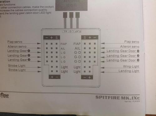

                            Rightio, one more question.... I hope. Gman you'll prob know mate considering the vid above. Which ports in the board is the gear SUPPOSED to go in??? Like your vid, I'm getting seperate travel - but much worse. One retract goes, wait 5-6 seconds, then the other. I don't mind a small split, but it's too much and won't make for good flying with just one gear down while I wait for the other. I'm happy with a small gap, or simultaneously. And it's not like the manual is clear on which port to put em in.... are they both supposed to go in the left side? :Confused:
                            Click image for larger version  Name:	IMG_1822.JPG Views:	1 Size:	72.5 KB ID:	128191
                              • 7418
                              #1754
                              I think both go in the left side, but I put one in the right side and one in the left so it has that scale look to it.
                              The lights can be easily mixed up too, ask me how I know:Silly:
                                #1755
                                Shirty..........FL used the same integrated circuit module connection board on the Spitty as they used on the P-38.
                                It's not rocket science mate.;) Hook em up as labeled. The retracts hook to the L-G (left side). Since you don't have gear doors(right side), no worries.....leave blank.
                                The gear door side is the FL version of the FMS independent 6 sec delay circuit card.
                                That's how Gman got the delay(way over delay) between the two gears by plugging one in the gear the other in the door:Scared: Don't see how he confused the lights :Thinking:
                                You now have it in a nut shell :Whew:

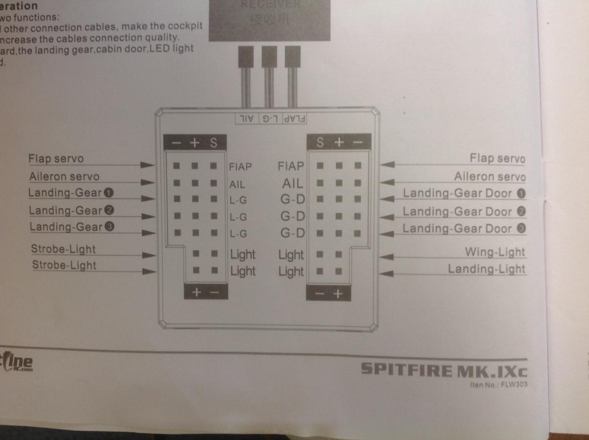

                                    couple of posts on rcgroups bout the blue box, is the consensus bypass it for the flight controls? I've never had an issue with any flightline or freewing plane in this regard.
                                    Click image for larger version  Name:	IMG_1840.JPG Views:	1 Size:	101.2 KB ID:	128342
                                      #1758
                                      I've never had any issue with the FL/FW control boxes, the majority are passive and act just as a centralized connection point. ;)
