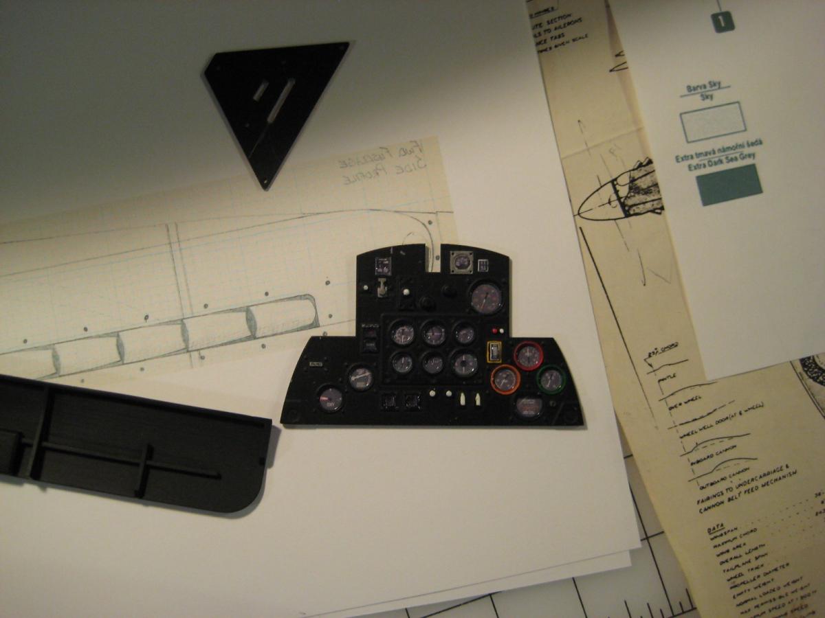

                          it must be just me but, how do you guys install the callie graphics decal to the dash? if I start to peel it off the sticky part is on the back ? thx
                            • 4839
                            #1953
                            Originally posted by axerhand1976
                            it must be just me but, how do you guys install the Callie graphics decal to the dash? if I start to peel it off the sticky part is on the back ? thx
                            Axe, Not certain I understand, but the Callie Graphics Instrument panel I received is a photo-print to be used with the MotionRC Cockpit kit. I simply glued it to the back of the instrument panel in that kit using clear SOBO glue that dries clear. You might have a different decal set than I. Best, LB
                            Click image for larger version  Name:	IMG_0005.JPG Views:	2 Size:	72.4 KB ID:	150638
                            • axerhand1976
                              • Mar 2014
                              • 89
                              #1954
                              thx , the one I got is a decal with a sticky backing, I guess I will try and glue it with ur suggested glue.
                                Axe, Do you have the MotionRC cockpit kit as well? If so, use the same glue to fill in the dials to simulate glass. This will also help keep the decal in place. Best, LB

                                    thx Elbee, I do have the cockpit kit from motion. I was going to use 30 min epoxy because it dries clear to but I will try the sobu glue since it is cheaper.
                                      • 4839
                                      #1958
                                      thx Elbee, I do have the cockpit kit from motion. I was going to use 30 min epoxy because it dries clear to but I will try the Axe, sobu glue since it is cheaper.
                                      Axe, you won't regret it. I use it for anything clear including domes on ordinance. It took three applications to fill the 3DP instrument panel void to the point it looked right. Works for lots of stuff; just takes a while to dry. Post pics as you progress. Best, LB

                                          #1960
                                          well crap, I had to use epoxy because in my crappy town no one sells sobo……..oh well. xd
