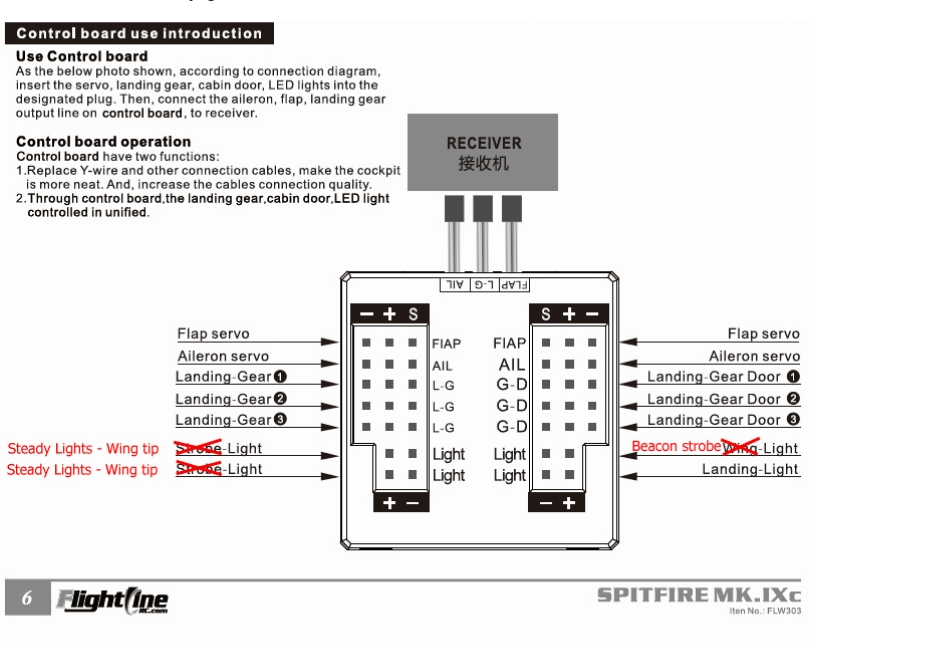

    I have one problem, however. I have about a 5 second delay when I activate the landing gear to when they actually start moving. I wired the LG into the Blue Box. Does this have anything to do with it? My radio is a DX9. I didn't see anything in there to cause this.
    Is this normal? What causes this?

      Check to make sure that the Landing Gear wires are plugged into the correct side of the blue box.
      The box is pretty generic and also includes gear doors for planes like the Mustang that have clam shell doors. If you plug them into these connections, there will be a delay. I did it with mine so that one gear retracted after the other for a more scale like retract/deploy, but it wasn't great during flight so switched it to normal. Here's the box....
      Click image for larger version  Name:	Capture.PNG Views:	1 Size:	274.3 KB ID:	149101
      Note, the landing gear plugs into the left side and the separate gear doors plug into the right side, also note that there is a third landing gear plug for a retractable tail/nose gear. Also note where the lights are SUPPOSED to plug in.
      That might be your problem, take a look.

        Thanks Grossman56! As soon as I saw this, I went to the garage to have a look. Bummer, it's hooked up correctly! Tomorrow or later tonight, I'll switch them to the LG Door slots, just to see if that's it. Or I'll by pass the blue box and see what happens.

        Update: I checked all the various ways to plug in the Landing Gear and with any combination, I still had the delay. I by-passed the Blue Box and the delay went away.
        I filled out a customer service ticket on line with Motion RC and they responded within 10 minutes telling me that they will ship out a new Blue Box right away! Thanks M.R.C.!

            Your blue box is working normally, I believe.
            It appears that the blue box is the same on the p38, f7f, and big Spitfire. It has a sequencer in it that will output to the gear door ports as soon as you hit "gear down" on the xmttr, and will output to the gear ports after a short delay. The only one of the 3 planes that needs this delay is the p38 since it has servo actuated gear doors. So on the p38 the delay allows the gear doors to open without racing with the gear; on the f7f and Spitfire, it simply results in a short delay in the gear dropping.

              So, if you want the gear to retract quicker, try plugging into the landing gear door plugs, here's a video of the difference in the times when I had mine set so that one would retract before the other.
              You can hear the click of the switch and notice that the gear plugged into the gear plug deploys last and retracts first.
