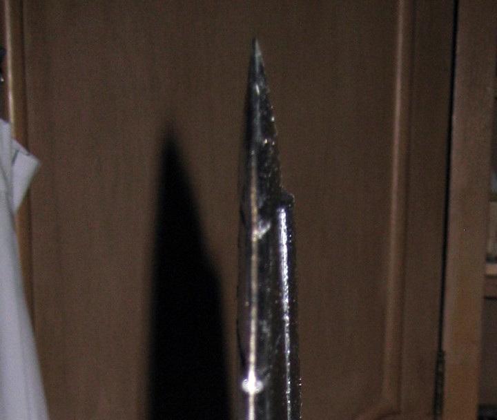

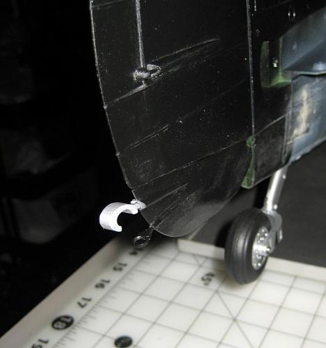

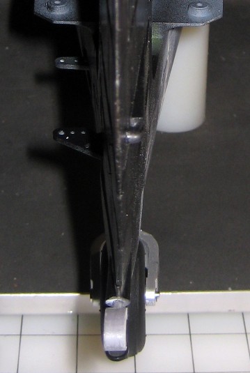

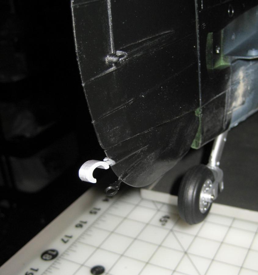

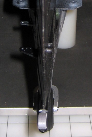

          Y'all, Just a quick look at some of the 3Dp parts installed. Extended rudder Trim Tab Control Arm, Arrestor Hook Assembly, Rudder LIght Fairing with Optional Warped Rudder Top,LOL and RudderTie-Down. Excuse the black primer with a dark background. Best, LB

          Isn't that the wrong hook for this Mark Seafire?

            radfordc, Why yes it is, thank you for noticing. LOLAt my skill level with 3DP CAD, it was the easiest to shape and it's a bit wide. :)I will sand it some to shape it before final paint and when I post the stl files I will revise it somewhat. Best, LB

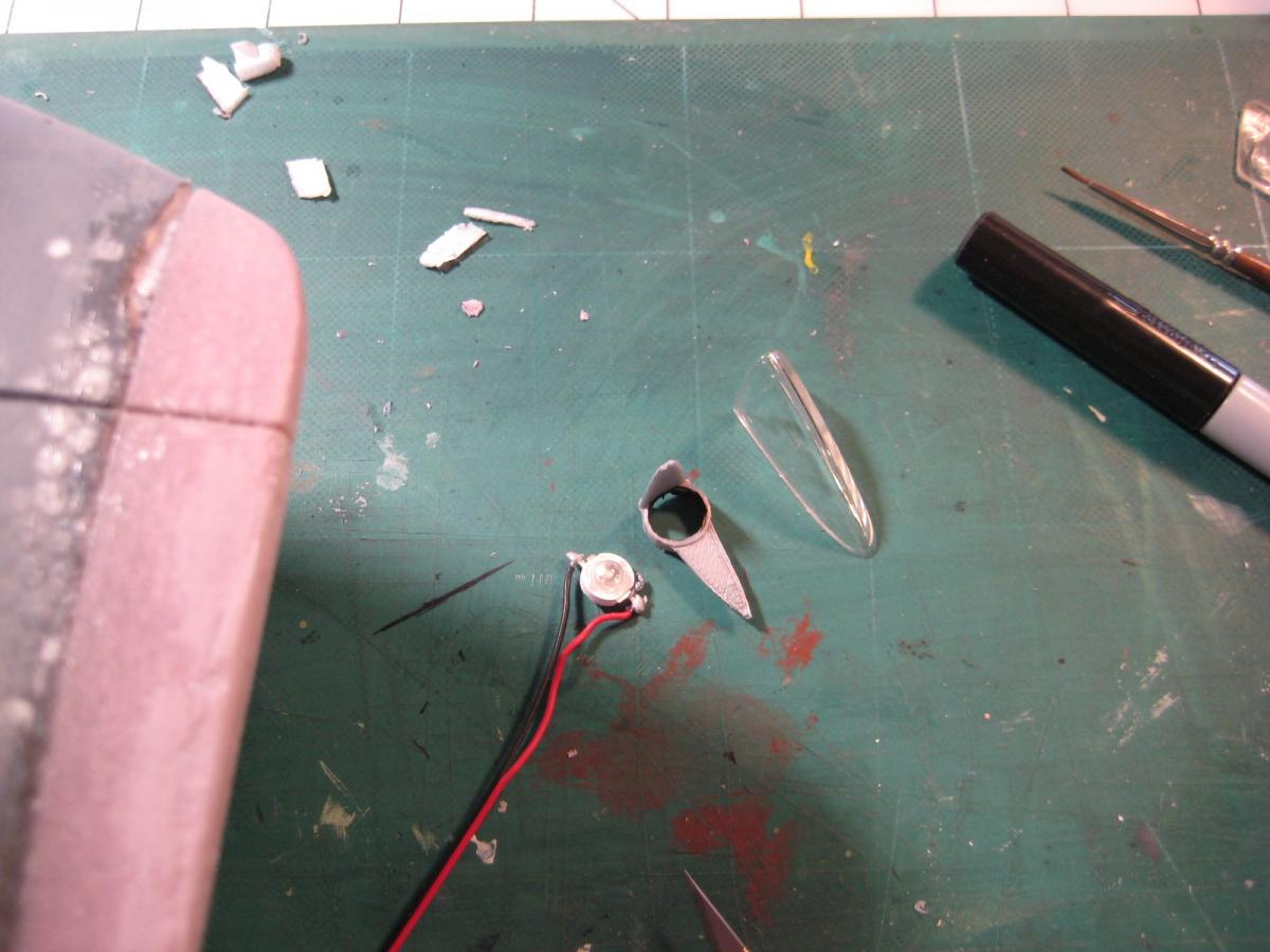

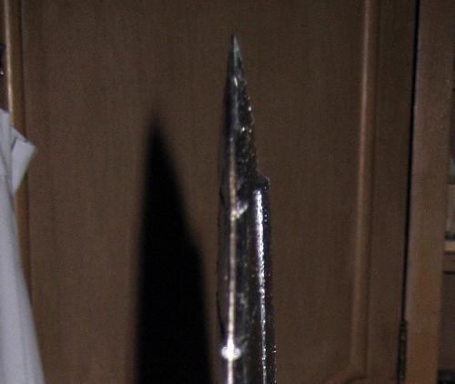

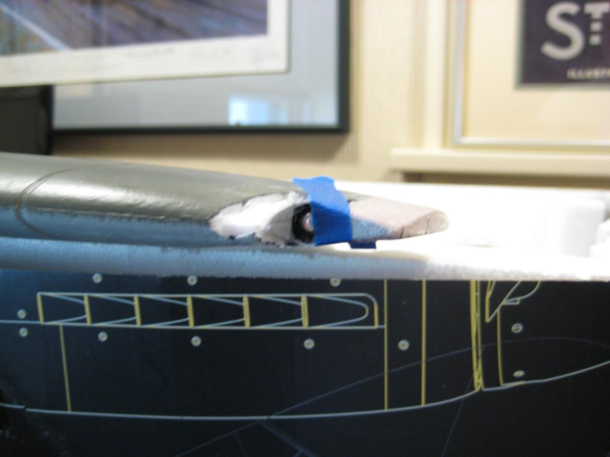

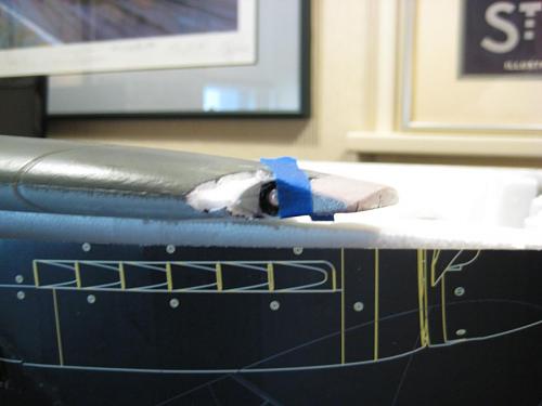

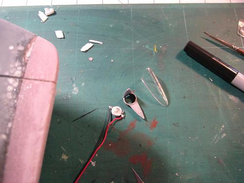

                                      Y'all, Back to work on the Spitfire/Seafire conversion and 3DPrinted a couple LED Tip Light Holders for my wing mod. Using lenses from MotionRC F-14 with modified pink foam tips. Thinking this will be the last mod before restarting assembly. WooHoo! Best, LB

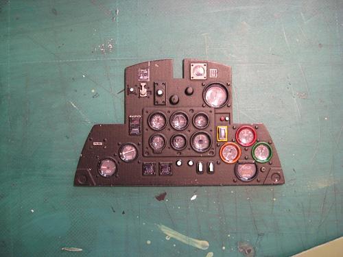

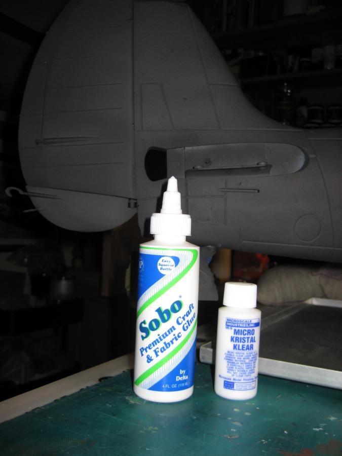

                                        I just sprayed all the interior parts (3DPUP) from Motion for my Spitty. Used Model Master RAF Interior Green. Going to drill out all the holes in the bulkheads and formers and weather components. I have the instrument panel decal from Callie and am going to add .010 glazing to the panel bezels...

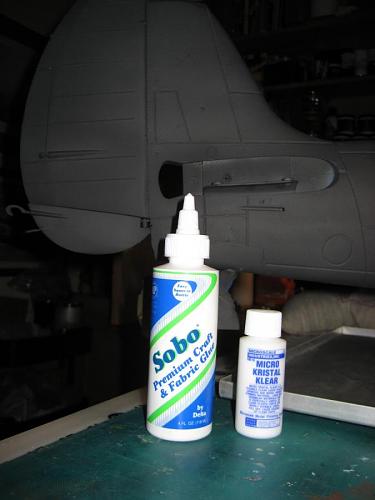

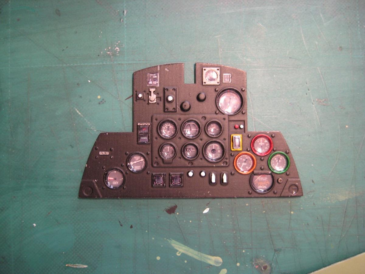

                                          H, You can use SOBO or MicroScale Krystal Klear for your Instrument Glass. It is sooooo easy. Just fill the bezel and let it dry overnight, no cutting or sizing. In spite of the poor photography, the lenses are absolutely crystal clear. Just sayin'....:) Best, LB
