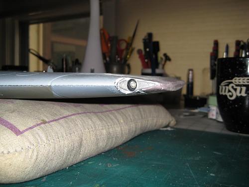

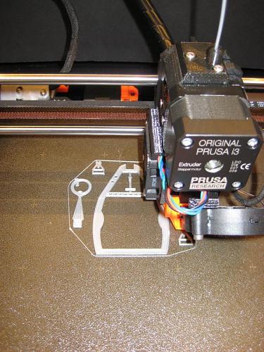

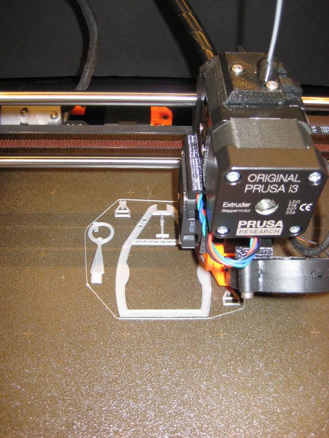

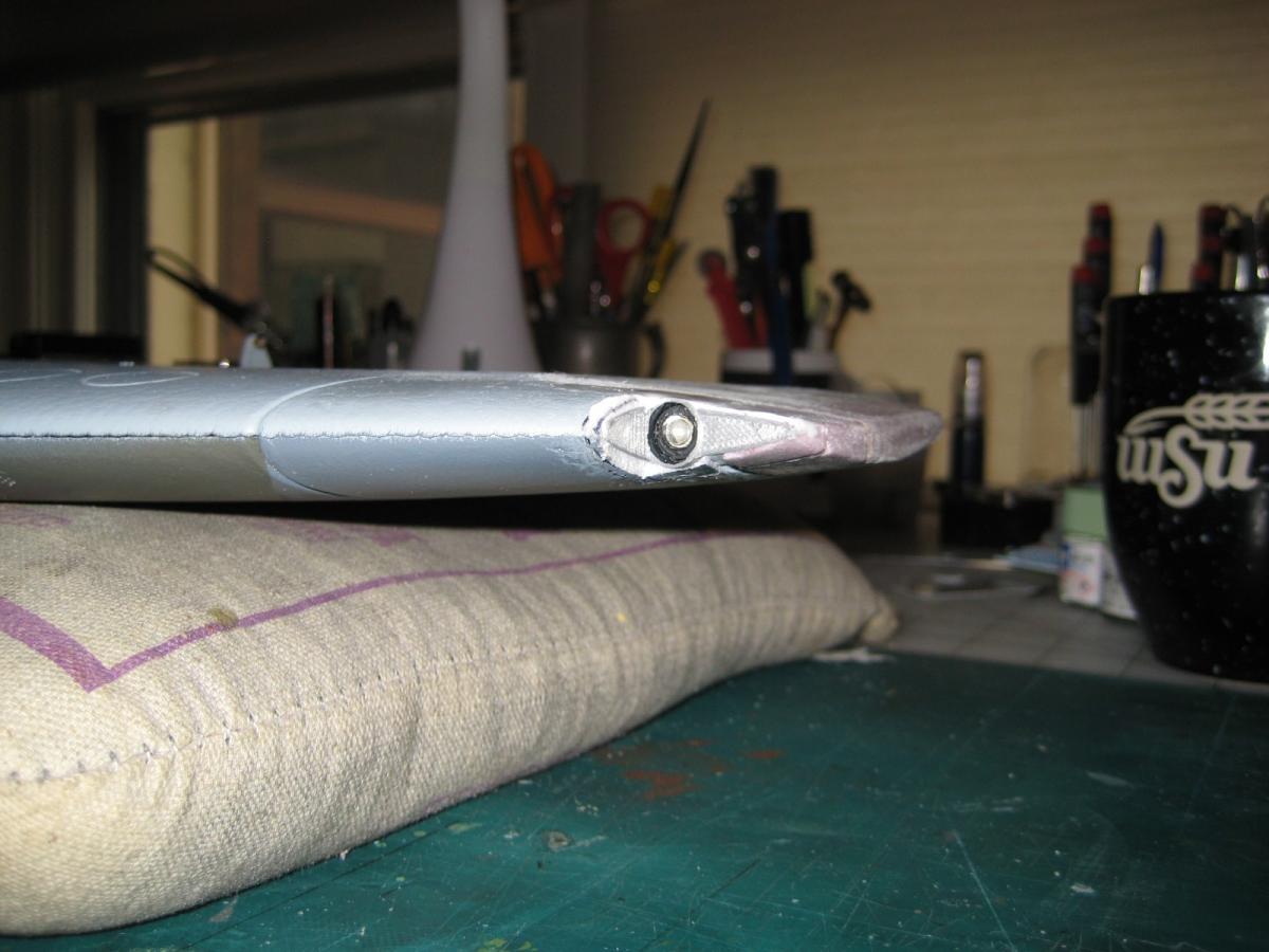

                Y'all, Both tip lights reinstalled with 3DP housings. PIB, but looks okay once the Foam FIller is wet sanded out. Better test 'em before the lenses go on, duh. Best, LB

                          Y'all, Seems odd quoting yourself, but worth mentioning, either to point out stupid:Loser: I am or to keep someone else from my error. Do Not Use 4.8v pack to test Red LED Nav Light. These are rated at 2.2 +/- v. Burnt out 2 and for the third time, I will replace a red LED in the Spitty's Port wing with Micro Surgery. Gotta laugh at myself here. "Well, DUH". Best, LB
                            #2073
                            They are really bright!!! Just for about 3 miliseconds…. LOL Poof, out goes the magic smoke.....
