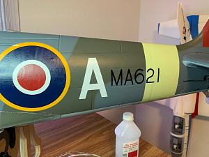

      RJ53, I had the same issue with the 'waterslides' and so I tried Micro Sol and Micro Set and it did not make a difference. Fortunately, I had gotten Callie's Spitfire Nomenclature set when she made my custom stuff. I'd save back the OEM waterslides and pick up the stickys from Callie. I did use the Roundel stickys from the kit and those worked okay. Best, LB
      Hi LB

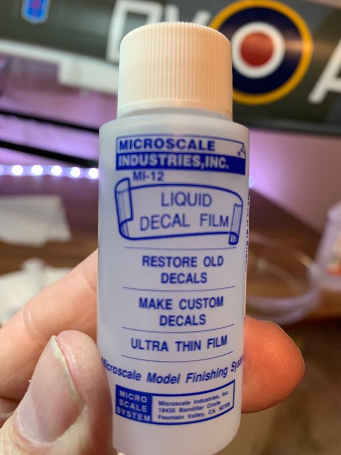

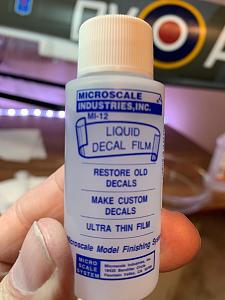

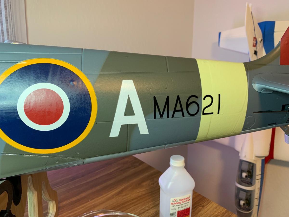

      I wanted pass along my experience. I repaired the waterslide decals with.....microscale liquid decal film(!) Also purchased all replacement nomenclature from Callie Graphics which were perfect. As you know some of the original waterslide decals needed to be used. So finally finished this scratch and dent MRC kit.. soldered on a new LED and fixed the foam on the left wing really happy with the purchase.
      I took some shots in my driveway between rain and snow showers.
      Rich

        Rich, You nailed it. She's a beaut. I have all of the Micro Products and I did not think to try Liquid Decal Film. Doh! Isn't that one of the most elegant designs. Gorgeous. Bravo Zulu. Best, LB

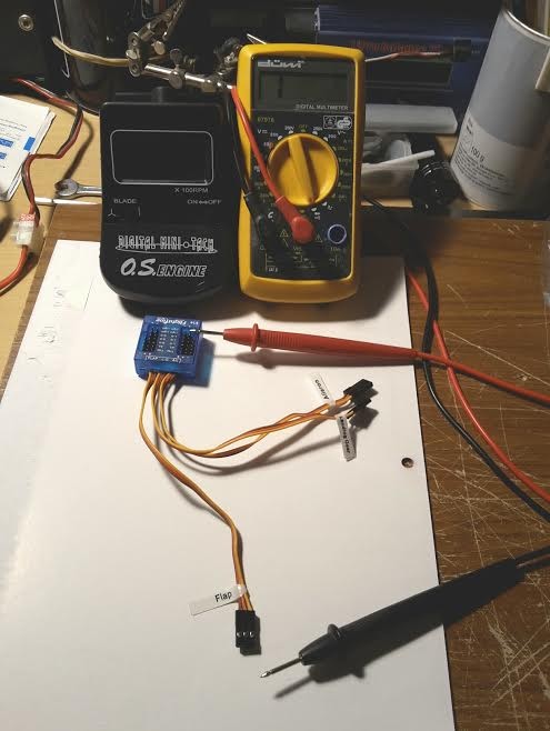

                            Is the blue box still a concern item that could give issues in flight? Didn't know if this was a first production issue or something that has followed Flightline. Good thing is can be bypassed.
                            Recommend rates/throws for maiden? I picked mine up used and it's in great condition. One of my favorite planes and first 1600

                                      @ thisguy65, a preventive view of blue-box contacts with a universal ohmmeter. Obviously, a failure (contact loss) can occur in the air, but that is then in God's hands :Sacred:... Do not worry will be all right.
                                      All the best and greetings from Adriatic Sea.
                                      Jos

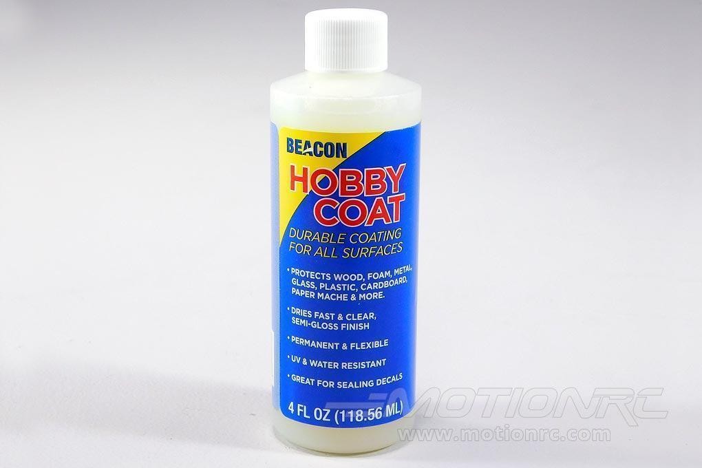

                                        Hello All , thank you very much for your kind words, and for you Rich I have a question. Do you have a web address of ''liquid decals film'' ?... I will try to get it (or something similar) here in Europe. Thanks in advance. All the best.
                                        Hi
                                        I found the company website and they will ship internationally. I would think your local hobby shops that support plastic model kits would carry this product too. So Microscale liquid decal film puts a clear plastic film on the top of the water slide decal which helps hold it together. It restores the original film the decal is made from and really makes a difference. I could not get any of my decals to separate from the paper without breaking before using this stuff.
                                        http://www.microscale.com/Merchant2/...y_Code=FINPROD
                                        Also, the Hard Coat by Beacon is not the same type of product... I have some of this for foam repairs. I do not think this is a good substitute
                                          You can always test your blue box prior to use, I have not had any trouble with either my L39 or Corsair boxes. You can always disconnect them
