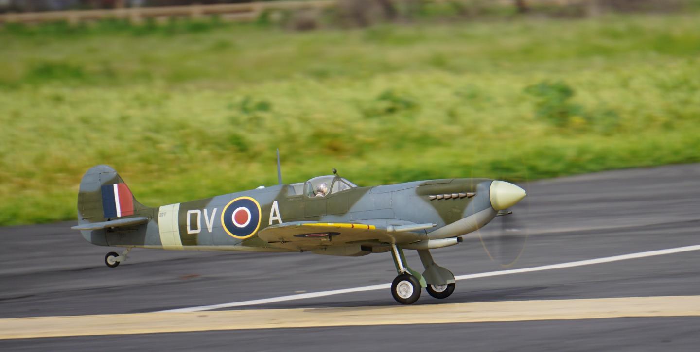

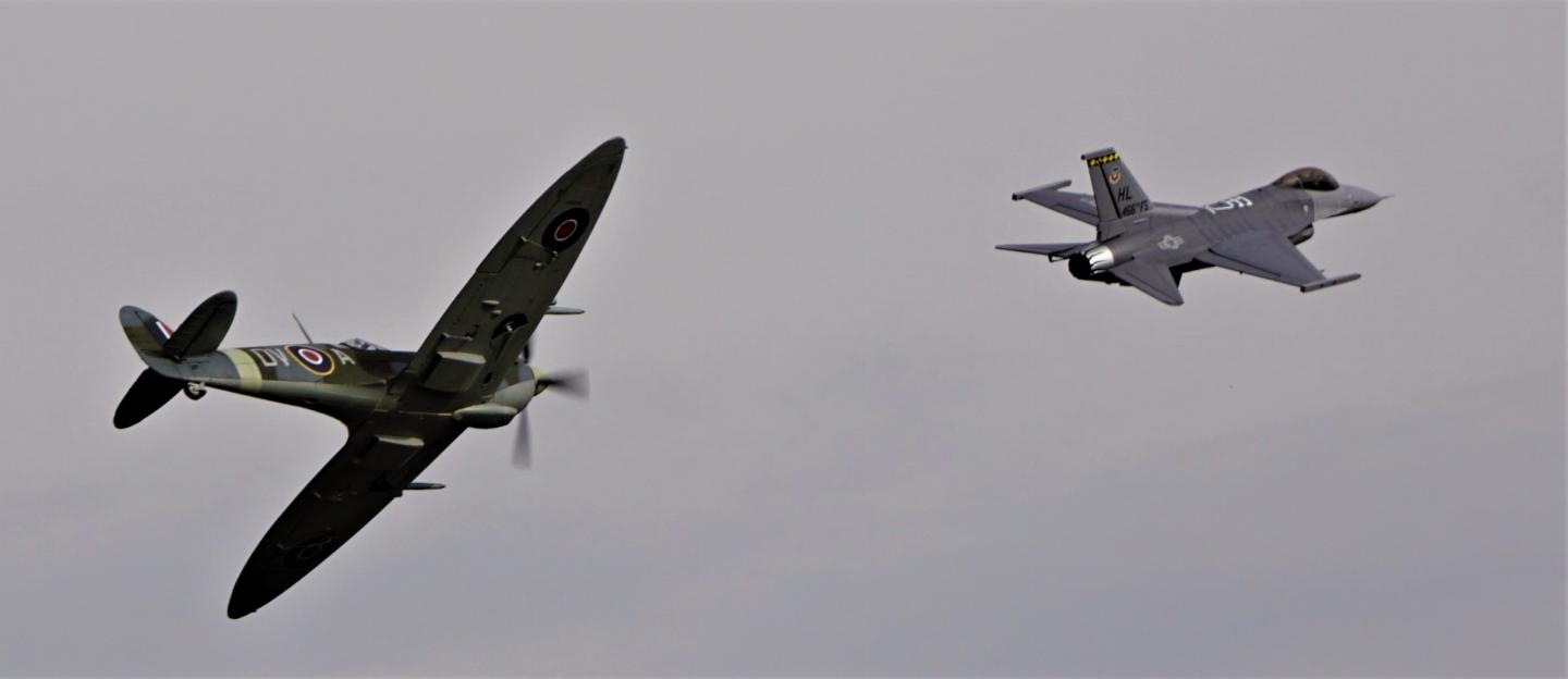

    Sam flying the upcoming Spitfire today alongside Xplaneguy's Freewing 70mm F-16 V2. Smooth flying, guys!
    Taking off...

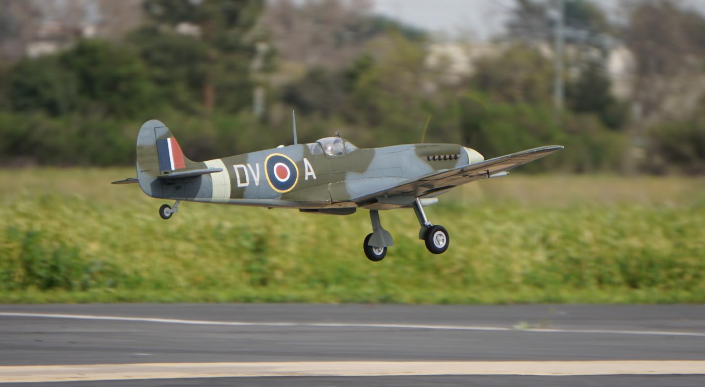

    Landing...

      Great shots! I assume there was a luxurious head wind explaining sans flaps on the landing? ;)

          Less than 3 mph headwind, Aros. This bird is so floaty it doesn't need flaps for takeoff or landing whatsoever.

                                Thanks so much for taking those photos Alpha - that was some fun formation flying! The Spitfire handled it nicely, even though the air had been a bit rough earlier, she took it gracefully. Flew great the whole time, no flaps necessary for any phase of flight in our weather conditions yesterday. Hope to be out there again soon and log some more formation hours with Xplaneguy!

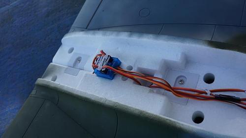

                                  Also, to those asking about disassembly and transportation, here are some photos:

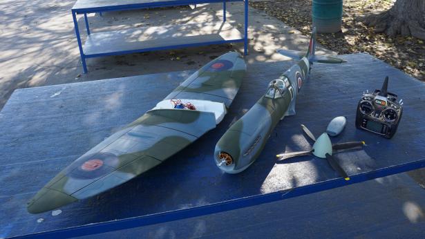

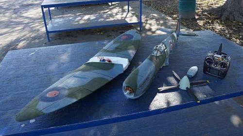

                                  The two wing halves and spar attach together with two machine screws, and I suspect most pilots will leave the wing assembled as one piece like this for transport. A blue circuit box is included to consolidate wiring for the channels and lights to just three outputs.

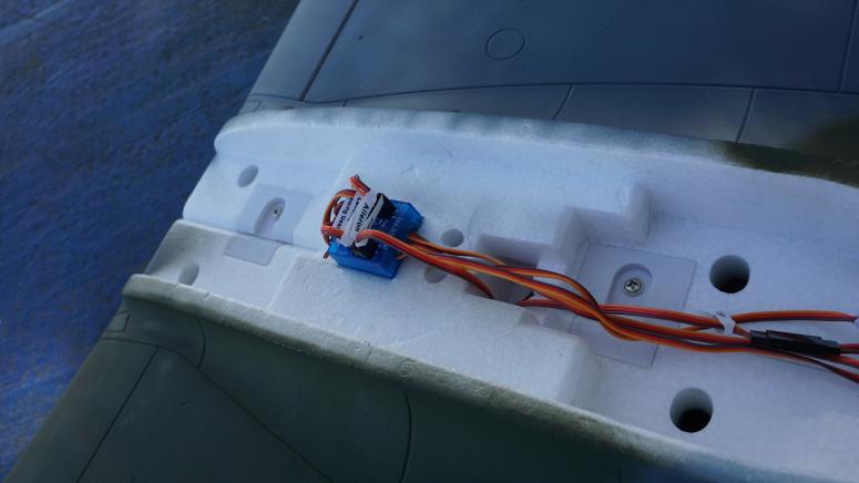

                                  Four machine screws attach the one piece wing to the fuselage, screwed into machined inserts for durability, reliability, and longevity. A fifth machine screw attaches the chin scoop.

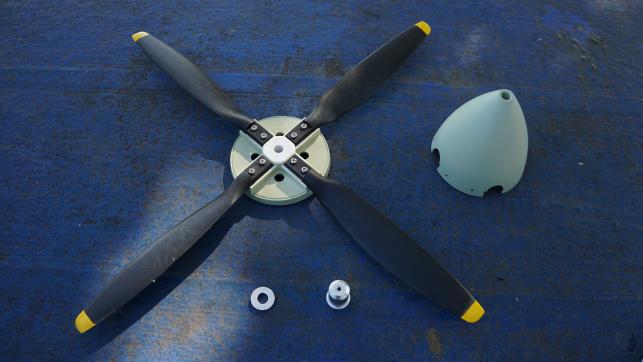

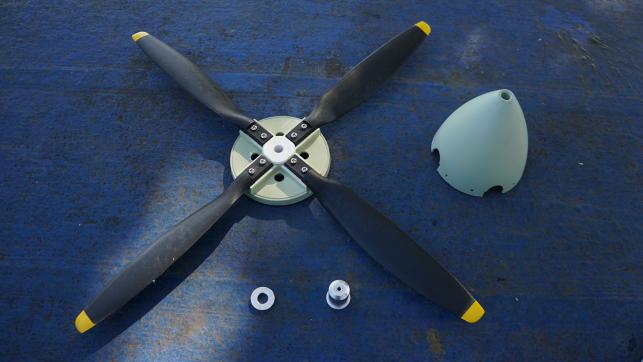

                                  The propeller is easy to remove, just unscrew the nose tip screw to access the spinner backplate/blade assembly as shown. Another note about this new backplate design, is that whereas the older backplates used loose washers from the back of the spinner, this Spitfire's backplate has eight machined inserts molded into the rear of the plastic itself. This allows easy adjustment on the fly of the blade's tracking while the entire assembly is mounted on the motor. The inserts are machine screws, so loosening and tightening and loosening the screws is repeatable without worry of wearing out the threads.
