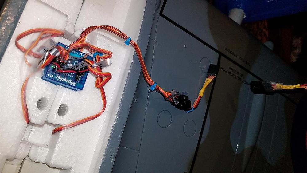

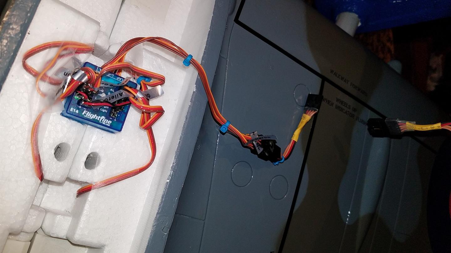

                        #2932
                        Originally posted by Jeffco
                        Any advice about assembling the wing to fuselage. I've ordered a foam model stand to use on site. But I have fitted the receiver in the fuselage with three 10cm extension leads for ailerons, flaps and gear. Plus the plug for the strobe light. Is there a better way?
                        My only complaint on the Spitfire is plugging and unplugging multiple servo leads if you remove the wings for transport, which I do. To make assembly and disassembly easier at the field, I removed the Ail/flap/gear connections and wired all three into a 5 pin latching connector, doing the same for the leads coming from the RX. This way, it only requires one quick plug in and I'm ready to bolt the wings on. I've done this on other MRC products that do not have the ribbon cables for easy connection, like the Stinger 90. Makes life so much easier and guaranteed that leaving it the way it comes will sooner or later cause a failure of the servo connections.
