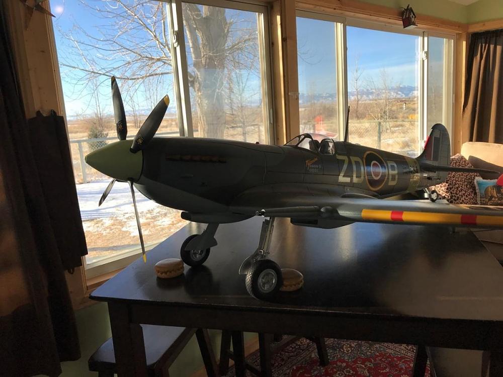

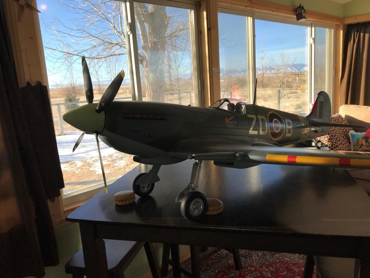

                                Happy Holidays to all Spitty Fans and Suawkers. Finally got me MH434 "Mylcraine" finished ....... and it's only six months until WY Spring 😁
Name:	Happy Holidays 2020.JPG
                                  I grew up in Casper. Seemed like most days there was wind that could tear the door off a car. So....be careful opening your car door when you go to fly it, lol.
                                    Happy Holidays to all Spitty Fans and Squawkers. Finally got me MH434 "Mylcraine" finished ..]
                                    Narly, Congrats! She's a beauty. Best, LB

                                      Narly Looks good! yeah, 6 months until spring and 7 until fall
                                      @Gringtuerto We measure wind speed with an old car door.
