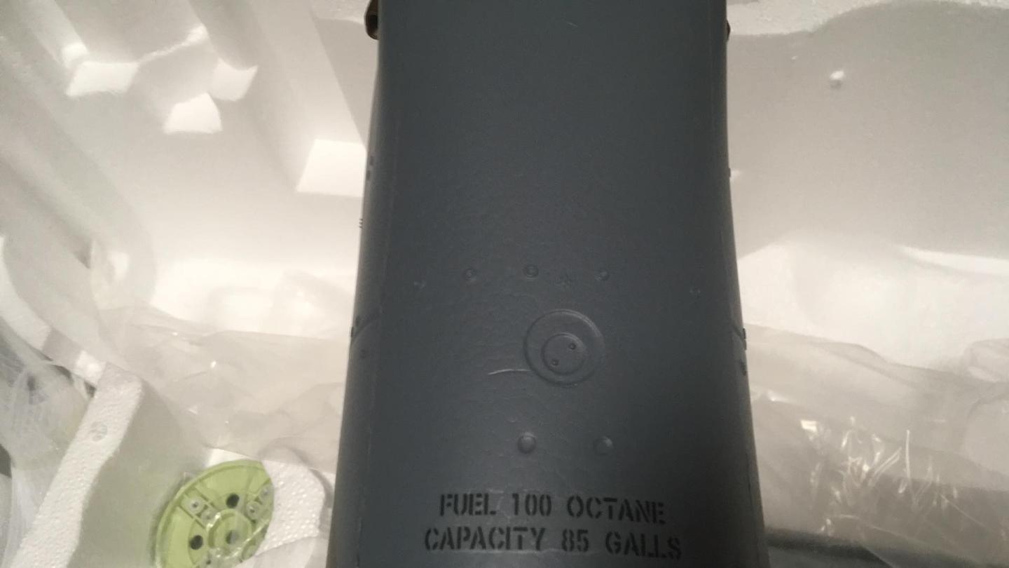

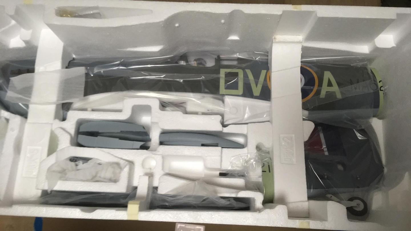

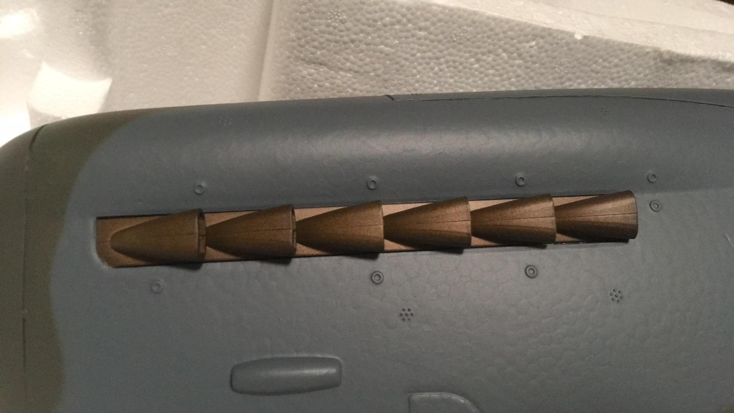

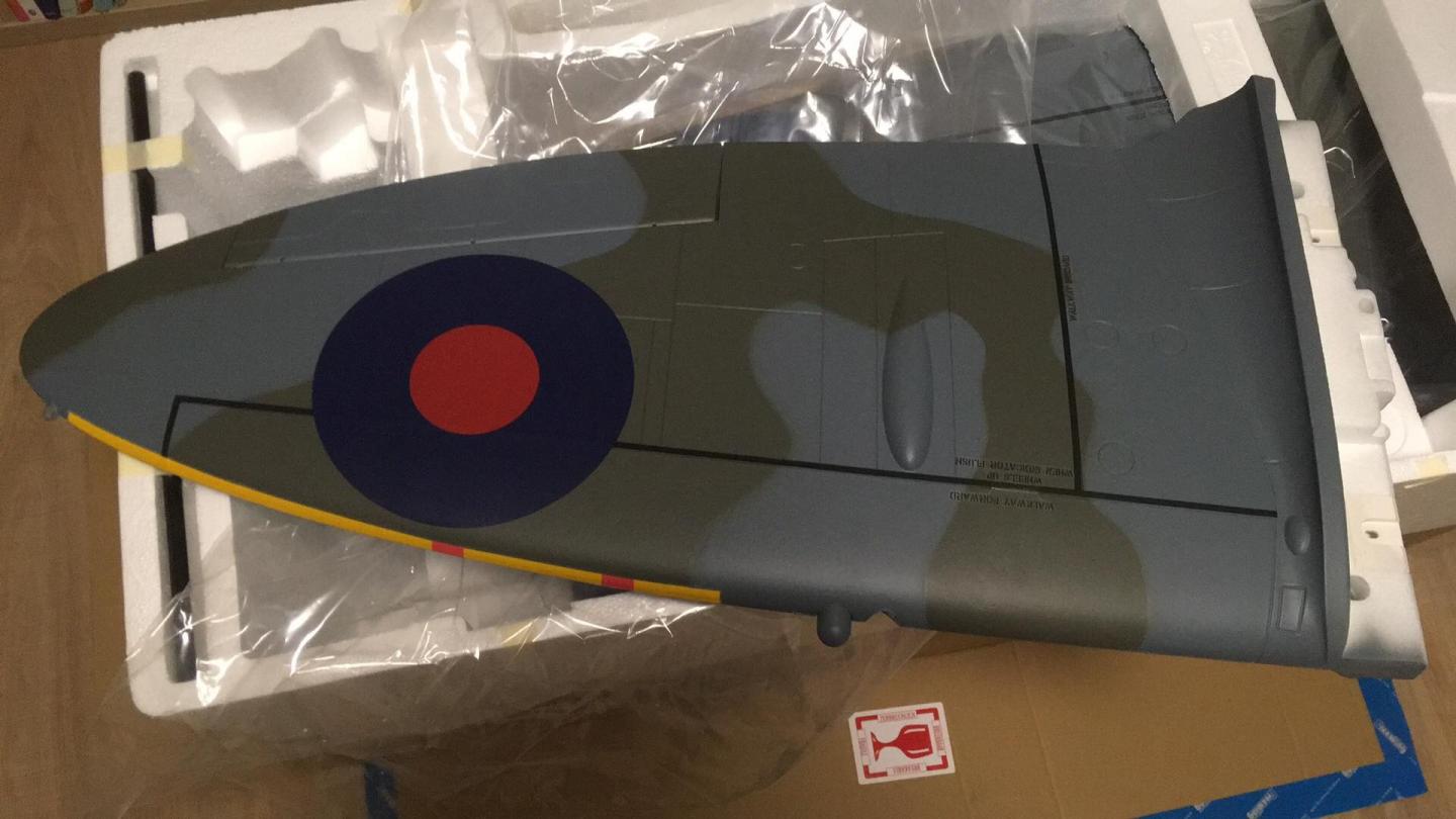

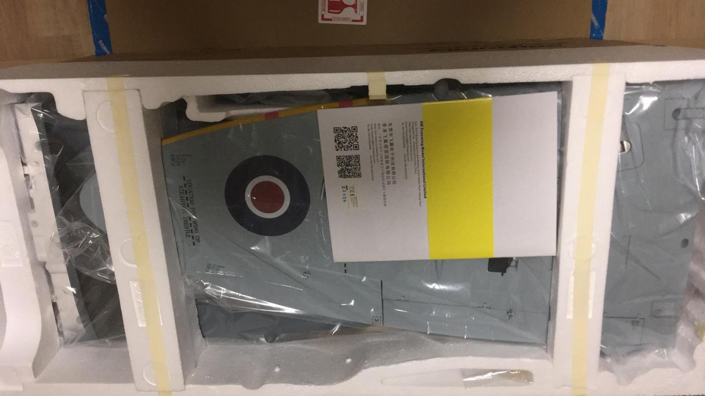

                                Merry Xmas to me!!!! Starting new winter project in days!! I will see what mods I will do on that Spitfire.
ID:	363735Click image for larger version
                                • Simon Bee
                                  • Oct 2021
                                  • 135
                                  • Leeds UK
                                  #3317
                                  👍 Mine looked so gorgeous after I’d built it, I didn’t want to spoil it by flying it.
                                    • 4820
                                    #3318
                                    Originally posted by Prekin
                                    Merry Xmas to me!!!! Starting new winter project in days!! I will see what mods I will do on that Spitfire.]
                                    PK, a dog, you lucky guy, I asked for one, too. Merry Christmas, my friend. Best, LB
                                    • Prekin
                                      • Feb 2021
                                      • 135
                                      #3319
                                      Just checked the Spitfire. Nicely packed as usually we see at FL kits. I expected, that Spitfire comes with decals on extra sheet same as B-24. What a shame, that all decals are placed on. I will have to remove them. Not sure if it will peel of paints. I will replaced some parts such as exhaust stacks, trim rods, probably 20mm Hispano cannons...
