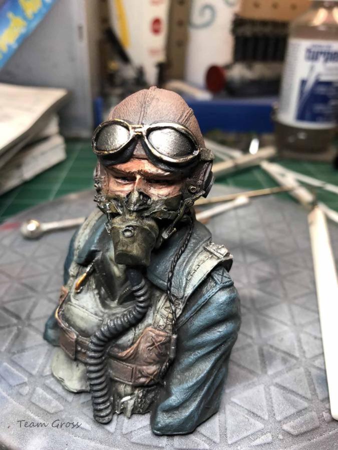

                              • 7331
                              #3415
                              Originally posted by Simon Bee
                              Anybody know where I can buy a more realistic RAF looking pilot rather than the stock one who looks more at home flying F4s in the Pacific.
                              Got Akuma Zeto to paint this Aces of Iron pilot for mine
                              He did a great job!
                                Elbee commented
                                Editing a comment
                                I used this same pilot (Warbirds?) as my Spittie Driver. With some decent reference photos, he passes muster as an RAF Pilot. Also, check out Max Grueter's work on cgtrader. He does several different pilots from different eras. I used one of his in my Corsair. Best, LB
