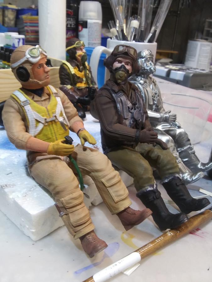

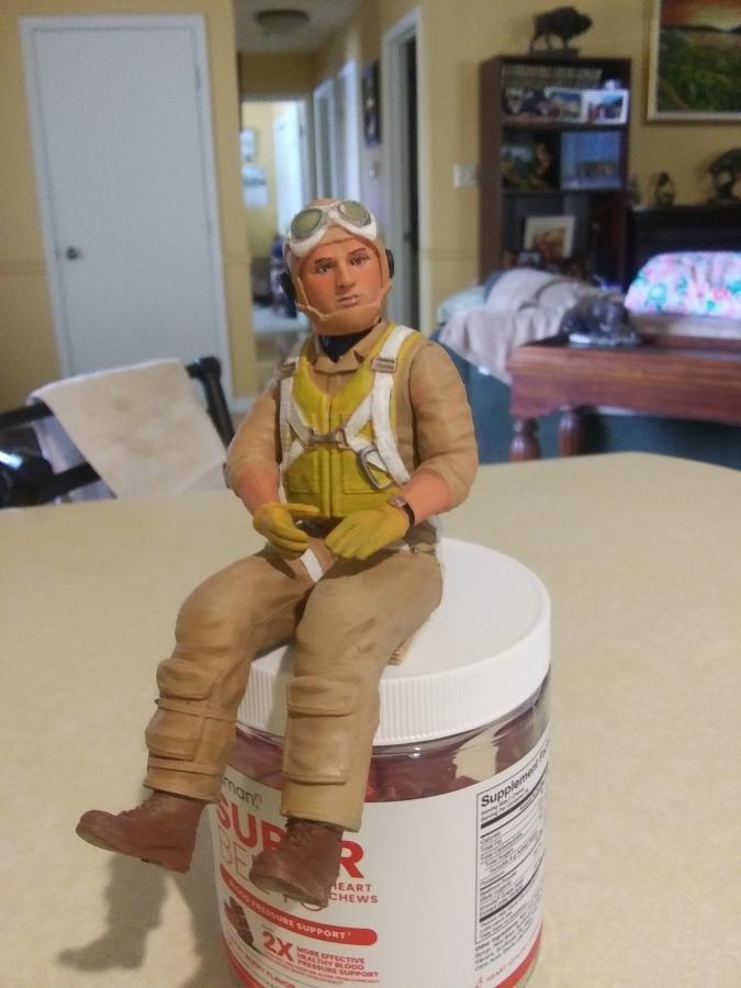

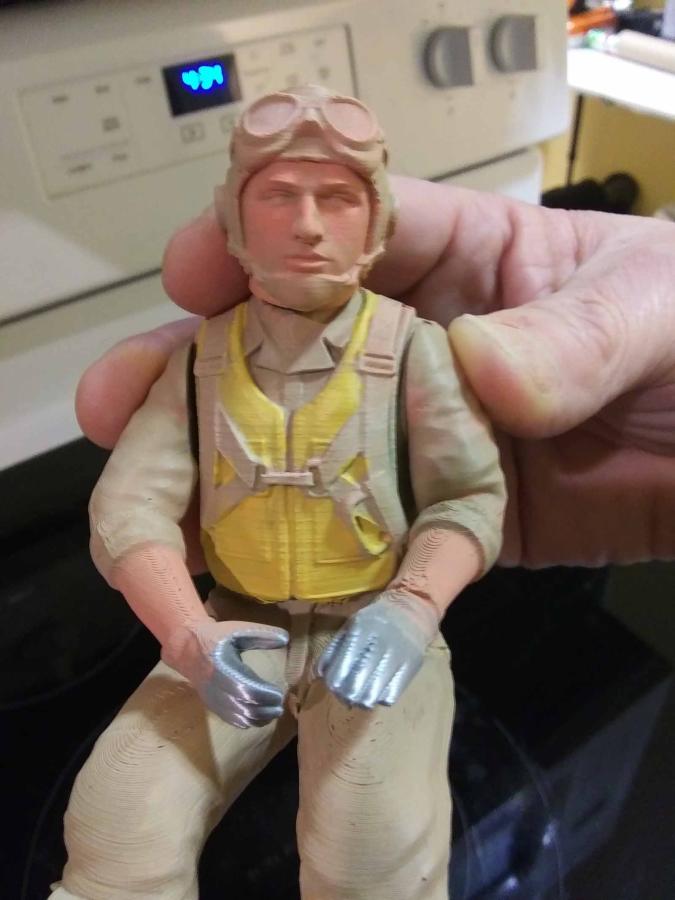

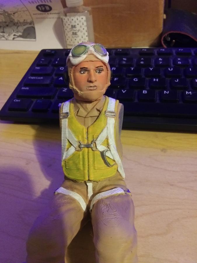

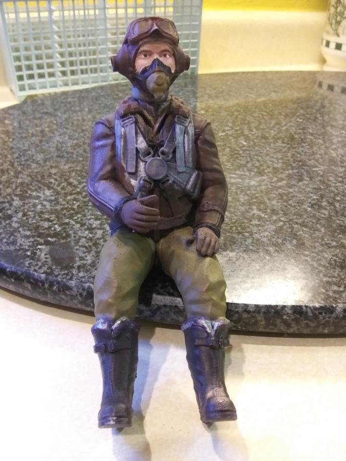

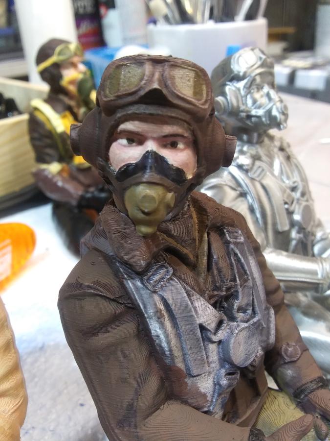

    Thanks Dan. It's what I have been looking for. Every time I think I'm getting close to being done you and Dave give more information to add things. Better looking pilots and now from Dave a better scale cockpit, NEVER ENDING!

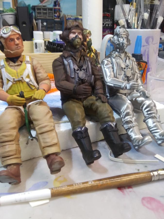

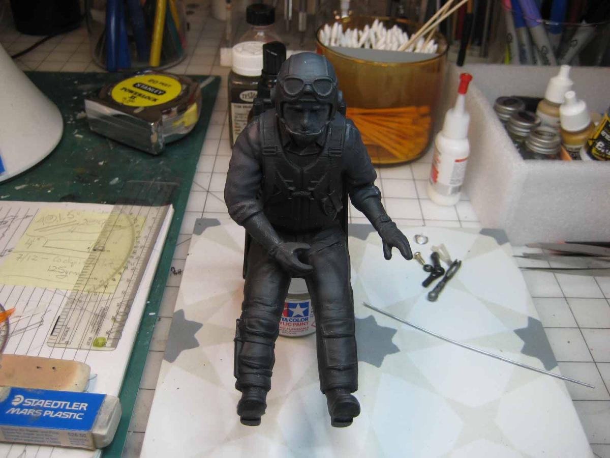

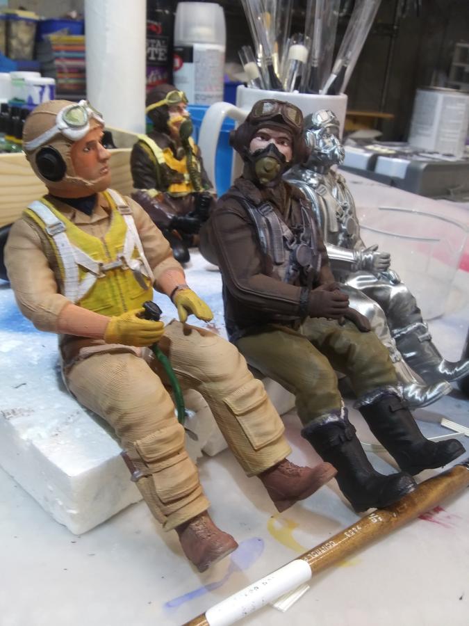

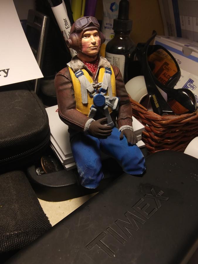

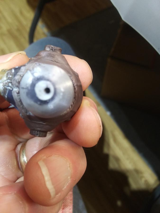

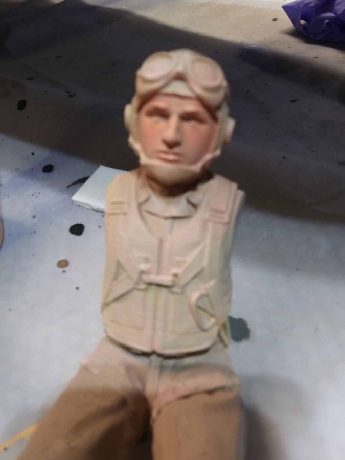

    Hi Rex, check out this video, it's a great example of 'how to'
    How To Paint Realistic SKIN TONES with NO AIRBRUSH! Easy to Do​
    (Dangerous Dan)
    Remember, the skin is not one tone, but colors made from the light hitting the flesh, the blood and the veins, all different colors. You'll see on the close up of the marine pilot that the cheeks are slightly redder than the upper lips, things like that really give it life.
    Any time Rex!
    BTW, the eyes and lips have a coat of clear gloss varathane, brings them alive.
    (Dangerous Dan)
    Dangerous Dan.
    Great instructions on how you do your pilots. I bet those guys sitting around are telling great war stories. Pictures are worth a thousand words. I sprayed the khaki/tan first over a complete black undercoat as Elbee did then using small artists brushes on face and other details. I'm not an artist but looking at your pictures my pilots are looking more realistic after each color is applied. I'm letting my wife detail the eyes/facial features. If I did it, they would look like Kuppy Dolls. LOL. I use vallejo acrylic paint also. Have the set of facial/uniform paint.
    Thank you for guiding me in the right direction.
    commented on 's reply
    mix your washes with say 6 drops of water and add paint with a brush and mix, small amounts, like one drop at a time. try it on a piece of paper and you can see how much color you'll add at that mix, a hair dryer is indispensable. You can even go so far as to use the colors that you're putting on the figure on a piece of paper and try using a was over it. You'll get the hang of it
