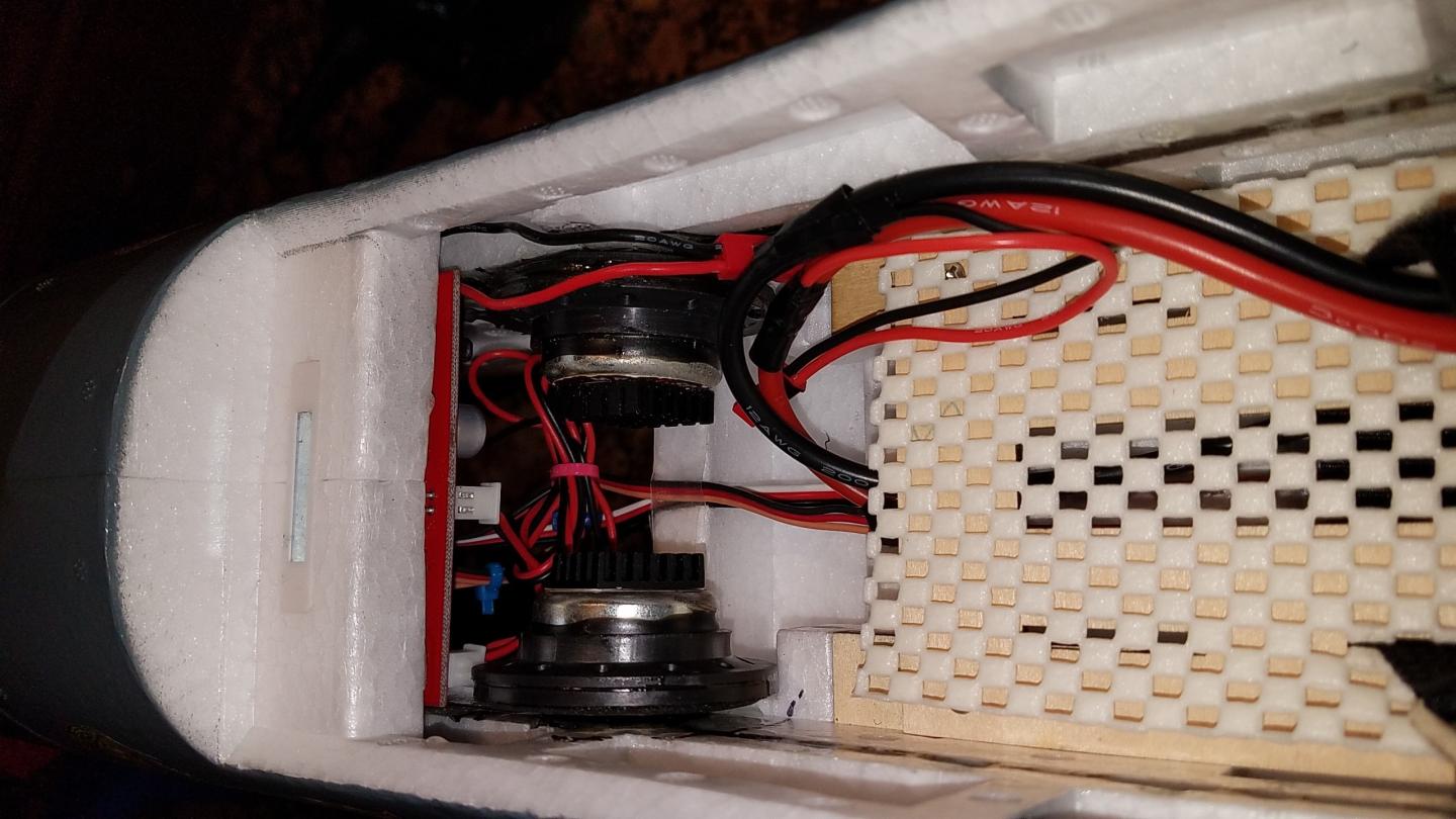

    : A second transducer really does help but I guarantee you that gluing your single transducer to the hardboard will muffle at least 70% of the sound. It really needs to be glued to the foam. The hardboard will not resonate the sound at all, in fact it will deaden the sound. The foam, being microscopically filled with air pockets, magnifies the sound and this carries throughout the entire foam of the fuselage. If you can remove it, just set it directly against the foam and see how much greater the sound is. The hollow fuselage then magnifies it further.
    Thanks for the reply, that’s good advice, I’ll relocate the speaker so it’s against the foam fuselage 👍

    Well that sucks!! :face_with_symbols_o Sorry Simon, I had no idea the MR RC Sound system is no longer available. Just did an exhaustive search and found nothing out there, not even on ebay. I've been using those since they first came out and originally dealt with Andrew (maker) directly in 2018 before MRC ended up representing them. Must have 9 of his systems now. I did try the Model Sound System with two 3" speakers in my large FW 190, which works great and also has gun sounds, but he also went out of business late last year. Maybe I'm a jinx. A second transducer really does help but I guarantee you that gluing your single transducer to the hardboard will muffle at least 70% of the sound. It really needs to be glued to the foam. The hardboard will not resonate the sound at all, in fact it will deaden the sound. The foam, being microscopically filled with air pockets, magnifies the sound and this carries throughout the entire foam of the fuselage. If you can remove it, just set it directly against the foam and see how much greater the sound is. The hollow fuselage then magnifies it further.

    Simon, I put the MR RC Sound transducers in the aft section of battery bay, then velcro'd the board upside down just under the top of the fuse behind the battery bay opening (the thin red board in the photo). The board I used was the older version as the newer Aspire board is much thicker (which I have in 7 other foam warbirds). Although the Aspire board gives a slightly louder response, the older board worked just fine and was easier to fit in. With the transducers (which are not speakers) you need to place them on the foam to resonate the sound, while the hollow fuselage magnifies it. I also put heat sinks on the transducers as these get extremely hot after a 10 minute flight. The double wasp sound of the corsair produces the hottest transducers. I also put some air scoops made out of 45 degree copper joints to help keep the transducers and board a little cooler during flight.
    The guys putting them in the air intakes are using speakers, which must be open to the outside. I do have speakers in my Aces High FW 190 which has no foam (balsa/monocoat) which sound great but these foam warbirds work very well with transducers. Very easy to set up and IMO a very neat addition. All my warbirds and even my "radial" engine Bi-Planes have sound systems.
