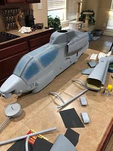

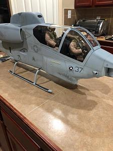

    Hello all... I wanted to start a Roban 700 Cobra page... b/c the AH-1 is one of my most favorite helicopters and also that I have a bad tendency to post my crap on other peoples topics!! To be honest I can't believe there isn't a couple topics running already already seems how its such a cool helicopter and that the kit has been around a few years.. (maybe there are pages and I didn't search hard enough) . Anyhoo, I'm not a great builder etc, and actually don't take a lot of pictures, but I will share what I have! I hope to see other folks tips and tricks and maybe get some more ideas! I have actually had this kit going on two years now, but didn't start tinkering with it till this past August...

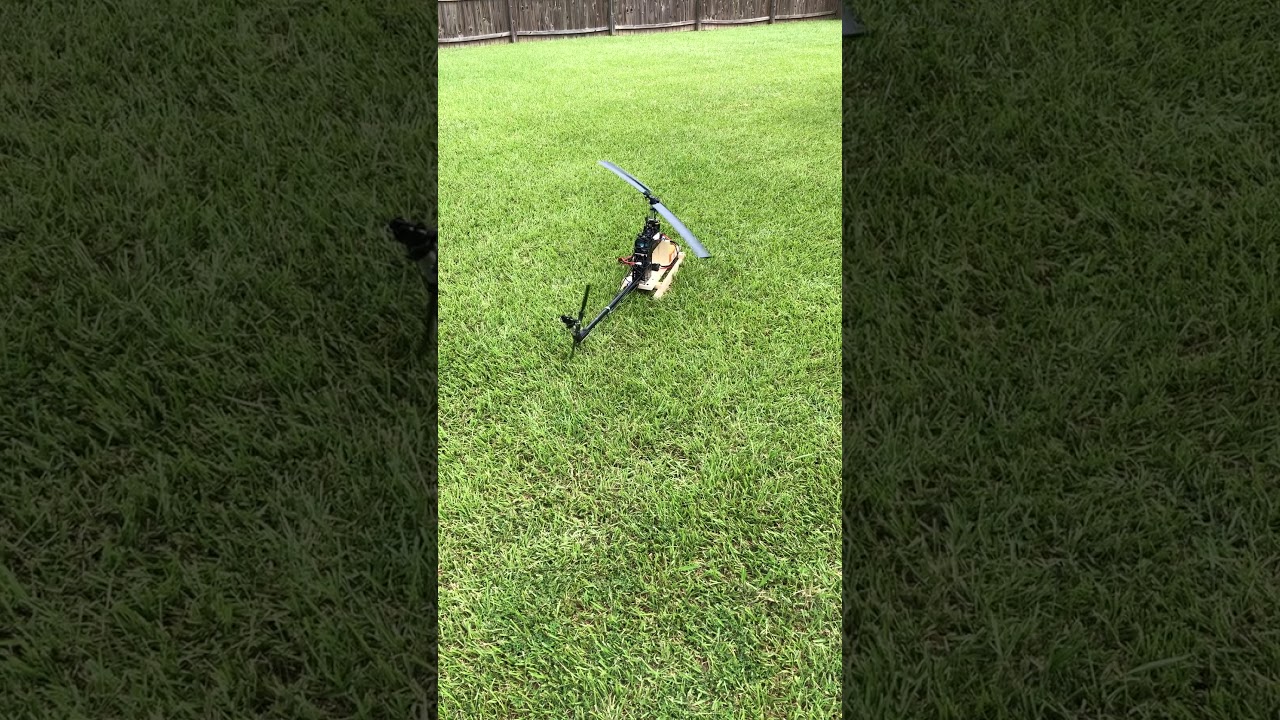

    Here's my equipment:
    ESC: CC TALON HV 120
    MOTOR: TENGU 4525HS / 515KV
    GYRO/RECEIVER: AR7210 BX FBL
    SERVO: OMG D1-ST-BM20Sx3 (Swash)
    SERVO: OMG D1-ST-BM07S (Tail)
    700mm Main Blades (Stock -Asymmetrical)
    RJX 120mm CF Tail Blades
    Waiting on the HSM 800 Helical gear upgrade to come back in stock at scaleflying.de

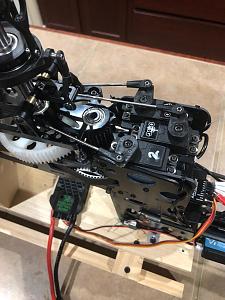

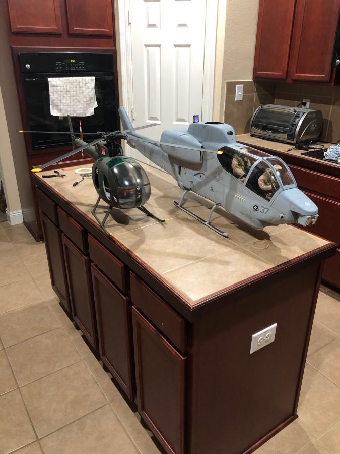

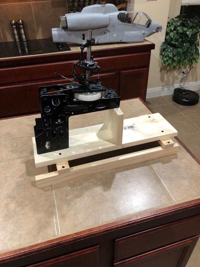

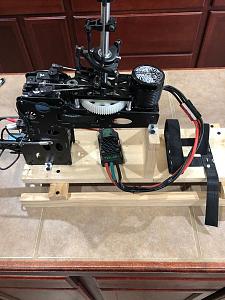

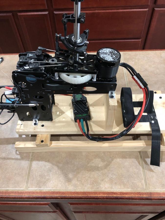

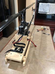

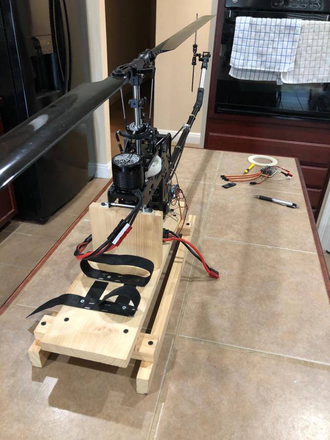

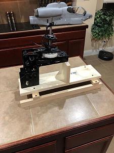

    Here's my testbed setup etc
    Click image for larger version  Name:	IMG_0263.jpg Views:	0 Size:	77.0 KB ID:	244965Click image for larger version  Name:	IMG_1964.jpg Views:	0 Size:	81.8 KB ID:	244966Click image for larger version  Name:	IMG_2803.jpg Views:	0 Size:	88.9 KB ID:	244967Click image for larger version  Name:	IMG_2804.jpg Views:	0 Size:	83.8 KB ID:	244968

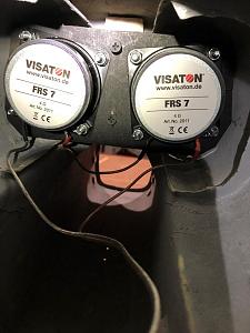

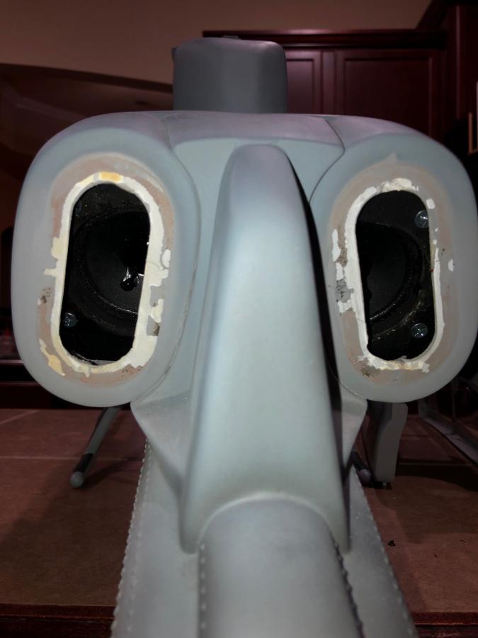

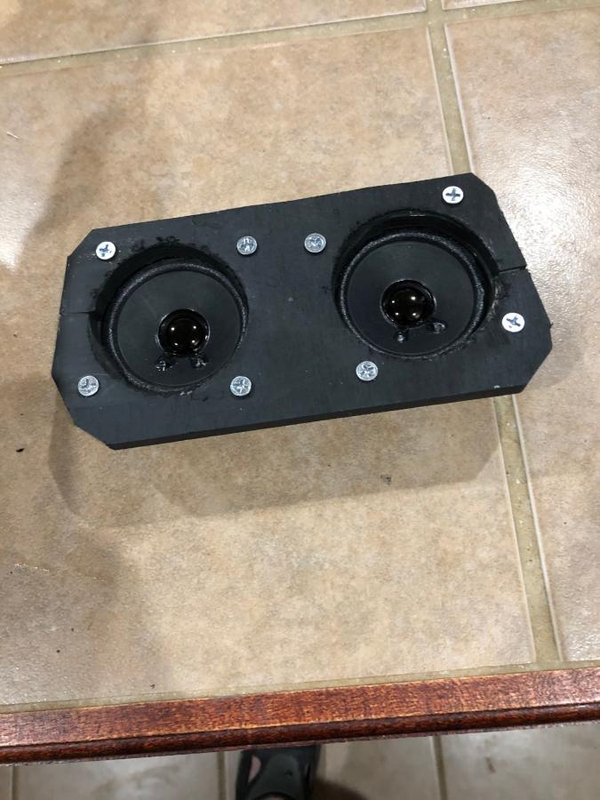

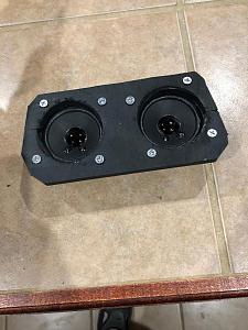

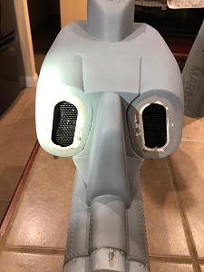

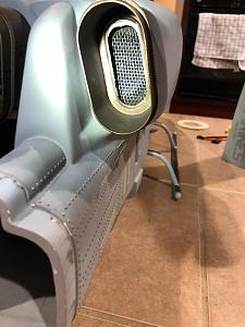

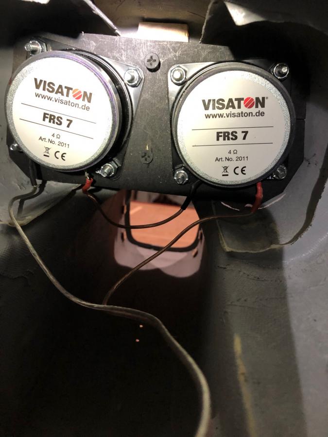

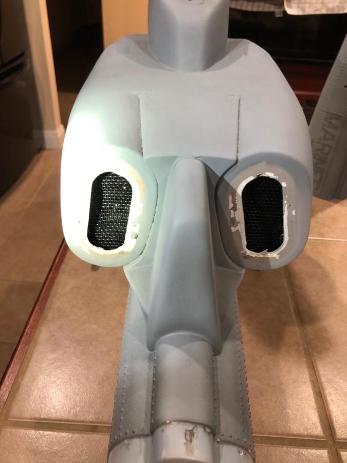

        Going to run the shockwave sound system... this my idea on placing the speakers...
ID:	244972Click image for larger version
ID:	244973Click image for larger version
ID:	244974Click image for larger version
ID:	244975Click image for larger version

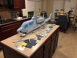

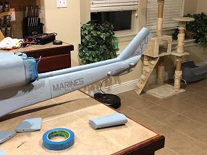

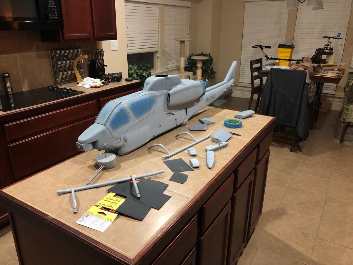

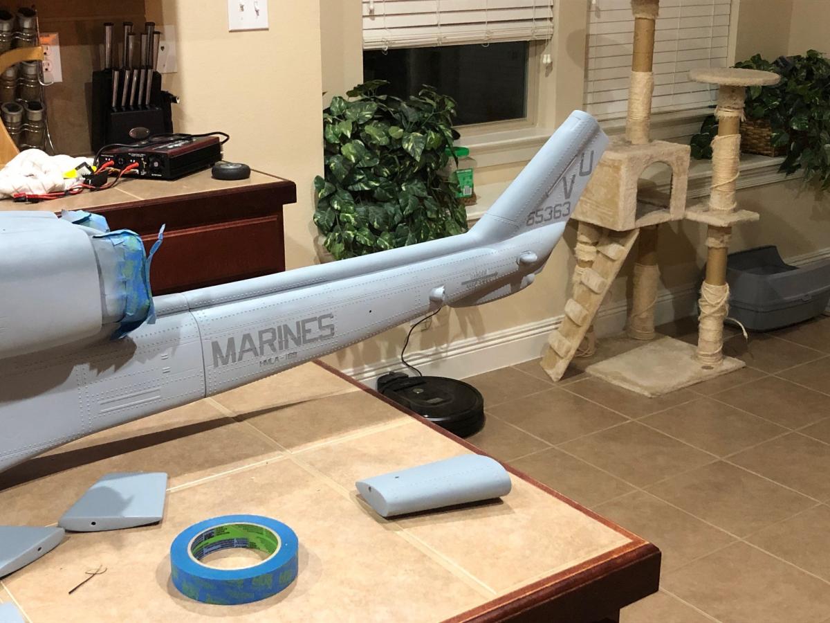

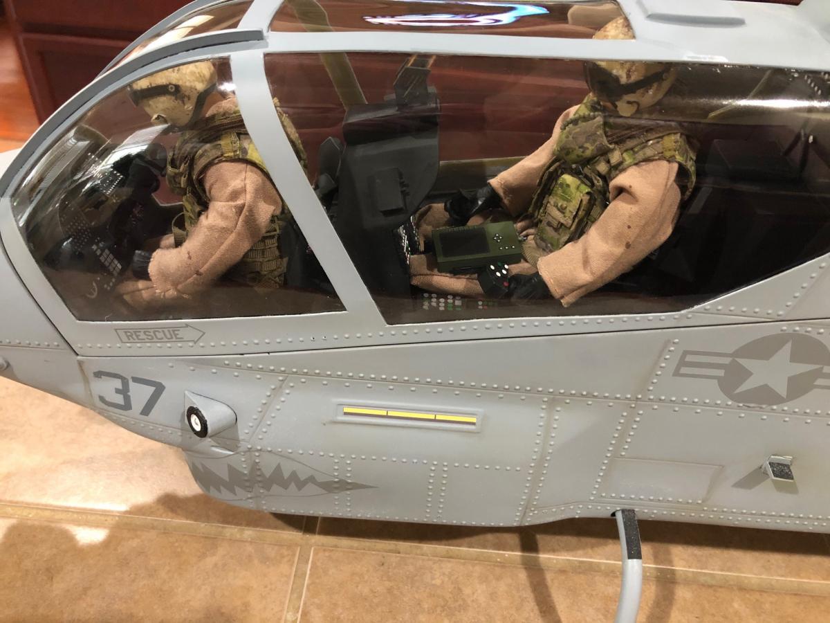

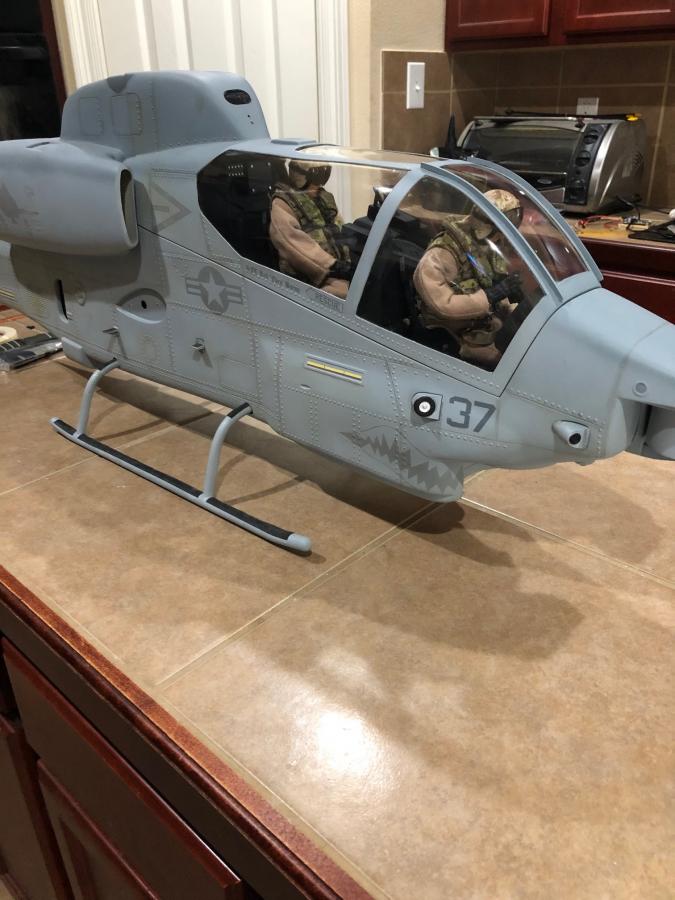

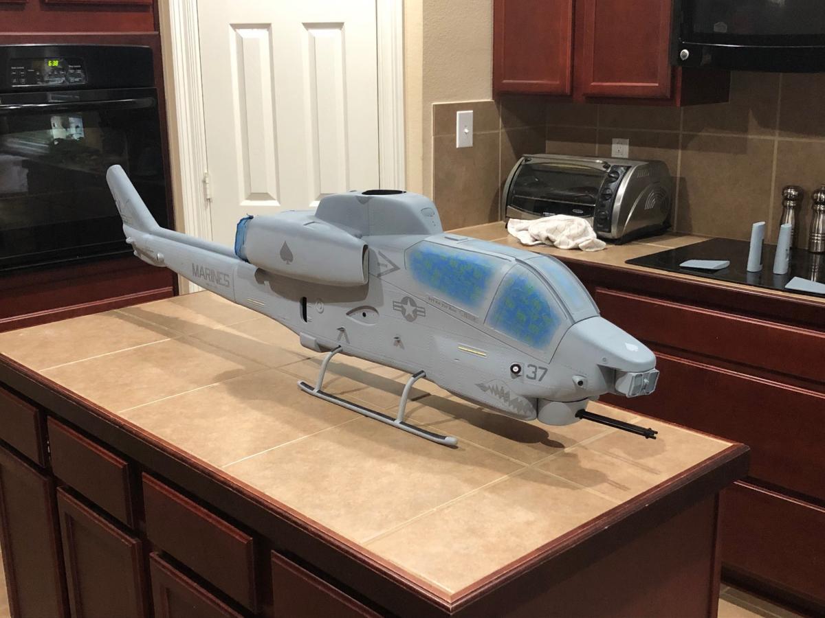

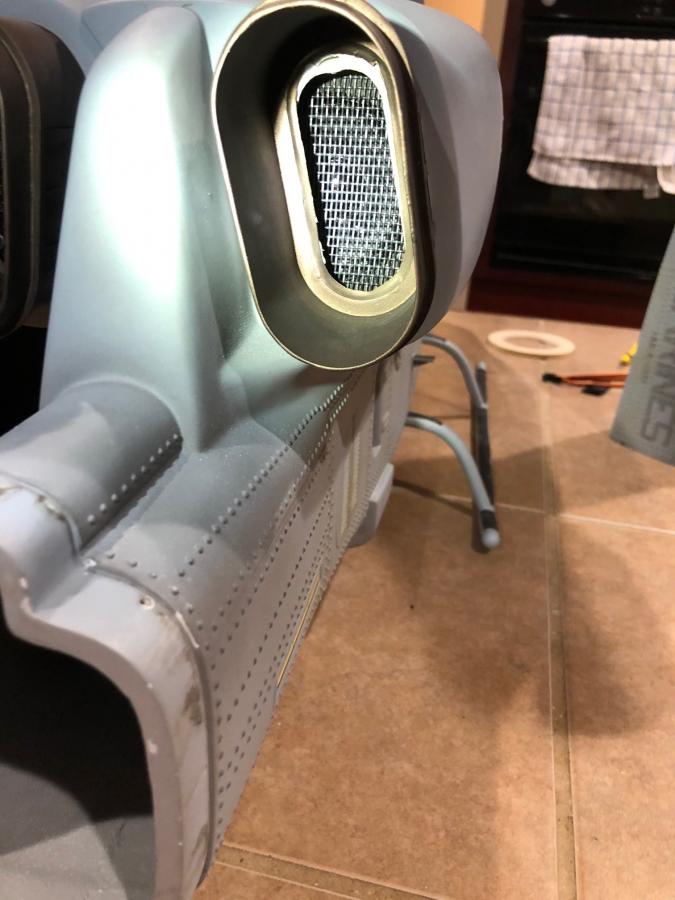

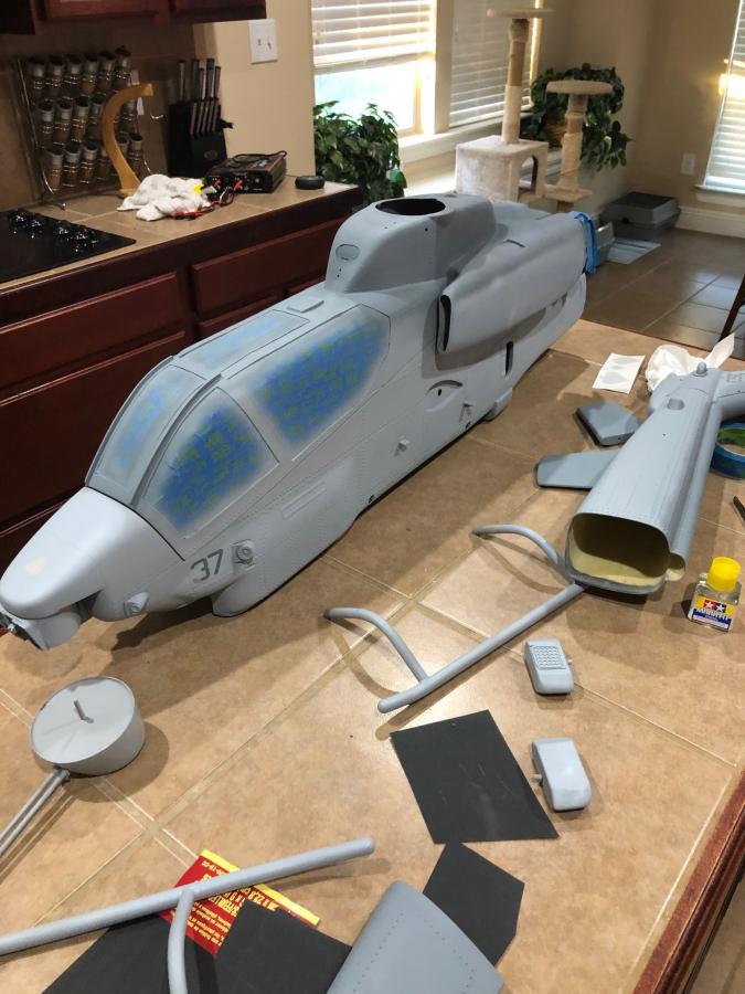

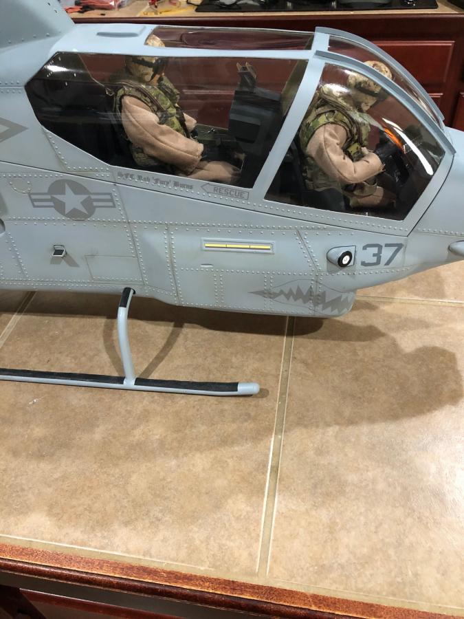

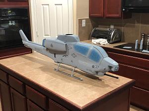

          Some painting... I'm not good at painting... best to stick with military two tone military for me lol...
ID:	244978Click image for larger version
ID:	244980Click image for larger version
ID:	244981Click image for larger version

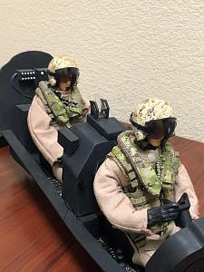

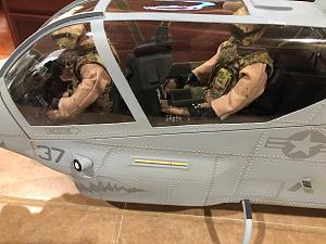

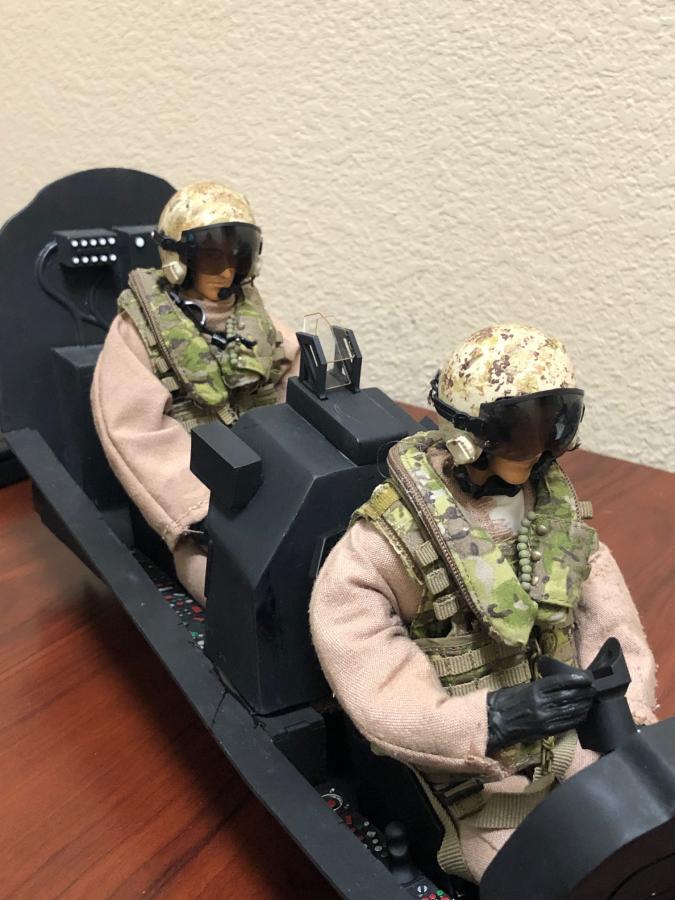

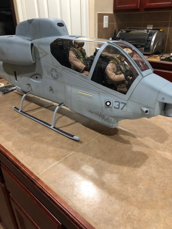

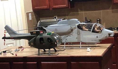

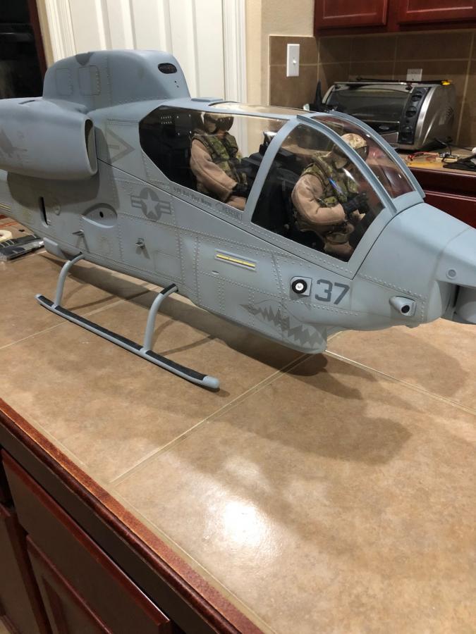

            Pilots...
ID:	244983Click image for larger version
ID:	244985Click image for larger version
ID:	244987Click image for larger version
ID:	244986Click image for larger version

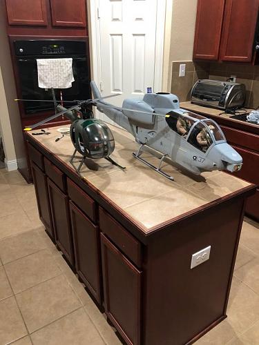

              My Pink Team... (one day I will finish everything lol)
ID:	244992Click image for larger version

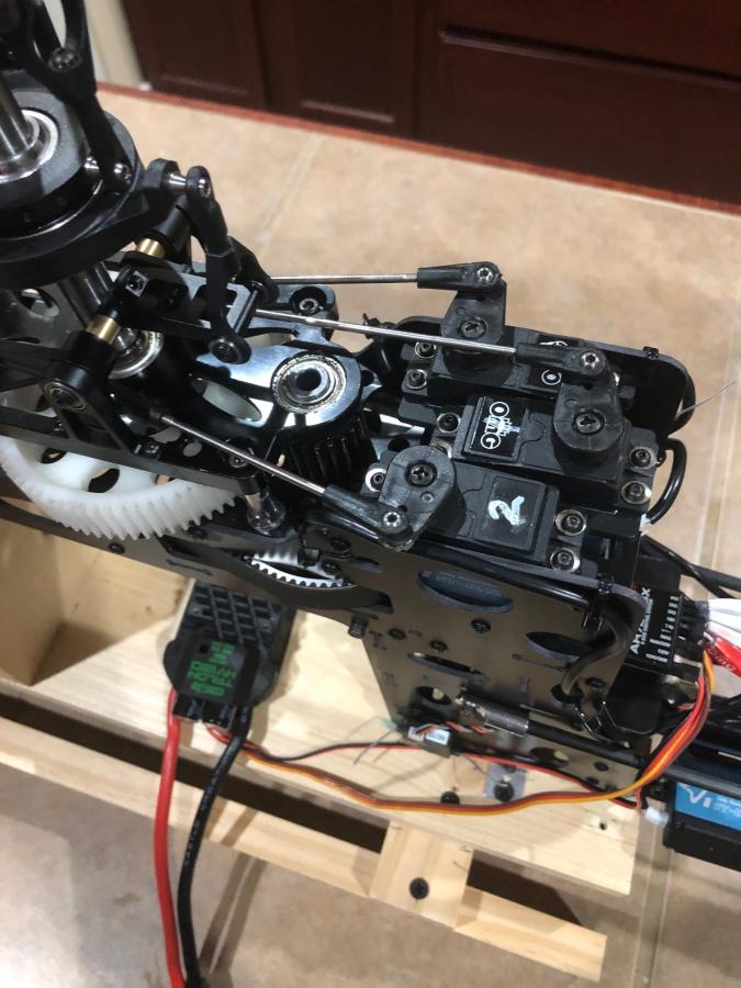

                Your painting looks good, and so do your pilots!
                How do you like those OMG servos, especially the tail servo? I have been to the factory and know they're well made, but I haven't flown them in a larger helo like this.

                  These are the only ones that I have used (in this helicopter)... and my experience in general isn't enough for me to make a good comparison between brands... I have only hovered and done a couple small circuits with the test bed so far, but they seem very responsive and no issues in handling the what little i've thrown at them. No binding or overheating etc...

                    Excellent work so far! Looking forward to seeing it fly! I have this one on the bench and am hoping to get started soon. Where did you get those pilots? They look great!
                    • #11
                      The pilots are a mix bag... the figures and helmets are the 10" jet/heli figures from warbirdpilots.com. They came with the green flight suit, harness and white helmets (with helmet accessories). The gear is from the soldier story pilot/aircrew series. The flight suit, was made by a friends daughter by one of my old real khaki flight suits. I was going for the marine Marpat paint job on the helmets.
                      • #12
                        Ah, that makes sense. Excellent work on them, and it’s extra cool that they actually use your old flight suit. I had looked at the Warbird pilot figures and ended up going a different route because I couldn't get a khaki flight suit.
                        • #13
                          Thank you! Yea i thought it would be neat touch for it to be made from an actual flight suit lol. They are actually too big... but just by a smidge.
                          • #14
                            sfcfury If you don't plan on moving the figures much, you may want to consider using Mod Podge to help stiffen and tighten the flight suit. In the past, I have used Mod Podge to stiffen fabric and get it to lay "flatter" onto large 1/6 scale pilot figures, such as the excellent ones made by www.Warbirdpilots.com. Mod Podge is brushed on with a brush and dries clear with a slight sheen. It's basically thinned white glue, that dries stiff but still somewhat flexible. The idea is that the hardened Mod Podge helps the flight suit conform more realistically to the body instead of looking "puffy".

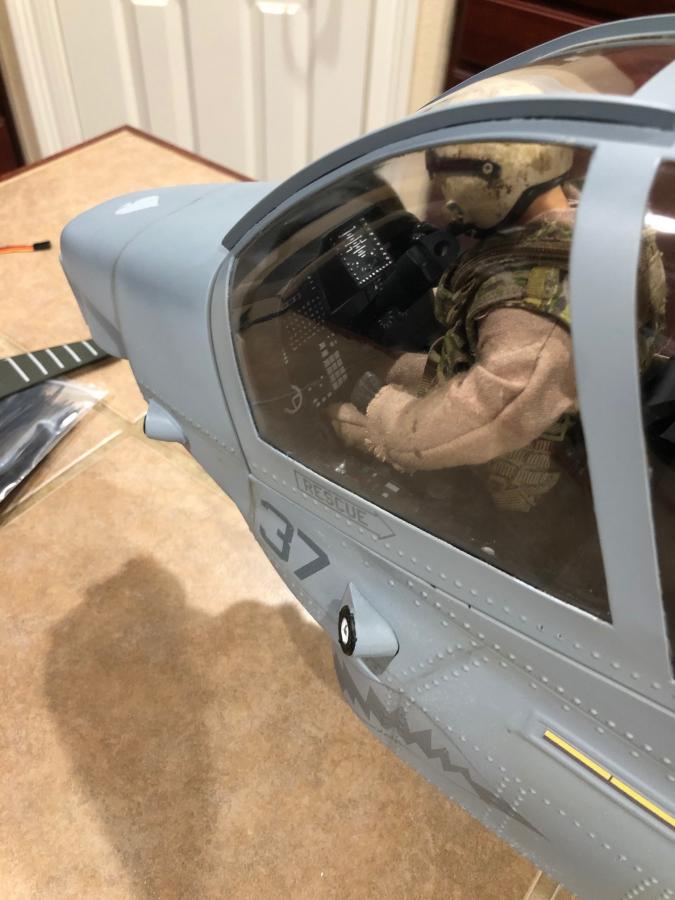

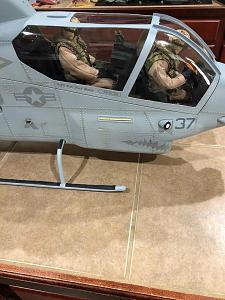

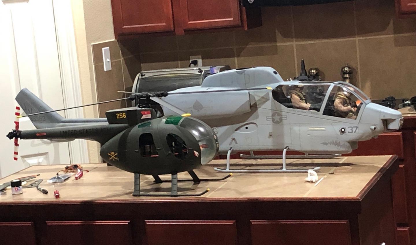

                              I will have to try that... although the don't look to puffy, my pilots are actually too tall for the cockpit; both of their helmets are touching the canopy. The pilot was really bad, i trimmed his seat down and shaved a couple mm's out of the wood were his seat attaches. The gunner i didn't touch at all... if I would have shaved his seat down like the pilot's, it probably would have been perfect for him. What works in my favor is the fact in the real helicopter, the pilots take up a lot of the space/look big as well.
ID:	245244Click image for larger version
ID:	245245Click image for larger version
Name:	Defense_gov_News_Photo_100617-N-7948R-125_-_U_S__Marine_Corps_pilots_assigned_to_the_15th_Marine_Expeditionary_Unit_fly_an_AH-1W_Super_Cobra_helicopter_during_flight_operations_a.jpg
