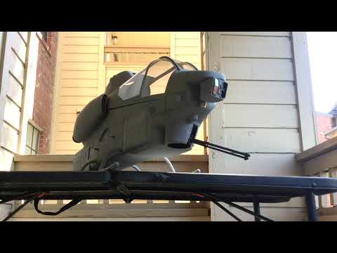

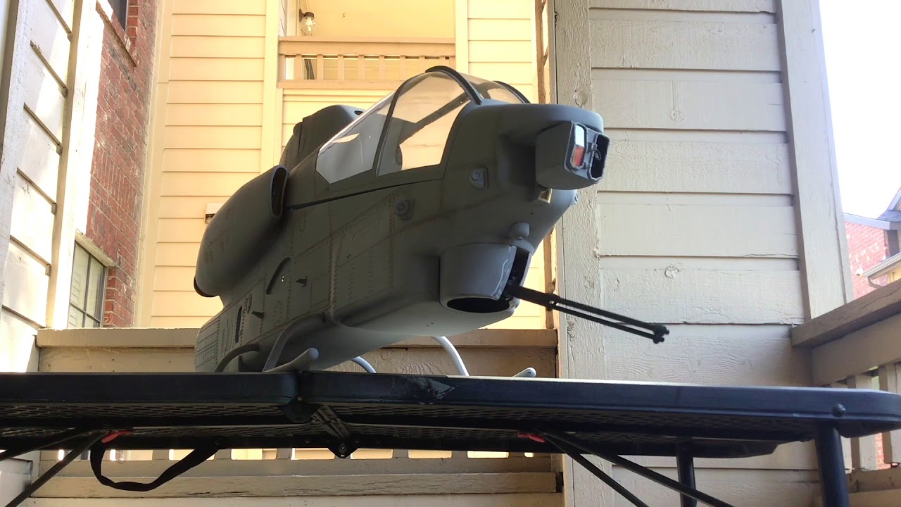

                          Just got the video of my gun turret mod uploaded. The FPV footage turned out a bit washed out, but it looks better in person. Overall, I’m pretty happy with how it’s turned out so far.
                          • Spinny Testaverde
                            Videographer, Editor, Drone Pilot
                            • Mar 2019
                            • 92
                            #173
                            This is awesome.

                              #174
                              Exactly what Spinny said.
                              • PawPaw
                                • Jan 2019
                                • 539
                                • Baytown, Tx
                                #175
                                Great job, F106. Turned out better than I had imagined!

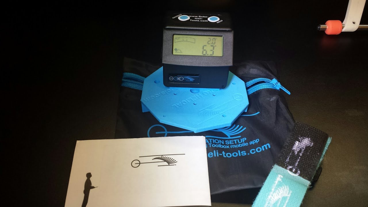

                                  #176
                                  I gotta take a break. I just thought I had the head setup really close....until I put this newly purchased Data Logger pitch/roll instrument on it. I’ve always 90’d servo arms, verified exact equal length on paired pushrods, and mechanically set their lengths to give a “perfect eyeball” level from swashplate to rotor shaft & grip screw parallel to shaft (with blades off). Always seemed to work before on smaller helis & kept me happy. Until today, that is. I been chasing digital zeros on this €£@#* thing all morning, which is made much worse by having to plug my Demon 3X FBL into my laptop to make subtrim changes because it won’t allow them in the Tx. I’m getting close to accepting -0.8* as perfect!

                                    #177
                                    F106.... man that looks awesome... got me all envious lol!! I really would like to do the traverse part at least on sync the flir and gun.... need to look at what you did closer on that... my problem is that I really don't want to add a different receiver... I think what really draws me to the AR7210BX is that it's all in one... taking care of all the normal heli stuff and you still end up with two AUX channels.
                                      Yea Paw... you definitely gotta step away sometimes! What's crazy is that I have the Demon FBL as well (I got it b/c it was suggested as well), and long before I got around to tinkering with this cobra, I got to liking the spektrum FBL's. Sooo I have never even hooked it up... I think I had looked at a video, and downloaded the interface etc, and was just like bump that... so unfortunately I can't give any advice on what to do with it. I know I do zero subtrim adjustments with the 7210... not that helps you any...

                                        #179
                                        Oh, it’s just me I think. This Data Logger is precise like I want but probably more than is required when all said and done. The Demon just makes the process difficult because it’s software isn’t the friendliest but then again Futaba menus take time to master as well. We’ll get there.

                                          #180
                                          I am curious to see your data logger device you talking about. Some where along the way I came across the soko pitch gauge kit. It's a lil pricey to say its just a pitch gauge... but I really like it.
