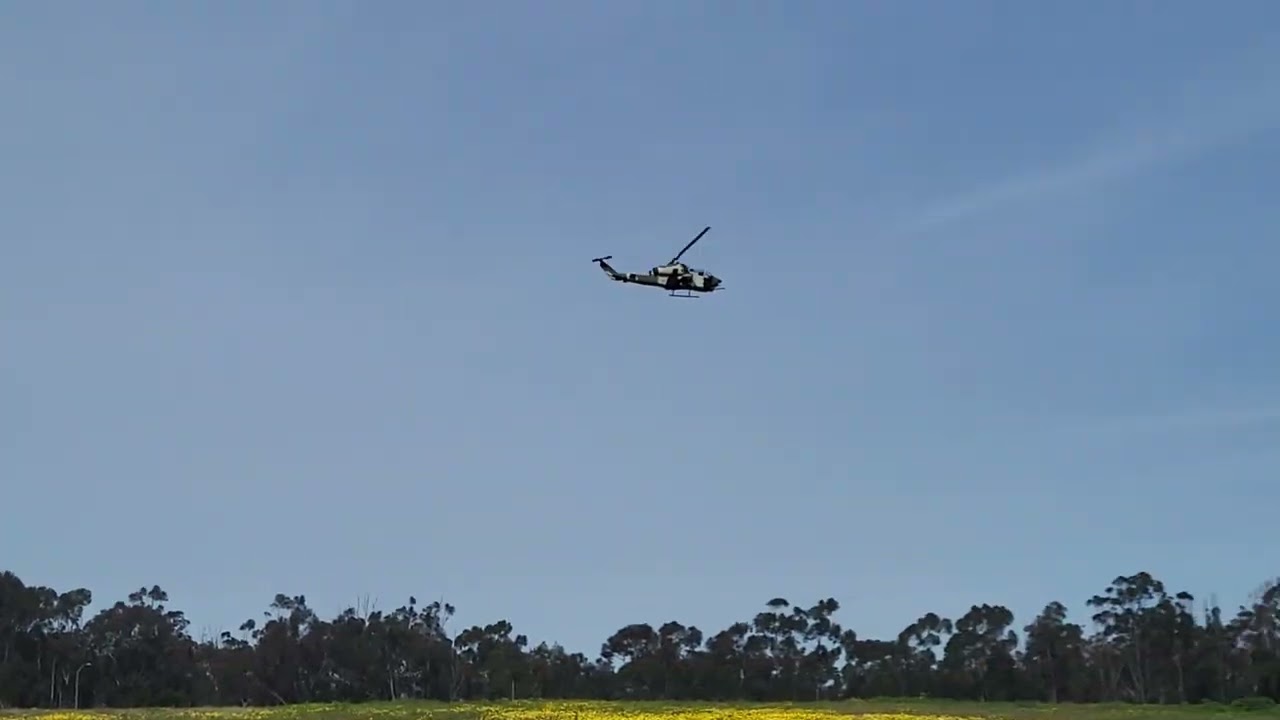

    • Sorry for the bad video, had no one to hold the camera.
      • Originally posted by DCORSAIR View Post
        Man thats nice! Looks scale and sounds good too. What are you powering it with?

          Powering as in motor?, It has a Scorpion 530kv as for motor, KST HV 1035 tail servo, MKS 1220 cyclic servos, Kontronik 160 ESC, Futaba 6303R SBus rx with a Microbeast FBL controller, all stock kit and this is the older kit with the single bearing lever control arms to swashplate, got it dialed in nicely and very easy to fly.

            Thank you for your reply. Yes, I was wondering about the e power . What series 530Kv. How many cells and what is the average runtime? If you do not mind me asking.

              Oh no problem, 4035-530kv, running on 12 cells, around 5-6 minute flight times and land around 3.85v per cell and that's with my old Gensace 60c 5000mah packs, haven't tried my new HRB 5000 100C packs yet so I'm sure I will get even better flight times with those. I don't know my head speed, I just go by the sound I hear and how the heli responds to my stick position, been doing this a long time so I don't calculate anything.
              Its been a few months since I have flown it, time to get her down and take it up for a few sorties.
              • I'm using the Egodrift 4525-515Kv and usually have 5500 to 6000mah packs (12S) and my timer is set to 8 minutes. I have very slow spool up... so It's about 7 minutes of 'semi-aggressive' scale flight... When I land I usually am at ~3.7v per cell.
