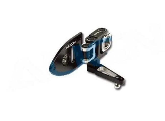

        So as I try to wrap up my tail issue... (which was that once all together my pushrod was rubbing against the vertical tail fuselage-and I didn't want to cut/dremel anymore off the tail), a good 'just to know' is that it looks like as far as the tail goes, any parts that fit the Align 600 (definitely 600 ESP) should match up. I can confirm that the part number H60250T 600ESP Metal Tail pitch assembly is 100% drop in replacement for the stock roban piece. Well at least on mine lol... Idk know if the tail has changed from 18 months ago lol. I bought it via google shopping for $16.80 from ALL e RC. Comes just how you see in the picture complete (side plate etc).

        • PawPaw
          • Jan 2019
          • 539
          • Baytown, Tx
          #204
          Thanks for the info sfcfury....I’m just about at the point where I’ll see if mine rubs like yours did. I did notice how easy it could be to get the tail boom a mm or two off center at the lap joint when drilling the mounting holes which would translate to much more at the vertical fin. I almost needed to relieve a little ‘glass to get mine plumb.
