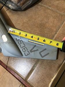

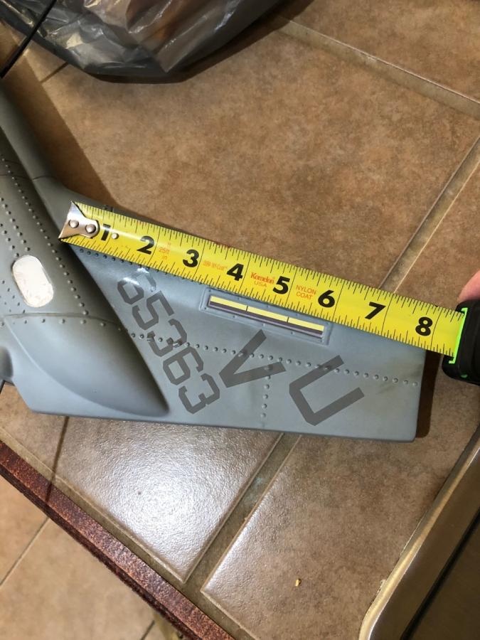

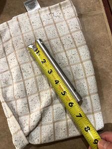

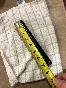

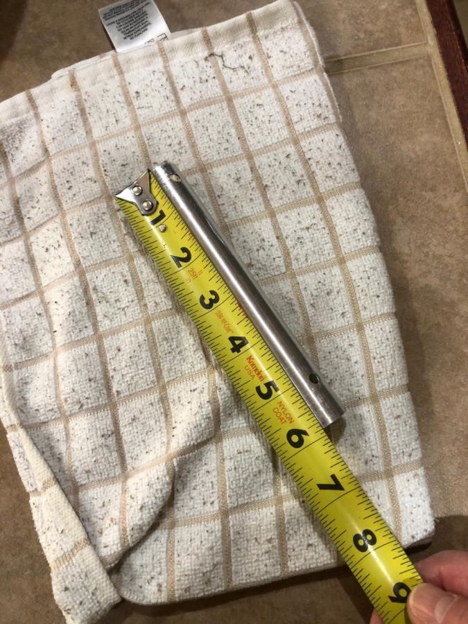

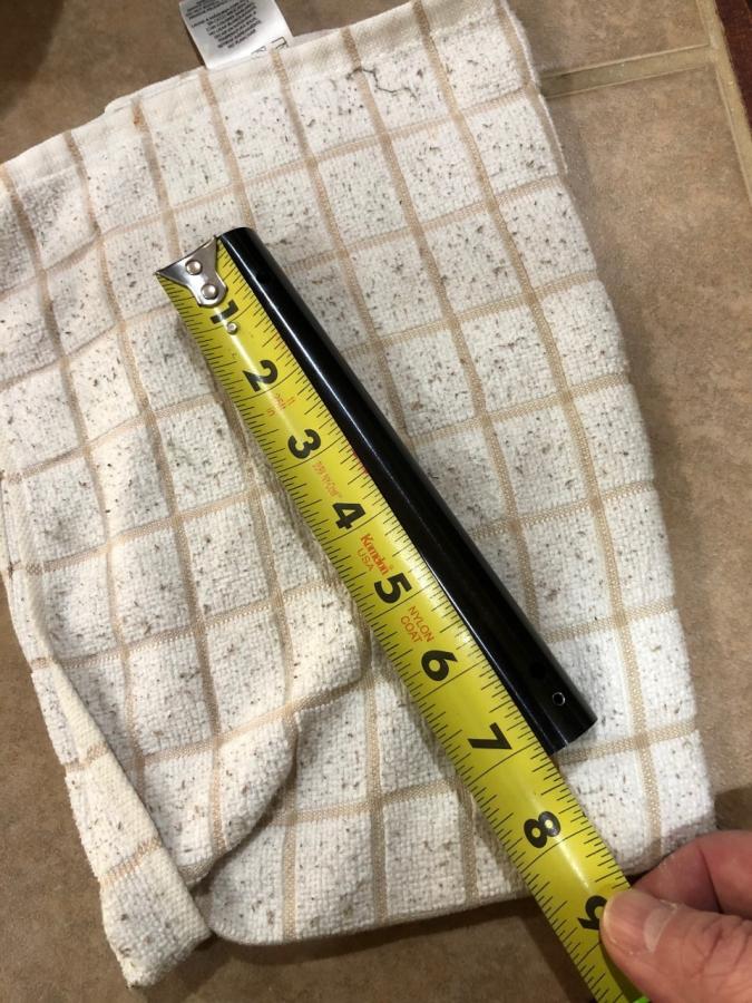

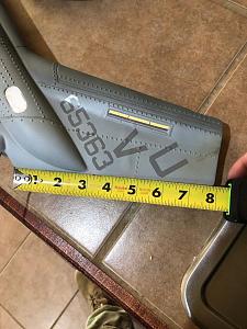

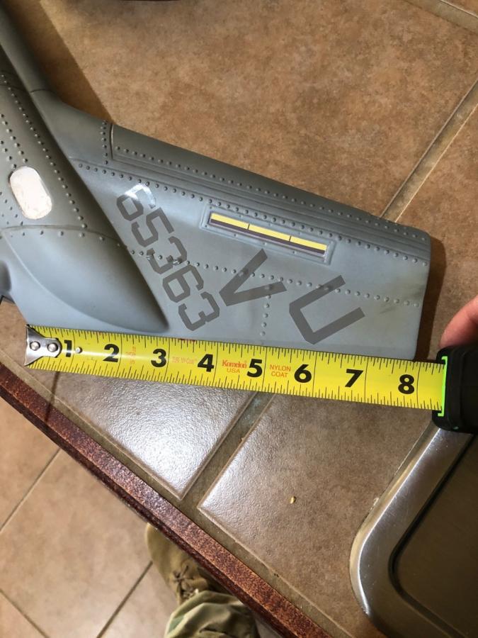

                                    • So question... I ordered a short tail tube, and when it came in it was 1"+ longer than the tube that came with mine. So now I'm curious about the the measurements etc... If you guys get a chance, shoot some measurements... I didn't measure the short tail drive shaft, I will when I get back home.... The black tube is the new tube, the silver is what came with my kit. I really need to measure the drive shaft...

                                      • Mine is assembled but I’ll measure the shaft when it comes apart again. Curious if the slop I’m feeling is due to the shaft not seating fully because the tube is too long or bevel gears need shims. Only have a couple mm’s clearance between fin top edge & tail rotor gearbox so hate to think cutting the fin for a shorter tube is only option.
                                        • So in my ongoing tail endevours, I put a complete 700 tail assembly on the tube... and the only real difference between the roban and 700 assembly was that the 700 was a little bit shorter. It took all the slop out... in fact it was going to be a little bit too tight on the drive train. But the fact that the tube I ordered came in too long.... just got me curious about how the kits are coming now.
