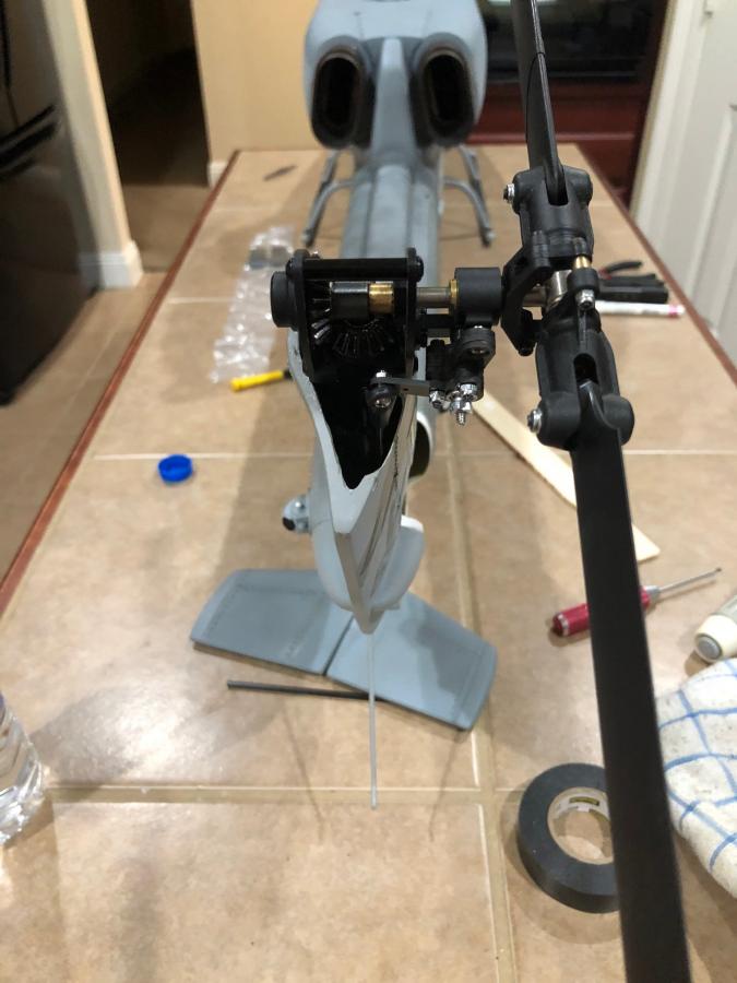

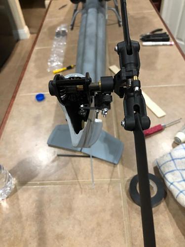

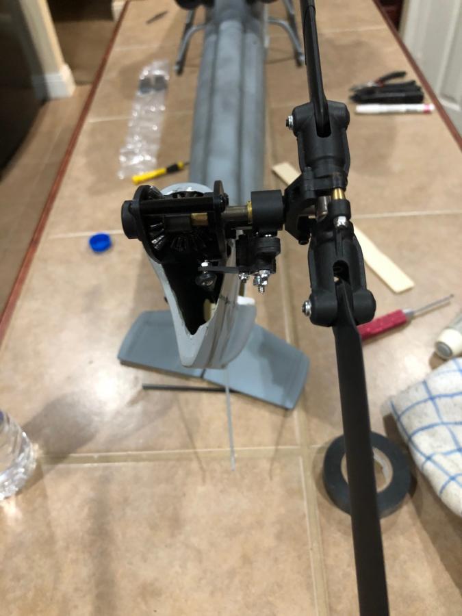

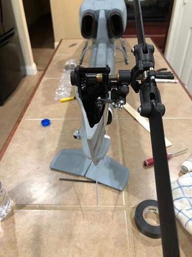

                                      So I remembered I had ordered these crank arms from microhelis.de and it can be built up kinda as tall as you needed, and set for left or right... and just so happens that the servo arm itself was a touch longer! So that's my fix for my tail pushrod!
