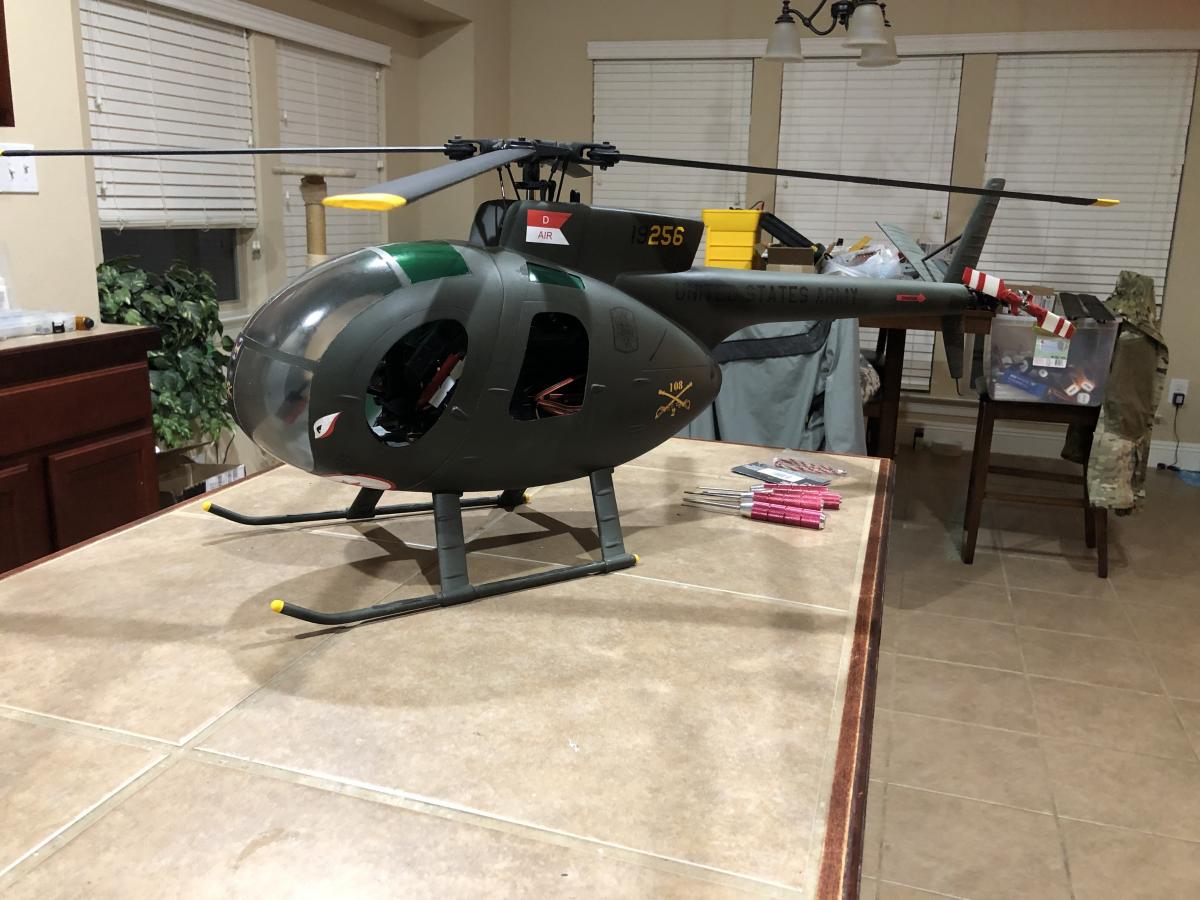

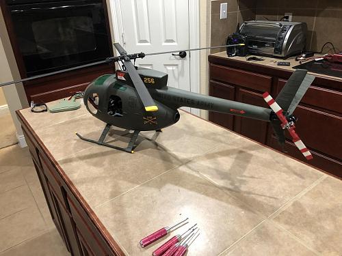

                    • #30

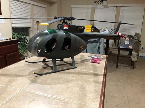

                      DC I was tinkering with you AH-6 lil cousin/old ancestor lol... I have a 500 size I have been doing up as an OH-6... I put speakers in the bottom etc lol.... I did okay with the tail... I'm satisfied lol. I see some of the guys take banana peels and a piece of Styrofoam and make an exact duplicate of a cockpit!! I just don't have those kinda skills
ID:	245754Click image for larger version
ID:	245755Click image for larger version
                      Not too bad considering it was a Magnum PI kit lol.

                        • #32
                          Click image for larger version  Name:	IMG_2859.jpg Views:	0 Size:	132.2 KB ID:	245754Click image for larger version  Name:	IMG_2862.jpg Views:	0 Size:	128.5 KB ID:	245755Click image for larger version  Name:	IMG_2863.jpg Views:	0 Size:	73.1 KB ID:	245756
                          Love it, looks awesome, I kind of do wish Roban would have done the big 800 AH-6 with the short skids like yours, but I don't have the skills to shorten them and I actually do like the tall skids on the regular Hughes 500, there are some AH-6 with the taller skids, I guess I have the rare version, flew it today actually.
                          • #33
                            I actually cut an inch off of my skids... going into the frame and the actually 'skids' lol. I've been looking at the 800 size AH6 (and there's a white navy OH6)... they just look so tall to me... like the skids seem dis-proportionally sized. Yea I saw that you had flown yours as well! I swear these roban kits should be labeled as 'you will need to purchase a dremel tool'!

                              Nice! I ended up trimming my skids by an inch on my 500 AH-6 as well. It has always confused my why they went with the tall skids on the 800 versions.

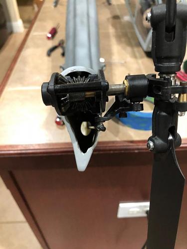

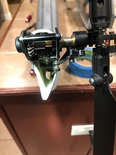

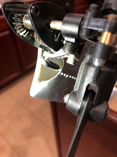

                                      So I did my first run up with the fuselage on... just looking for any crazy vibrations... seems okay. Gonna have tinker with the the upper tail rod link; its catching on the very tip of the tail piece... here goes the dremel again lol.
                                      The first speed it spools up to is 1050 which its at about the 25 thru 30 sec mark, then I pass through 1350 for about a second lol, and then the end 30-35 secs is at my throttle 2 which is 1400rpm (which I think will be my flying speed).
                                      • #39

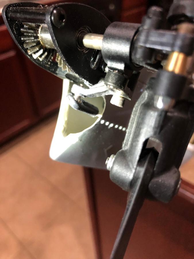

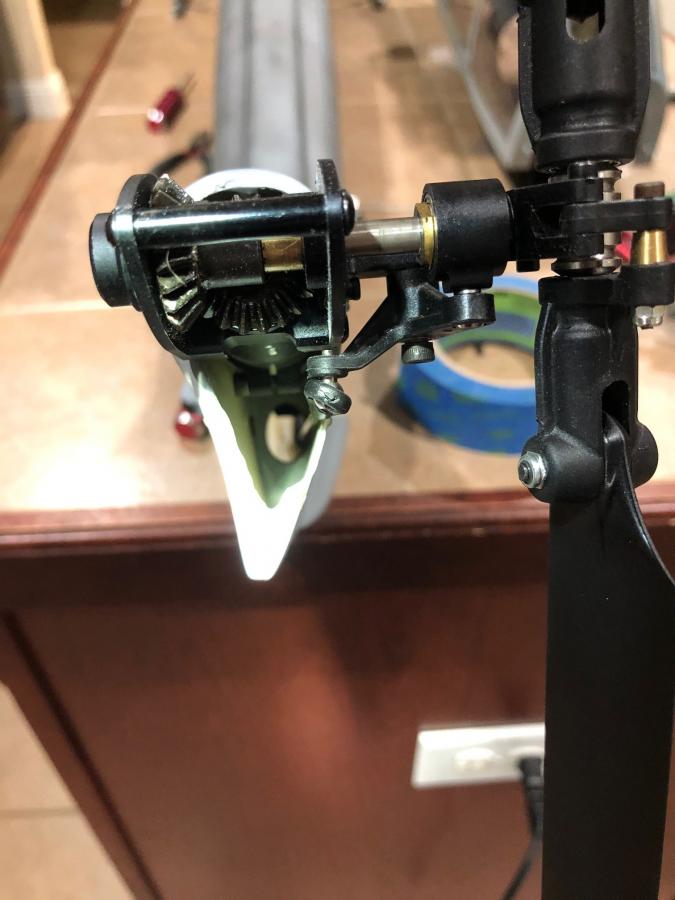

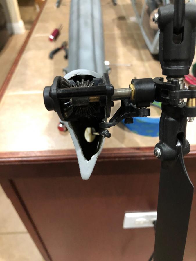

                                        The upper tail pushrod catching at the very top... It's like the boom is just a hair off center. I dremeled a little bit off already, but it's still touching.

                                        • #40
ID:	245898Click image for larger version
ID:	245899Click image for larger version
                                          Sounds great to me, but looks like one of the reasons the rod is hittiing maybe, you need to square up your tail rotor shaft with the fuselage, that will swing the control rod back to the left, the whole tail unit looks off to me, I had the same problem with my Roban Bell 212, but it just needed a little dremel work at the top of the fuselage, had a little lip on it and was snagging the linkage also I put some foam around the top of the boom and a little more on the right side and this pushed the boom over a little to clear the linkage even more plus I always add foam anway to help dampen any vibes back in the tail section, just make sure you don't stuff to much and jam the rod.
