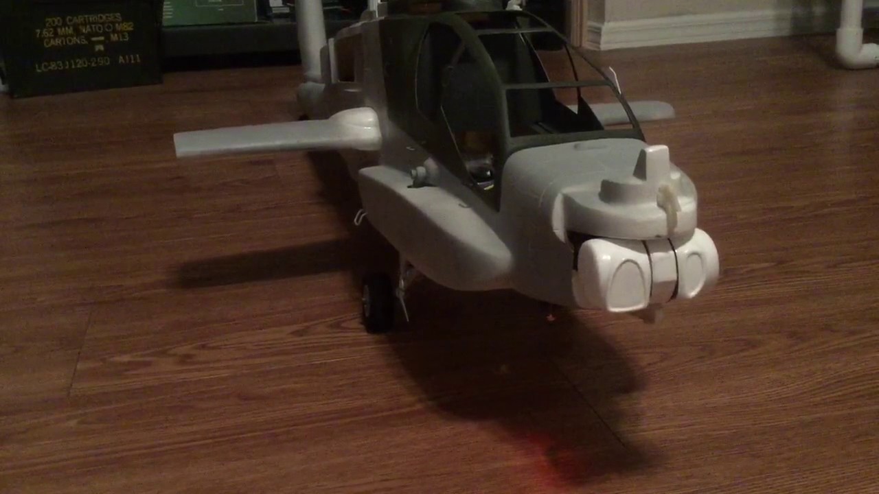

                            Added a few more details. Flare dispenser, antennas, and wire cutters for the most part. Also started hollowing out a few parts on the nose to make rooms for a movable TADS unit. Getting close to painting!
                              • 2818
                              • Arlington, TX
                              After a long night of rewiring and getting the swivels to work properly, the TADS can finally tilt up and down successfully! Now I have to get it installed in the nose, and set up the servo for panning.

                                    Thanks guys! Just got the TADS finished and working. Time to get the gun set up now!
