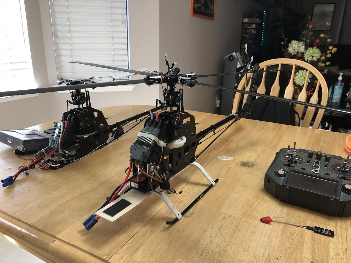

                                • So flew my 500 mechanics this last weekend.
                                  has the 900kv motor with a 16T pinion. She flew and sounded great. Only thing that bugged me was that I was running at 90% throttle (roughly 1800 rpm head speed).
                                  so I had a 3026 1210kv scorpion. but wasn’t to sure about running the smaller can older scorpion motor so I bought a 3226 1400kv. It showed up yesterday. To get 1800 at around 70% throttle I used a 14T pinion.
                                  put two batteries through it today after work. I Wasn’t happy. It was loud. Also the motor and ESC were warm. Not hot but warm.
                                  so I switch it out with the 3026 1210kv using the 16T pinion. That’s The the ticket. Really quiet and smooth. I only did a quick hover. Tomorrow after work I’ll put two batteries through her. If she good, I’ll start the dry fit mounting so I can get all the mounting holes and headwear figured out.
                                  after that I can finish adding all my printed parts and paint her up.
                                  so yeah it’s about a month out now.
                                  Gravy

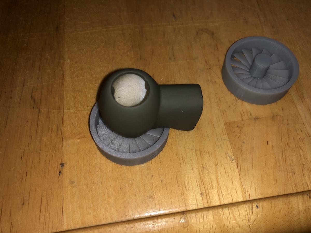

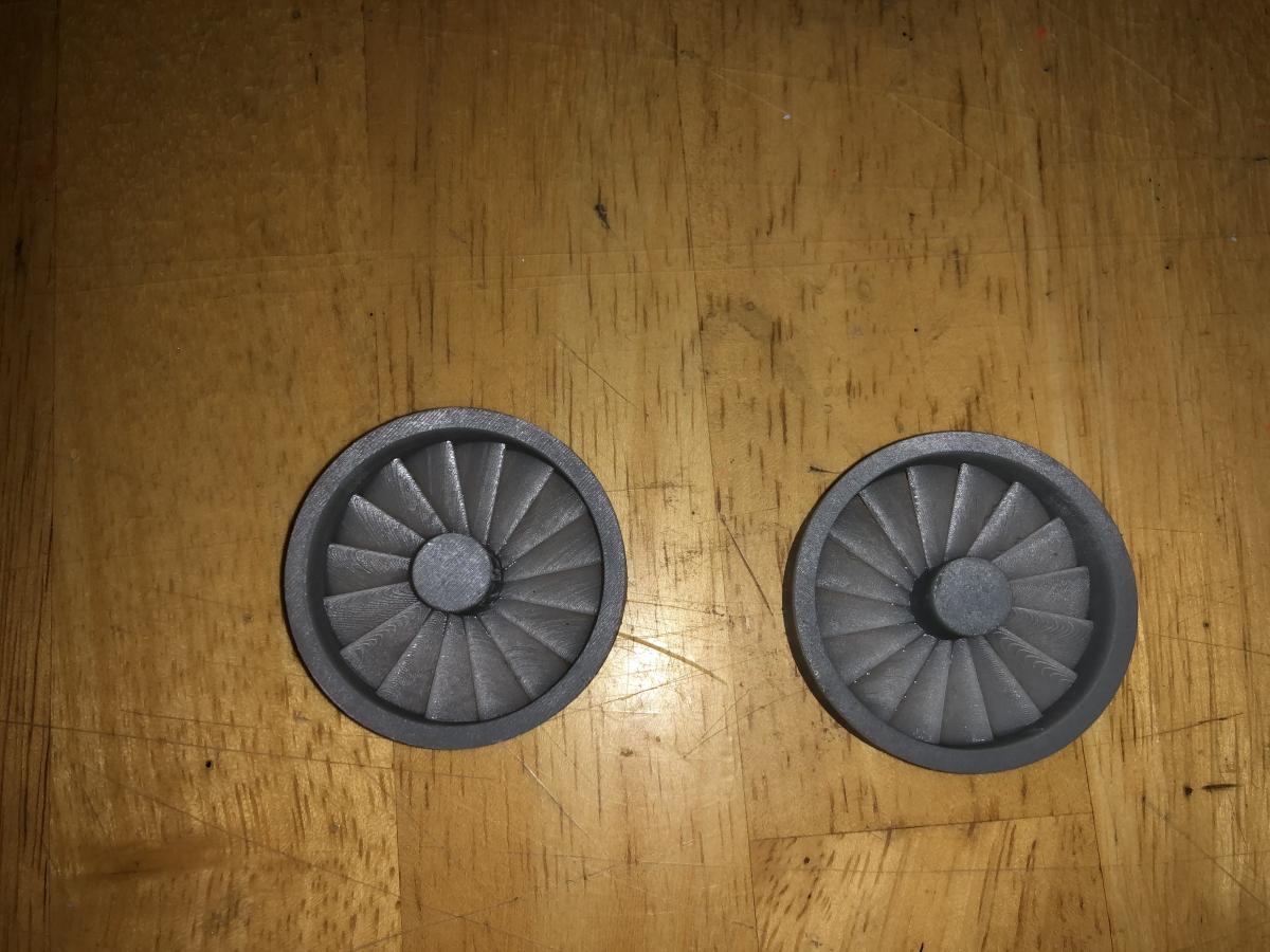

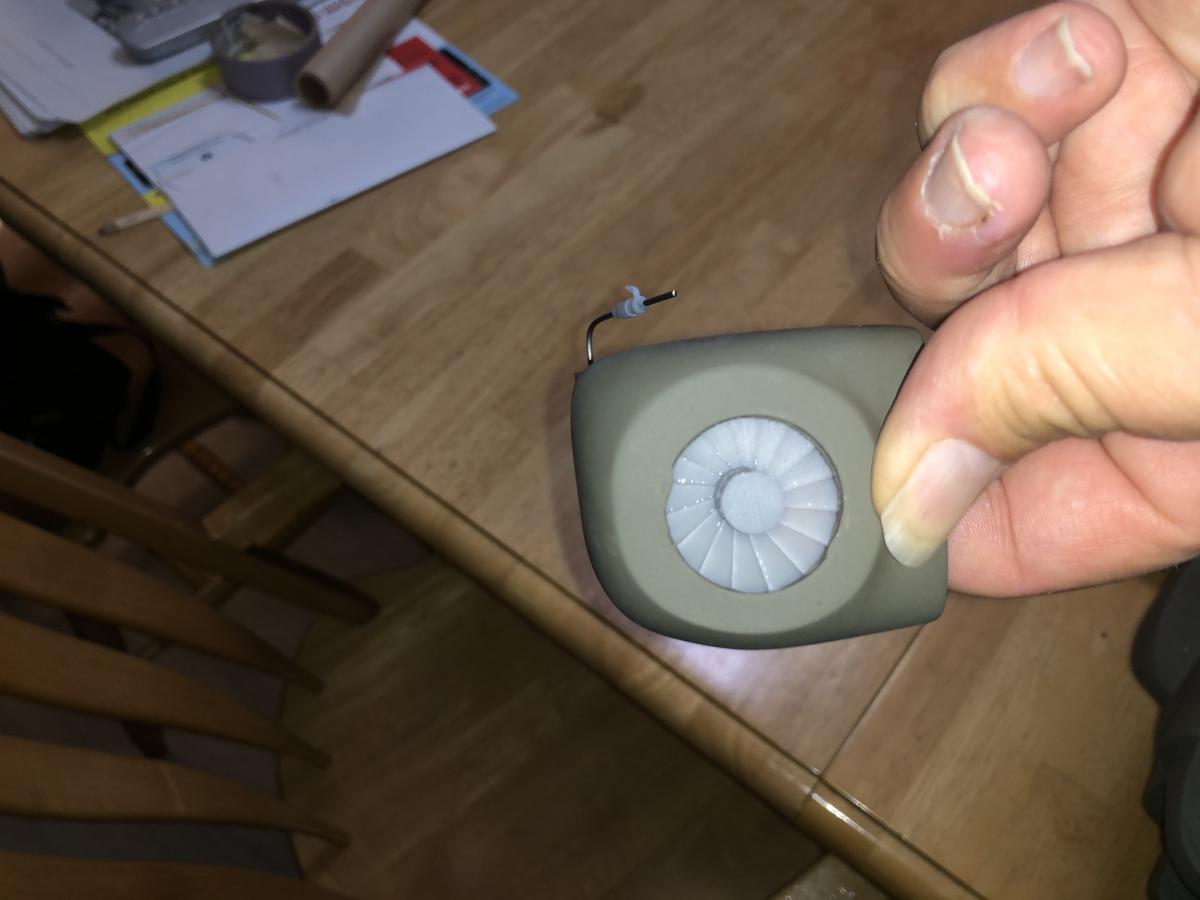

                                    • Some printed turbine blades.
                                      gravy

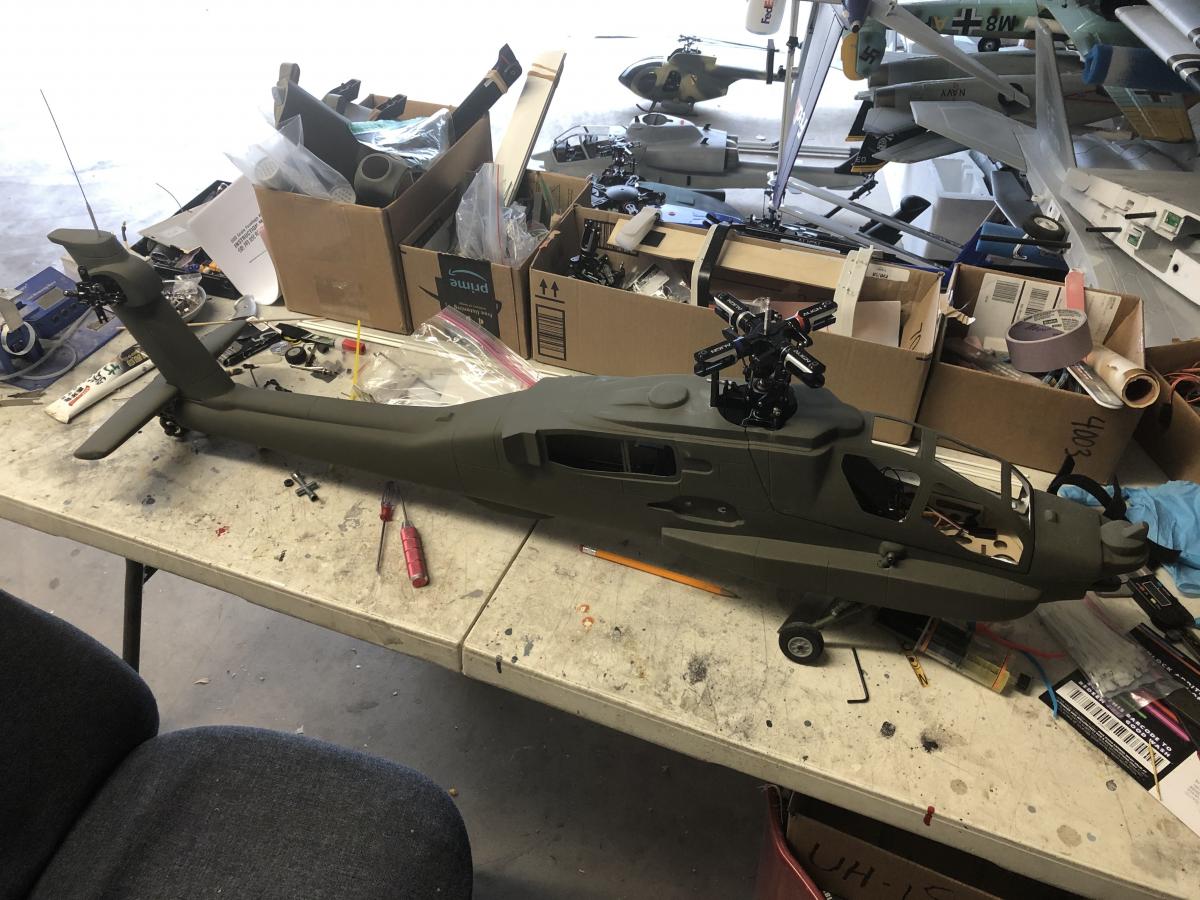

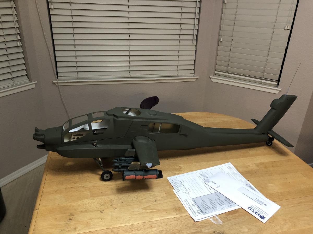

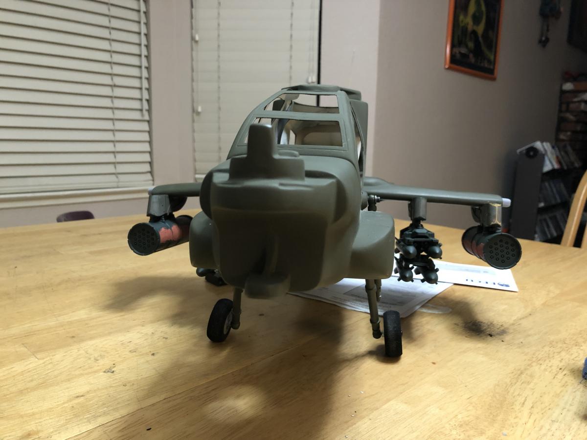

                                      • First dry fit. Once I get the holes lined up and drilled for the attachment I’ll pull it out and start working on the body. I’m not getting as crazy as you FDD so it shouldn’t be longer than a week or two.
                                        Gravy
