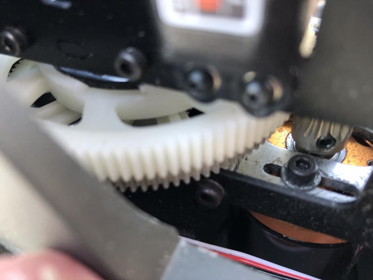

They looked good last time I checked, that was before today’s flight and 1 hover ago. So about 4 hovers flights and one let it loose flights on this set. I change out fir new set when I figured out all my issues and put it all back in the fuse. The least set is still really good with a little revers belling due to the old pinion gear not sitting right on the shaft. I’ll get a picture of the gear tomorrow and post it, the one in the Heli currently. But ever since I freed up my tail drive system she don’t seam to put to much load on it. I’m also running higher Kv but lower RPM’s then yours.

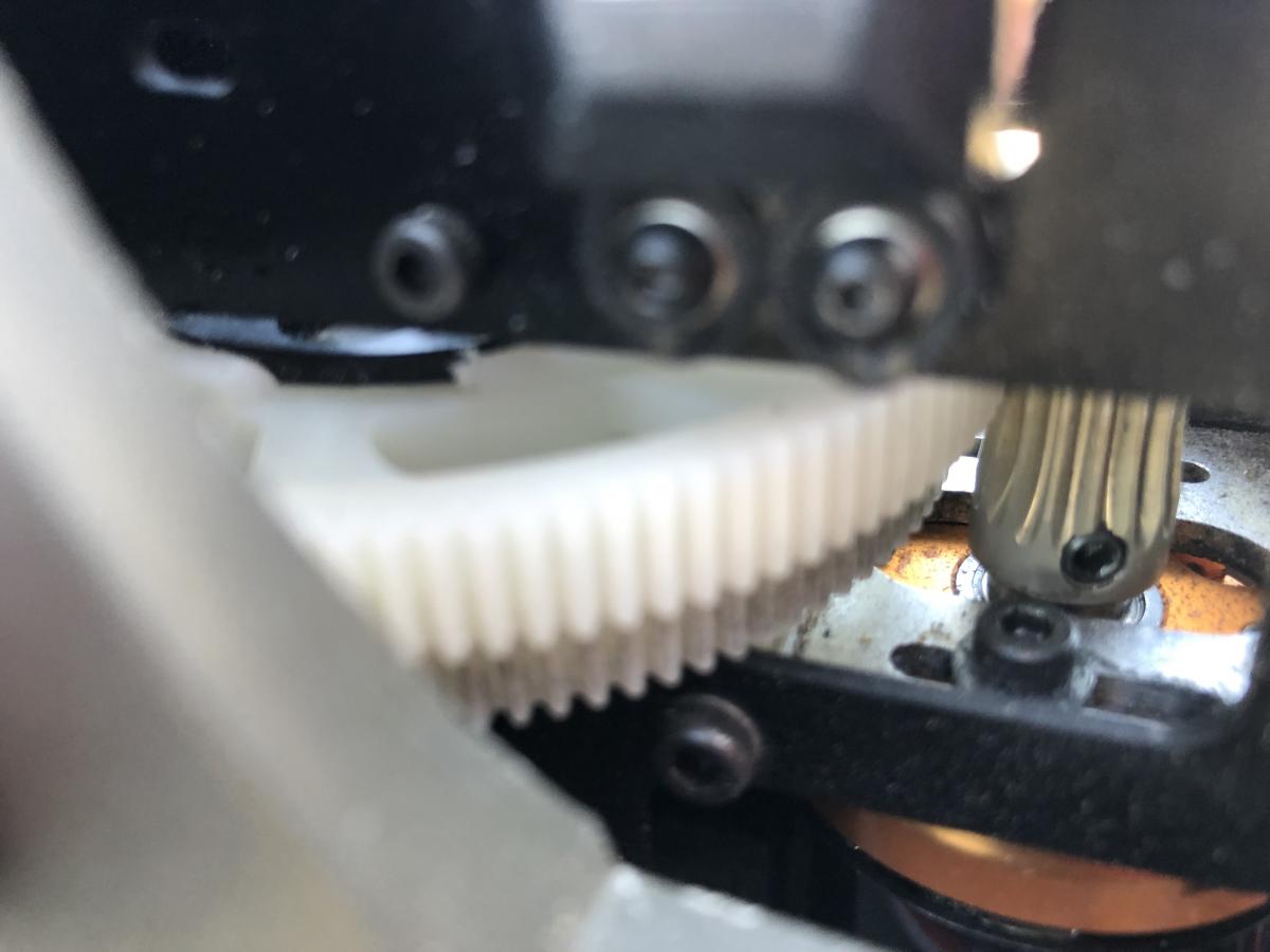

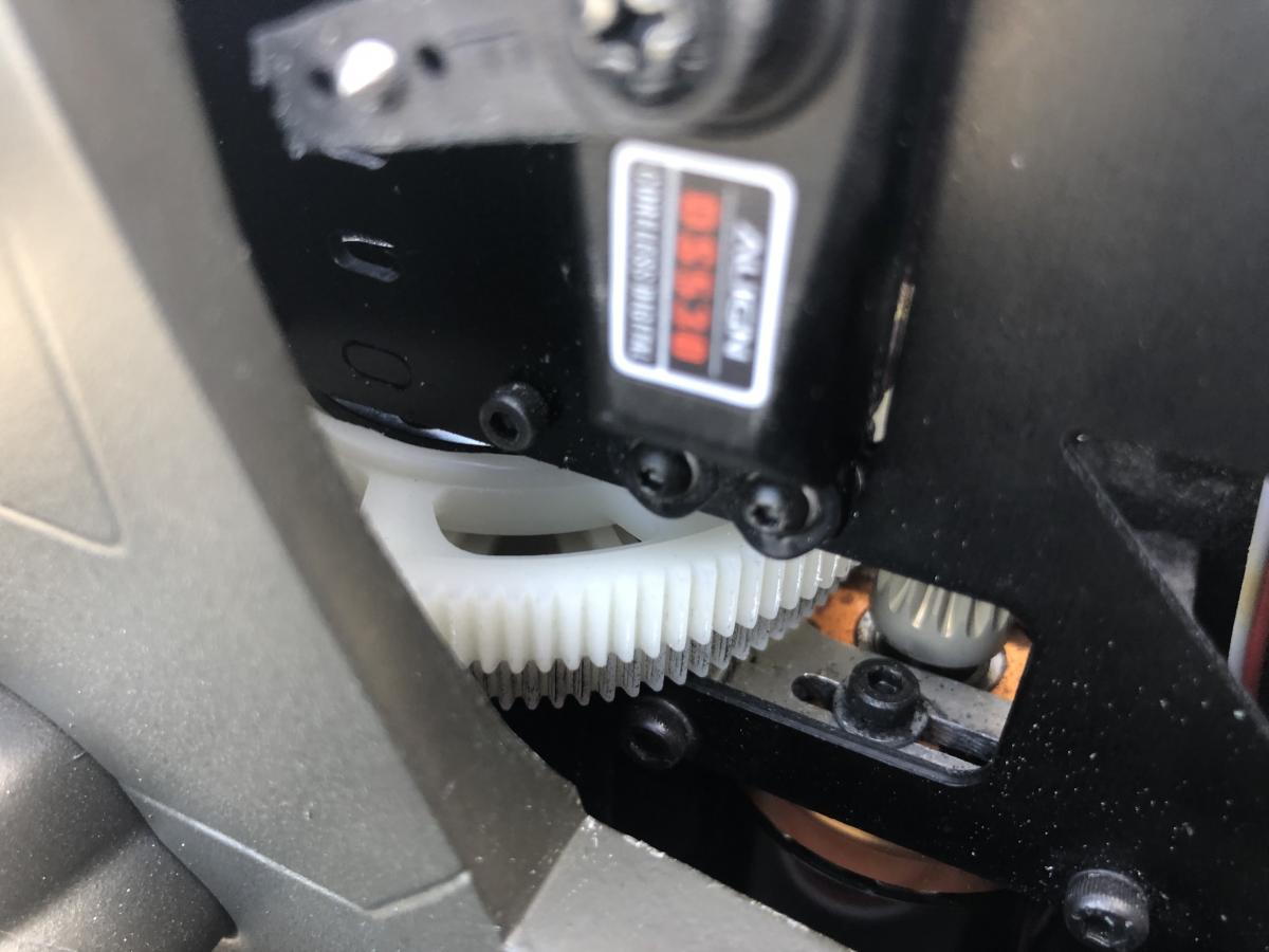

Ok got a video of today’s flight.
I used a 5000mah 4s and had 45% left after flight.
also took picture of main gear after flight.

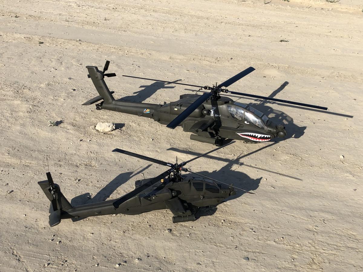

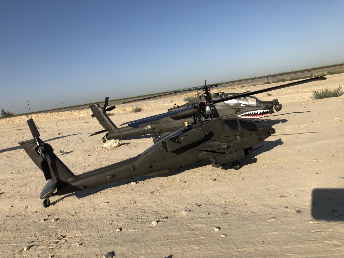

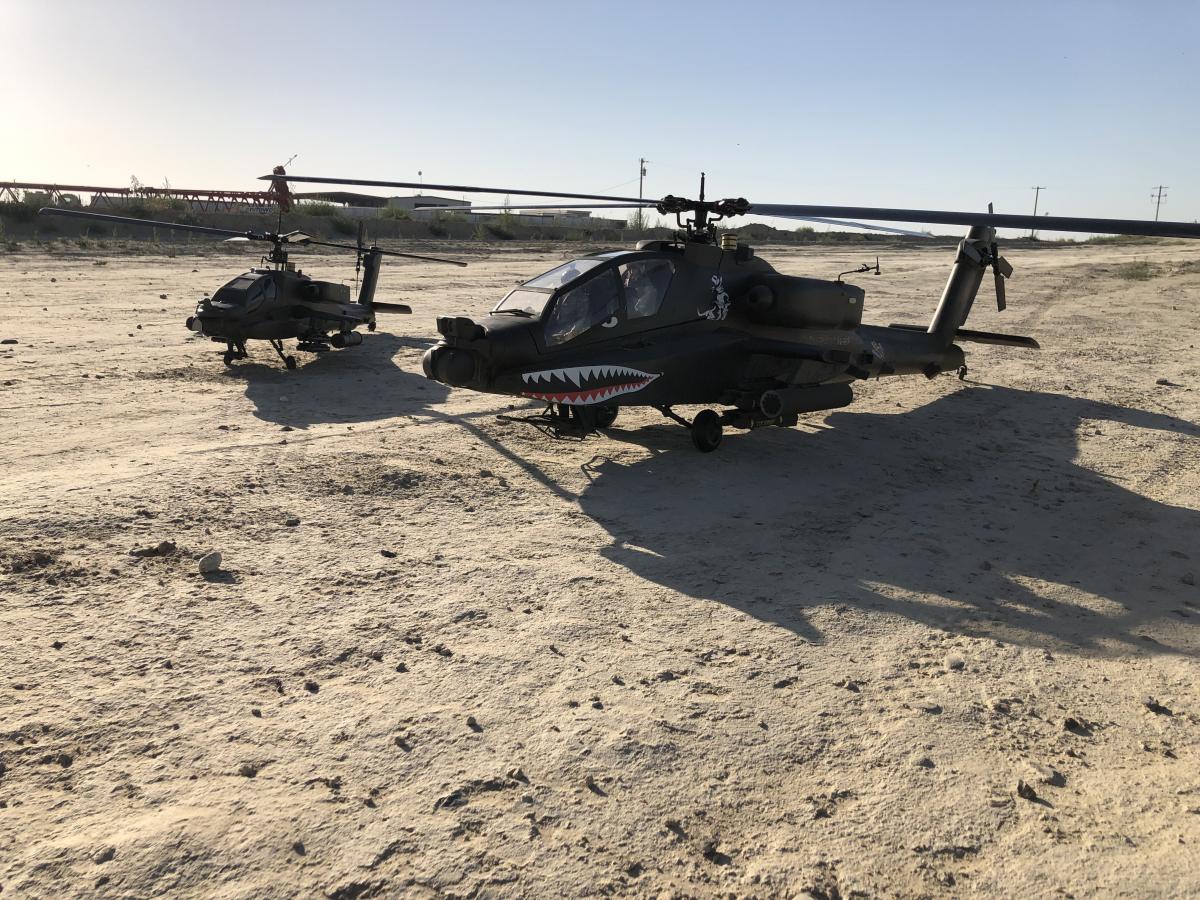

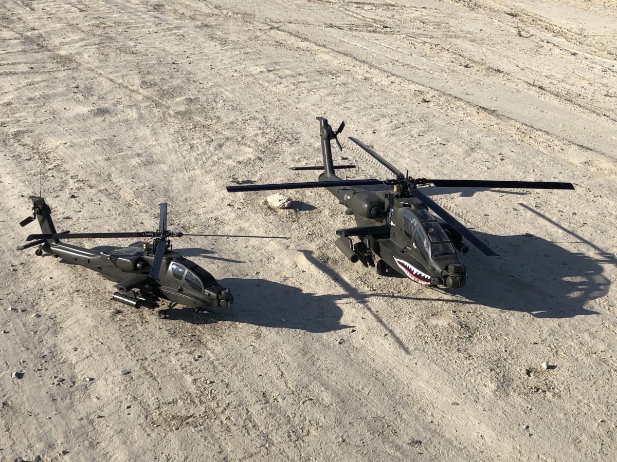

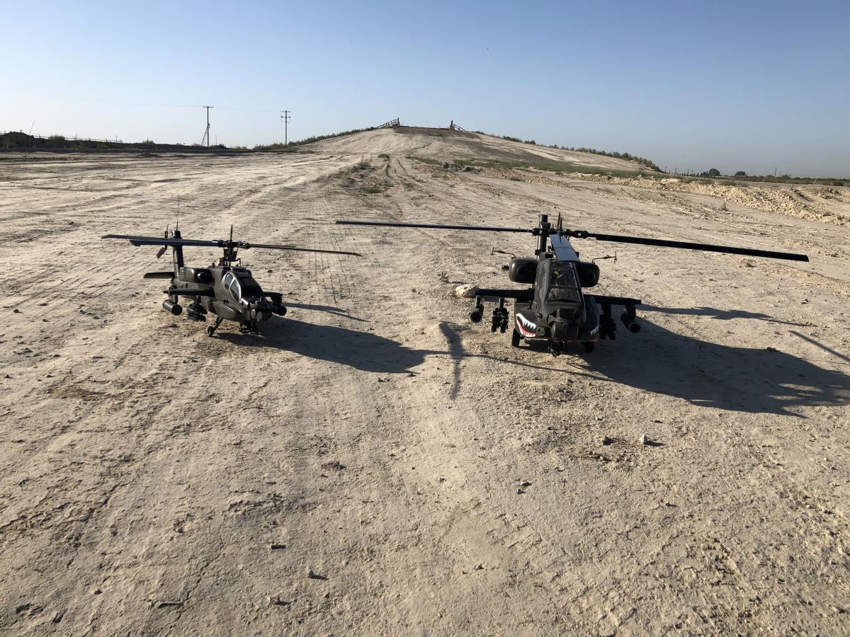

Went flying today at DCORSAIR’s place. We got the boys together.
my 500 AH-64 flew great. I got my dialed in after the 1st quick flight which I’ll post later along with his 700 AH-64.
or mine I added 3 clicks of forward stick trim to the microbeast and she flew on rails.
I got three more flights in her or a total of 12 minutes. 1st flight was quick make adj then send her.
after that it was flown hard and put away wet.
gears still look good, I’m not seeing any signs of wear yet.
looks like we might have figured out my shake issue on my cobra. I’ll know for sure after some adjustments and post in that thread.
good day to fly the Apaches though.
Gravy.Comment
Wow, nice pics of them together, next time we might get someone to record a flight together in the air, glad you came over and you got that 500 Apache dialed in nicely, not one vibe what so ever, your hardworking building skills and 3D printing skills are really showing off in that Apache, and that Cobra looks awesome as well, it's still my favorite, I did notice you kept a close eye on it when I was touching her and adjusting those blades.
