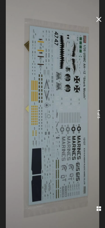

                      • Any idea what scale this frame is? I’m guessing 1:16 but haven’t ran numbers. I’m looking at ordering some decals from Cali and just want to make sure what scale I need to tell her.
                        Gravy
                        • Originally posted by Gravythe clown View Post
                          Gravy
                          A quick measurement shows 40.5” nose to tail, so around 1/14.5 scale. If you’d like, after work tomorrow I can send you the markings that I used. Took a lot of research to find all of the small text warnings and markings around the nose and FLIR. They should also be scaled correctly as-is. I printed mine out on clear testors decals paper to conform over the rivets better.
                          • Thanks for the scale. No need on the markings, I’m not getting as detailed as you did. I bought a set of decals for a 1:35 model. I’m going to make a high detail scan to send off to Cali. I bought some testors decal paper that I might try. I do like the water slid better than the vinyl.
                            Gravy
