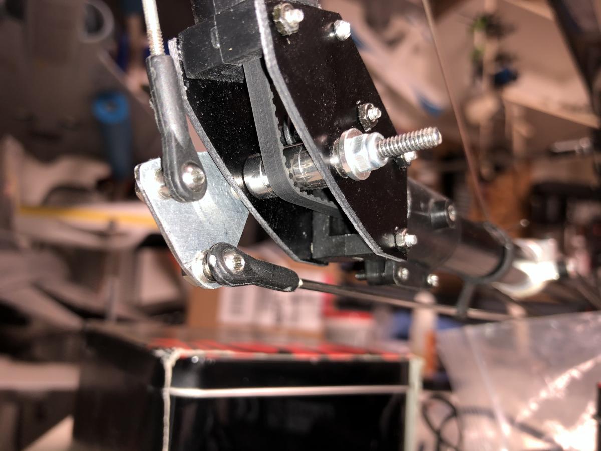

              • Pawpaw take a really good look at the tail transition piece. After making my metal replacement for the control rod setup, I noticed a bunch of heat today after a test run up. Don’t like how any of that is setup. So I replaced the whole pulley setup with 4 bearing. What a difference that made. The whole tail drive is like silky smooth now.

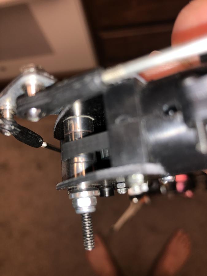

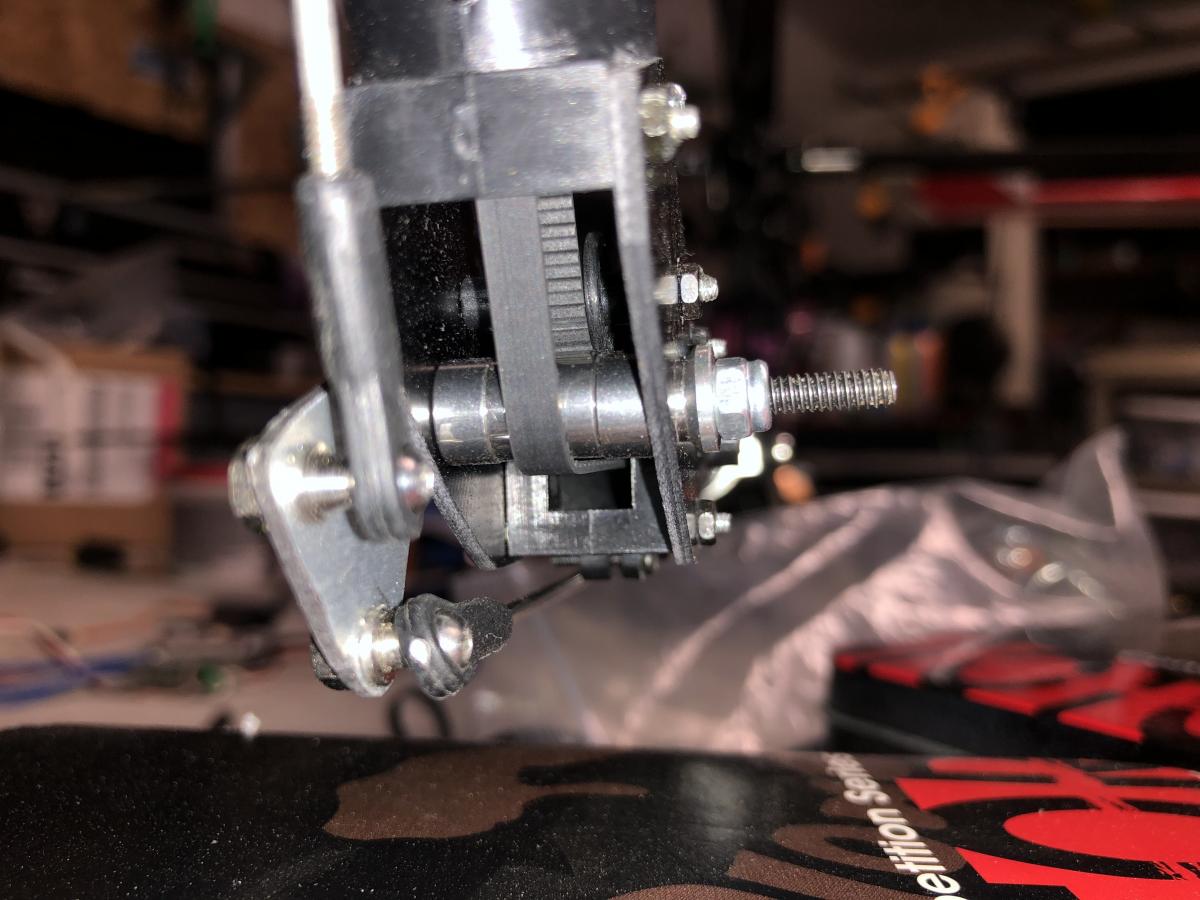

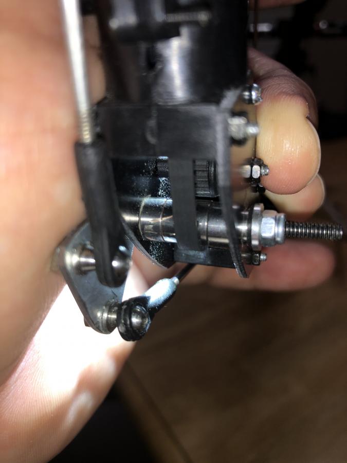

                • Maybe it’s my perspective of the pic, but looks like the belt is in contact with both sides of the lower bearing and is getting pinched between the upper pulley? I’m not as far along as you, but I just ran my mechs up to 1700 for a few minutes and my tail just gets lukewarm. Feels like it’s the belt, not the pulley. What 4 blade tail unit are you using? I bought a Chinese one off Ebay and still not sure if I can even use it....blades don’t track 100%....and will prob need to fab new links if I don’t trash it first.
                  • Yeah it’s prospective. There is a nice gap between the top (entering) belt and the bottom (returning belt bearings). The whole drive system is very smooth now, where in the past it was always tight.
                    took extra pics but really hard to see the gap in the pic but it’s there and about 2mm.

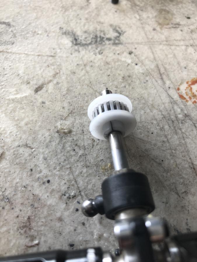

                            I might still have the original belt unit that came with mine if you need it.

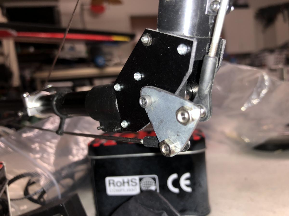

                                  yes but then the triangle control rod piece started to act up as the mount hole got oblong. This started all the tail control issues.
                                  my guess is that because I changed out for a metal triangle piece that really brought to life the issue with the pulley section. To me it’s just a bad design. That pulley should ride free on its shaft, not be the shaft that the triangle piece screws onto.
                                  but I’m really happy now with my bee set up and honestly it’s never felt smoother. The whole drive assemble is just tits right now.

                                    • The tail pushrod control setup could definitely be engineered better. I like your bearing shaft solution. Looks like I will be following F106’s lead and fab my own 4 blade tail hub...way too much vibration with this Chinese hub.
