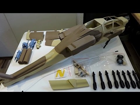

          • Hello gentlemen,
            I have been reading this thread to get familiar with the building of the Apache. I recently bought one (Not the RC Aerodyne scale fuselage kit) but a "copy" of it? who knows. Looks familiar but it has some unscaled looking bumps to fit the main gear. I wish I had done research on it before pulling the trigger. Unfortunately it didn't come with the side frames that lower the tail boom and raised tail kit. I bought everything (Torque tube) I needed to try and build it but one of the parts (raise tail) will not work with the Apache. The tail part is meant for theUH-60 500 Scale & AH-1 500 Scale. I know F106DeltaDart used a Torque tube drive setup? Can you point me to the one you used? Or even the tail conversion. Any help is appreciated. Thanks guys. Happy flying/ Building.
            This one looks similar to the one I bought. I found this picture on google.
Name:	Desert Apache Fuselage .jpeg
            • Unfortunately, the gearbox setup I used is discontinued. Used to be made by a company called smartmodel: http://www.electric-rc-helicopter.co...ive-t5433.html. I had to mode the side panels to get the higher angle required for the Apache tail.
              • F106DeltaDart, thanks for getting back to me. I'll just wait and hopefully someone starts making more or make my own.
