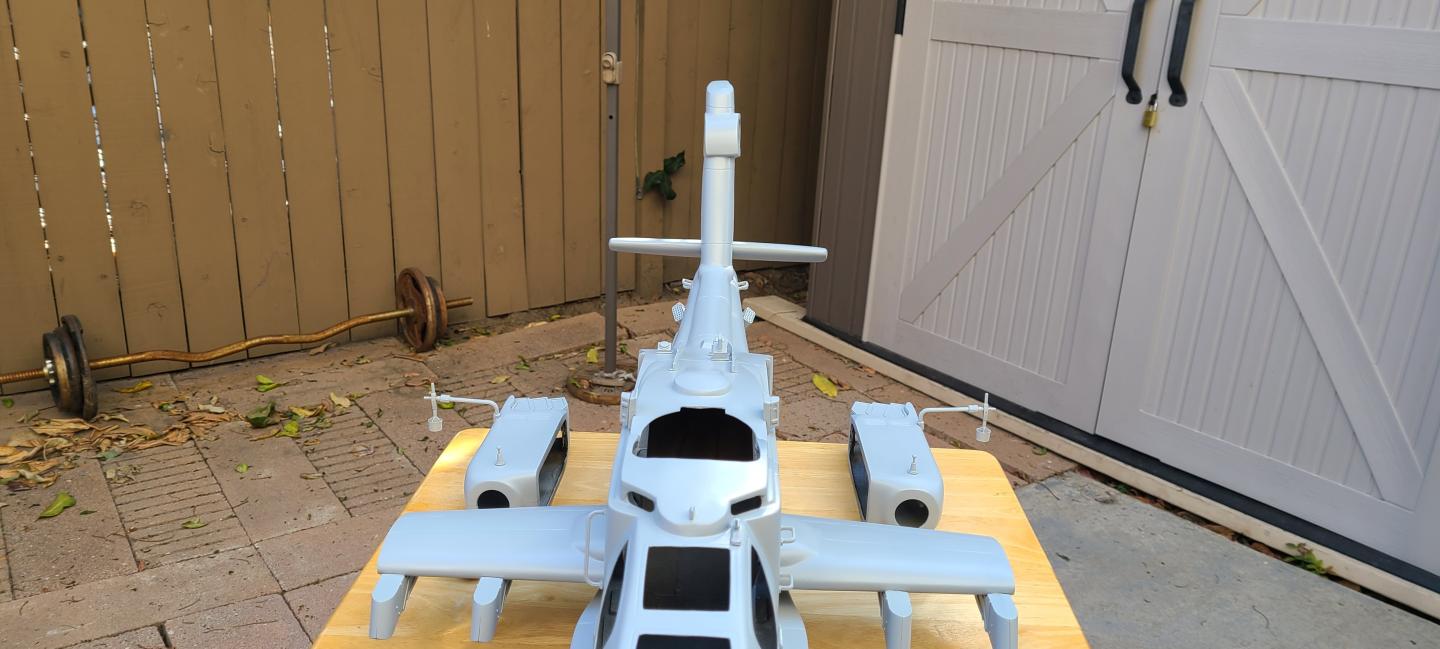

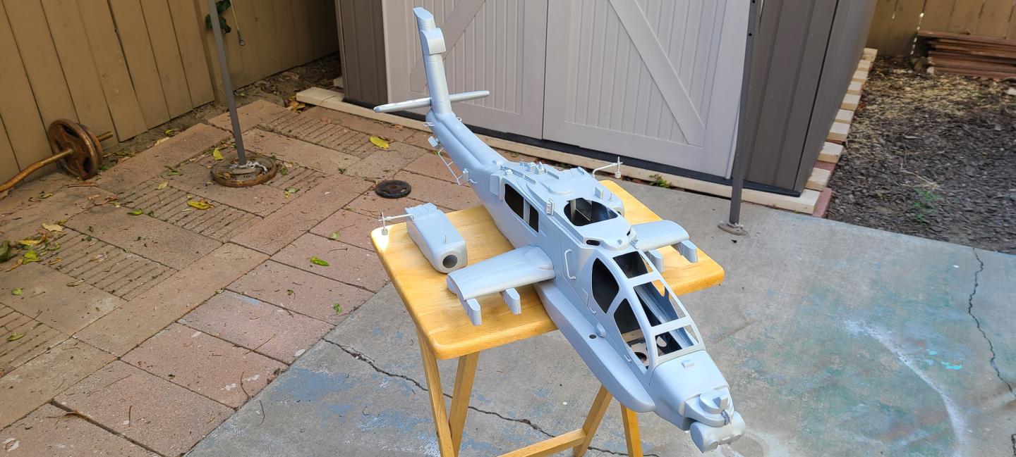

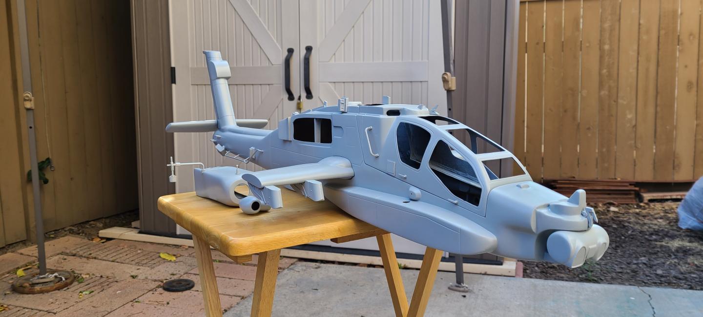

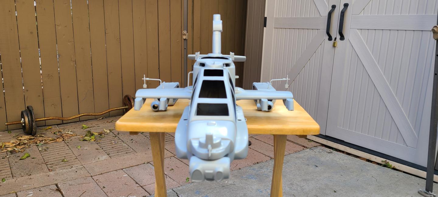

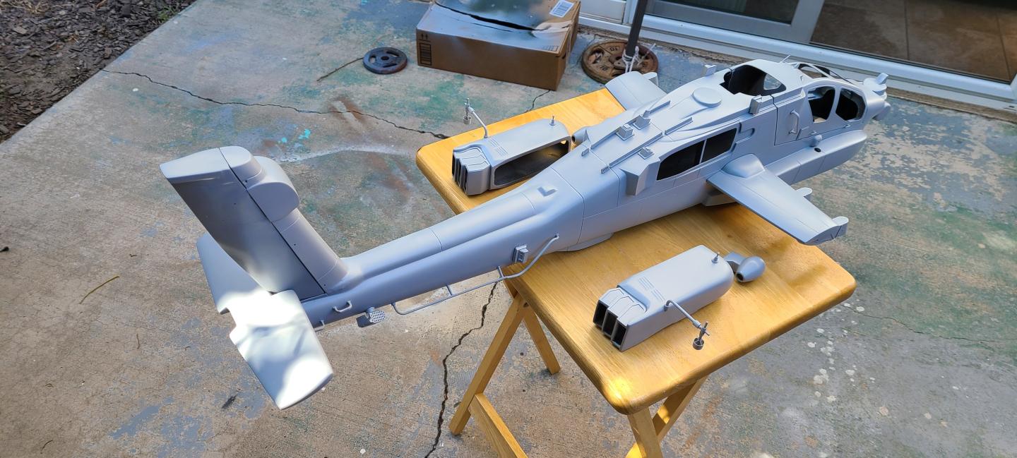

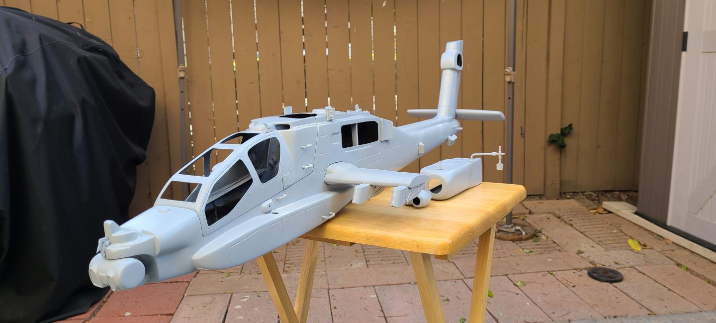

                                          Hey guys,

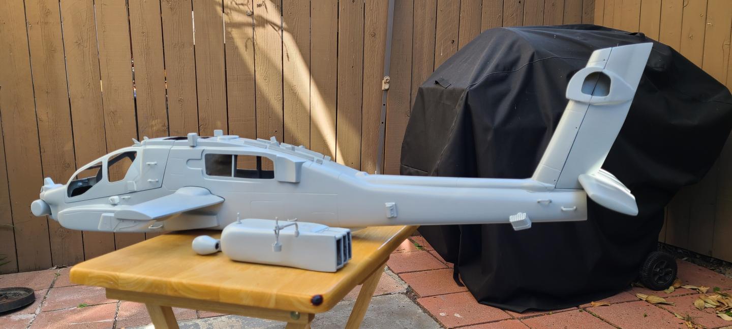

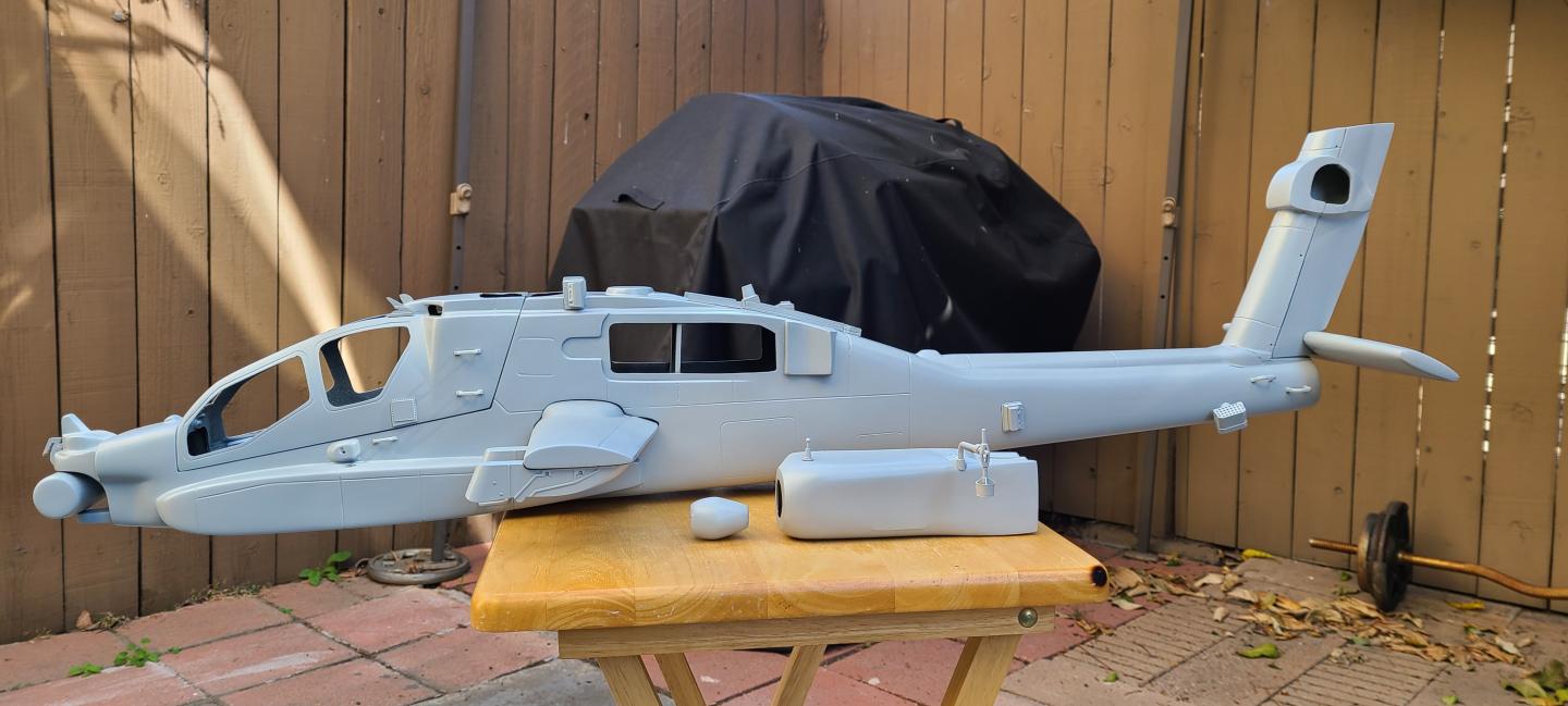

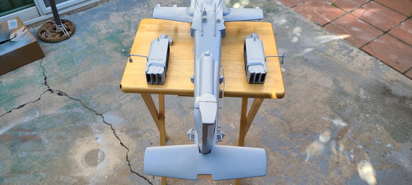

                                          Here are some pictures of my Apache still in the works. With the help from Delta and Gravy I have been able to get to this point. I have read over and over this thread to make sure i get it to work. I still have to figure out how to paint it with an airbrush. This is my very first project so I've had to purchase many things I need to accomplish this. I have already test flown the mechanics. I'm TT and it seemed tail heavy even with a 3300Mah battery all the way in the front. I will update again soon once painted. Im taking it easy so it will be a few days. Thank you guys!
                                          I know I went crazy with all the extra stuff I added. I still got more to add. lol
