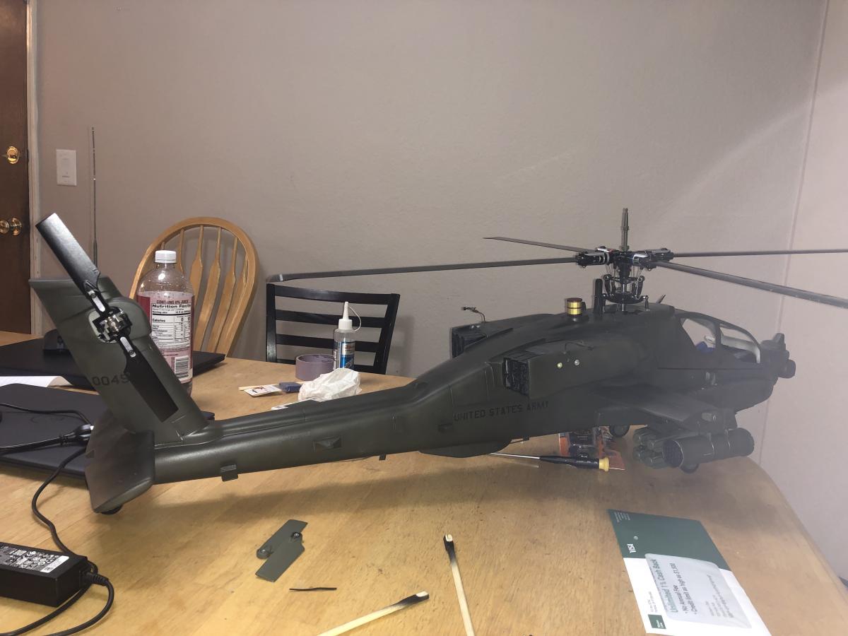

          • Tonight she flew in the fuse. Just a small hover but it was strong. I need a little more tail authority, which I have more to give, but other than a small adj she’s almost ready for full flight.
            Gravy
            • New 78mm tail feathers did the trick. I’m going to stick with the two blade tail rotor setup as it feels liked in during hover.
              I need to pull her out one more time to move the microbeast and re-bind it to my external module, clean up some minor body issues and attach the weapons. She will be ready for full flight this weekend.

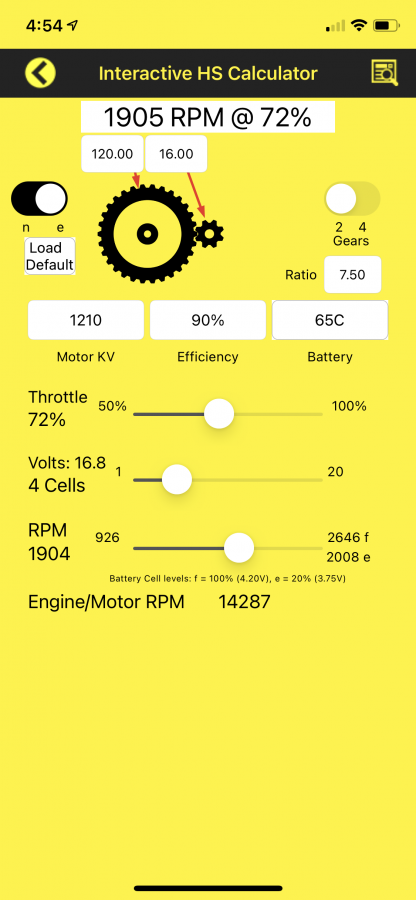

              4s 5000, 1210kv, 16t pinion,72% calibrated throttle. 1900rpm head speed.
              sound good and feels good, lifts off right at mid stick.

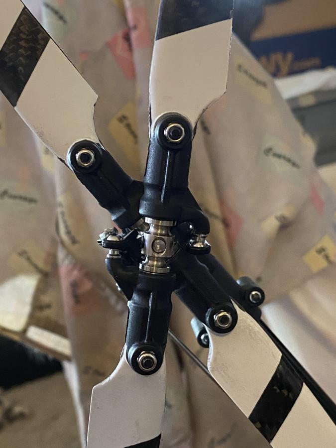

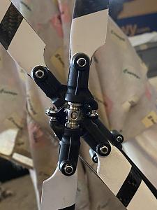

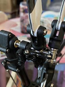

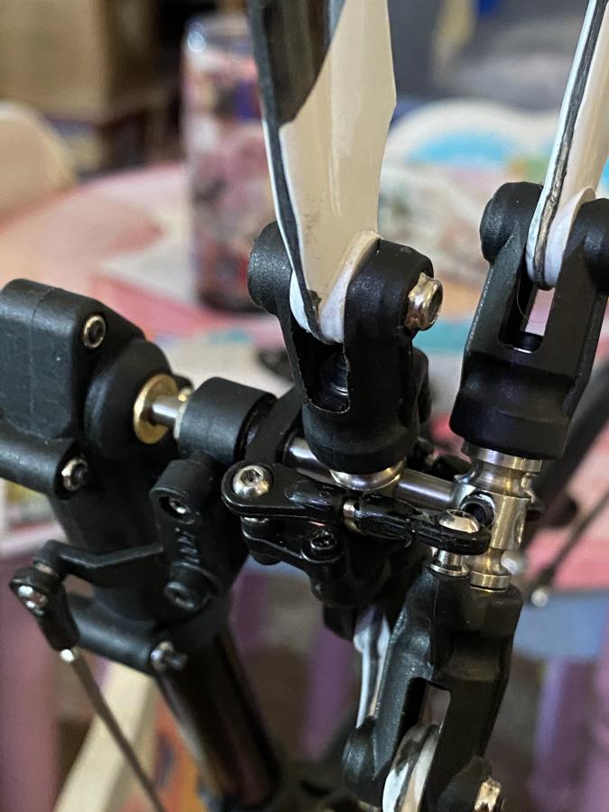

                  • No hurry on the parts...I’m bouncing between several projects trying to get caught up. I think I have the same 4 blade tail hub from Ebay (China) that you were using but mine was drilled wrong on one ear so tracking was impossible for that blade. I basically duplicated F106’s 4 blade setup with a few minor differences. Just waiting on the new 70mm blades now. Click image for larger version

                    • Where did you get the longer shaft?
                      • Bought a 10 pack of 4mm x 100mm shafts from Amazon. Got plenty if you decide to make one. In fact, I have all the parts to make another one except I’m short 1 grip assembly. We’ll see how it flies when the blades arrive this week.

                          • Got my mechanics in the fuse for the 1st time and think I will take F106’s lead...again...and work on a shorter main shaft. Just too much sticking out the top to suit me. Maybe if I stare at it long enough it will look better?
                            • I originally went with a shorter shaft but then went back. I lost to much movement with my swash.
                              There are things I’m making concessions on so it flies better. In the end I want to fly the crap out of it.
                              Gravy

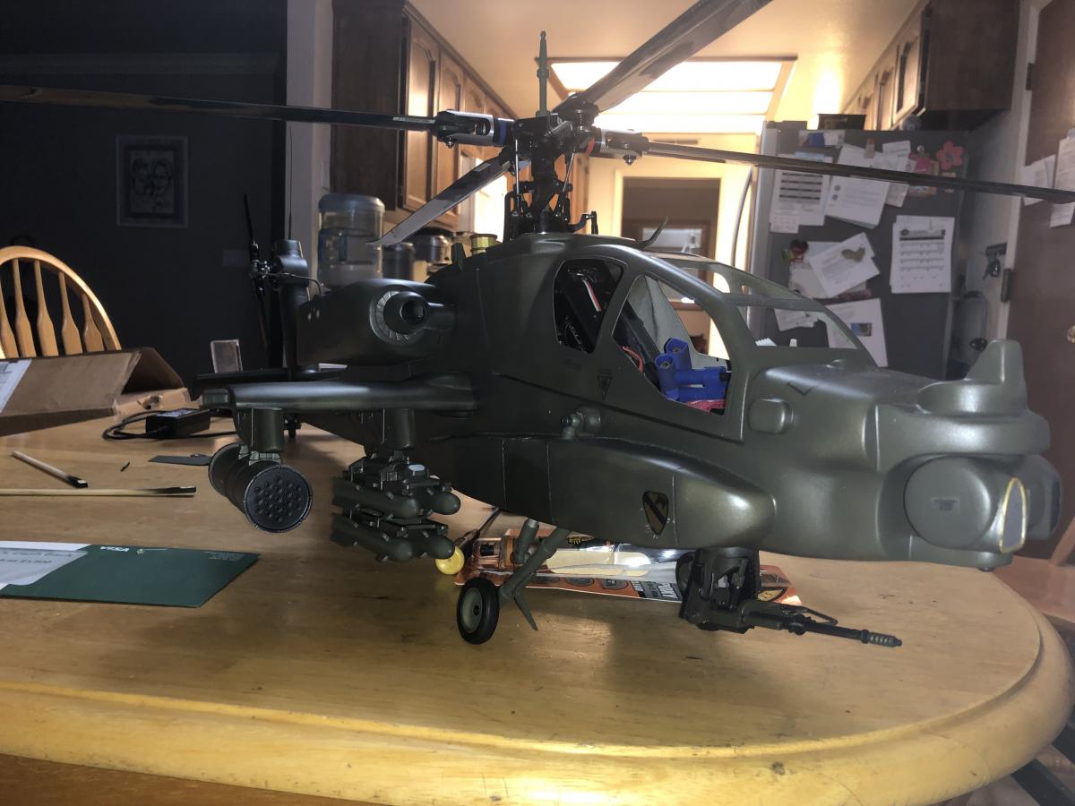

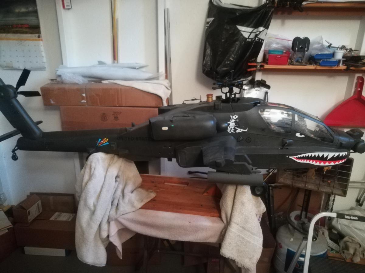

                              • I’m calling 99% done. Only thing to do is attach the windows.
                                Gravy
                                • Looks great!

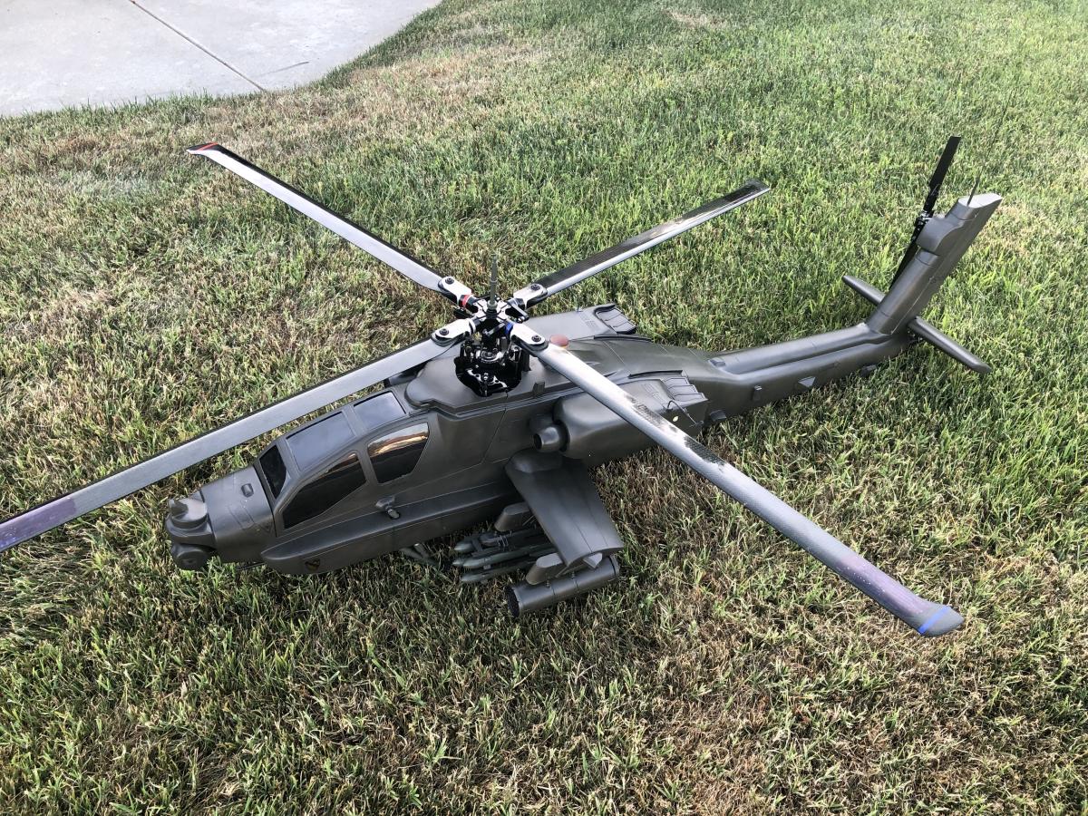

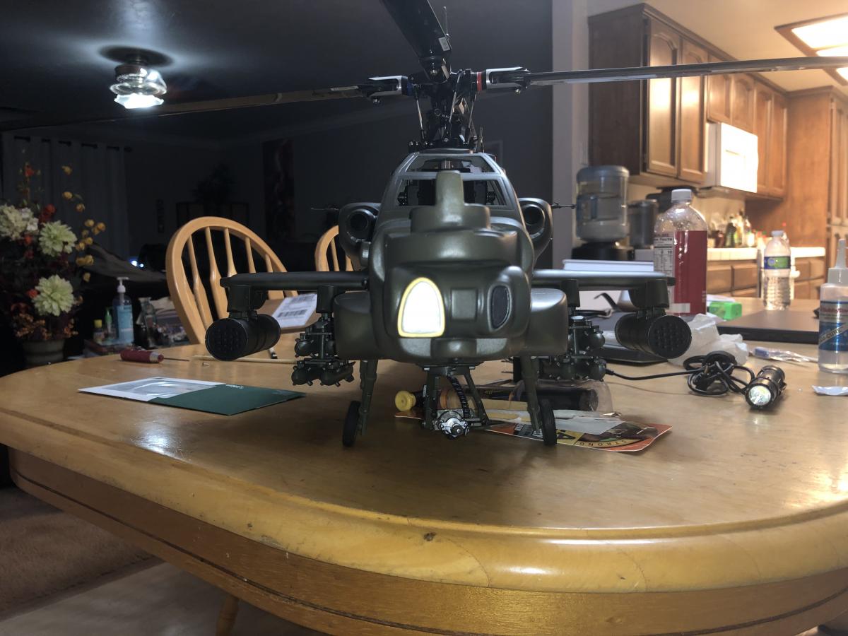

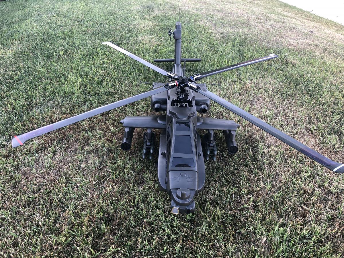

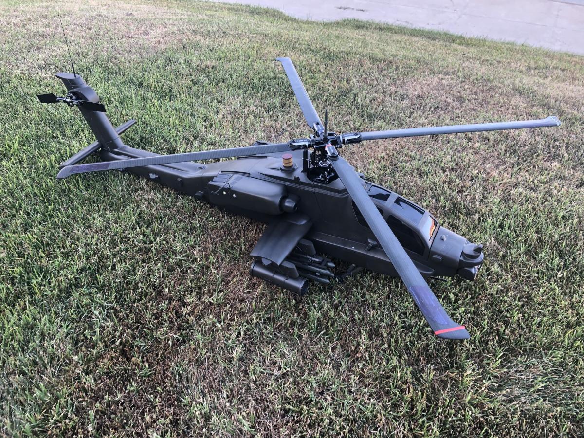

                                  • She’s 100% done and ready for 1st mission,
                                    hopefully tomorrow.
                                    FYI I found double side led carpet tape worked really great to put windows in. I cut small strips and outlined the inside of the window frames. Peeled off the outside and stuck the window in. Worked great. No glue smudges.
                                    Gravy
                                    • Woohoo, looking good....
                                      • Got to see Gravys Apache in person today, it looks even better than the pics and he hovered it for me as well, nice and smooth too, he also showed me the 3D printed parts he made for it as well as the parts for yours PawPaw, your going to be happy with them for sure, I dropped off my OH-6 for paint, which is why I was there today.
                                        • It does look great, don’t it? I was trying to shame sfcfury into going pro with his painting skills but he not having any part of it. My new tactic will be to send him a pic of one of my mangy dog paint jobs to see if he has a conscience. 🤣
