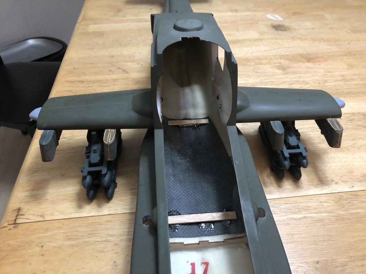

                          Hey FDD, what method did you use to mount the mechanics into the body?
                          I plan on using a spare 500 bottom plate laid on the outs side to mark my holes. But after that I haven’t figured out yet if I need to add some wood popsicles sticks on the inside or just the screws and washers like it shows from the outside to the frame. That just don’t legit. Care to share what you did?
                          thanks

                            I expoxied some 1/4” ply blocks with blind nuts to the inside of the fuselage to mount it in the front, made some 90 degree brackets, and bolted them in. The back fit like a glove for me, and I never saw a need for any aft mounts for the mechanics.

                                  Started abusing epoxy tonight. She getting close. I finally decided how to mount it. I did the manual way with screws from the bottom. I added some popsicles sticks to for extra support. After tonight’s epoxy is dry tomorrow I will fit mechanics in again. Then it’s all about wet sand then add the rest of all my 3D printed parts. Finish up with paint.
                                  so I’m about two to three weeks out.

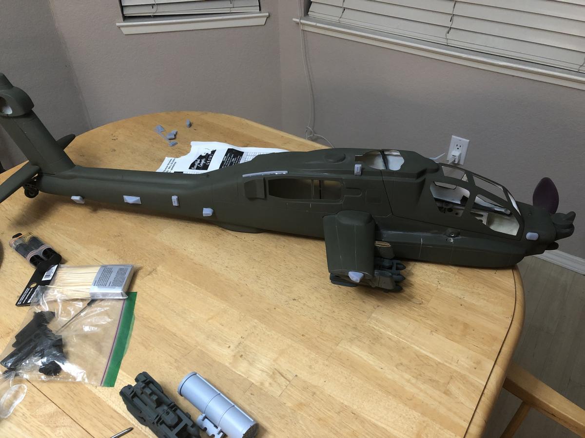

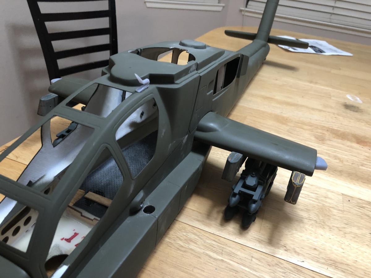

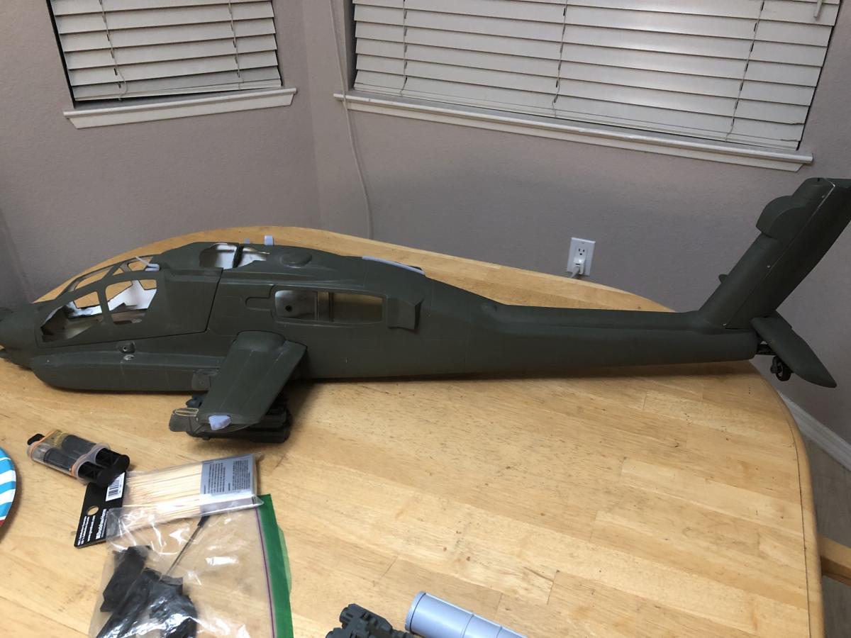

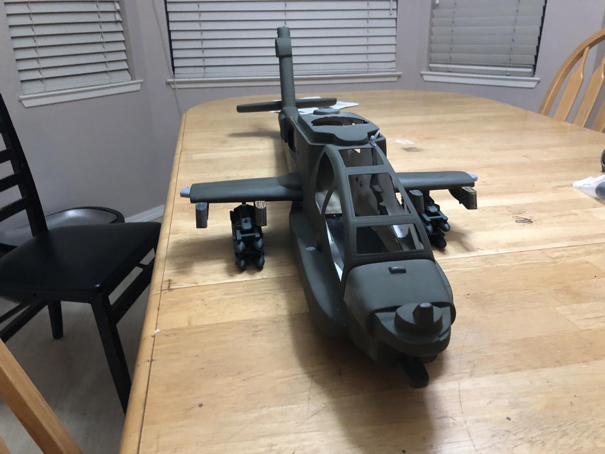

                                          #180
                                          Sweet will do. Just looking for normal decals. It seams the Apache hasn’t got really al lot of colorful insignias, that I have found any way. If you got any squad insignias you can add in, I’m totally open.
                                          PM incoming.
                                          Got my bit glued on tonight, so tomorrow after it’s all dried I’ll clean it up and add some filler to finish them off. I’m hoping to get her primed Friday at work. That way I can start painting end next week.
                                          pics are one side done, other not.
                                          I also took some liberty on the boom parts, it’s kind of a model bash. Seeing as the there are just differences in the stock Roban fuse between the different AH-64 models anyway.
