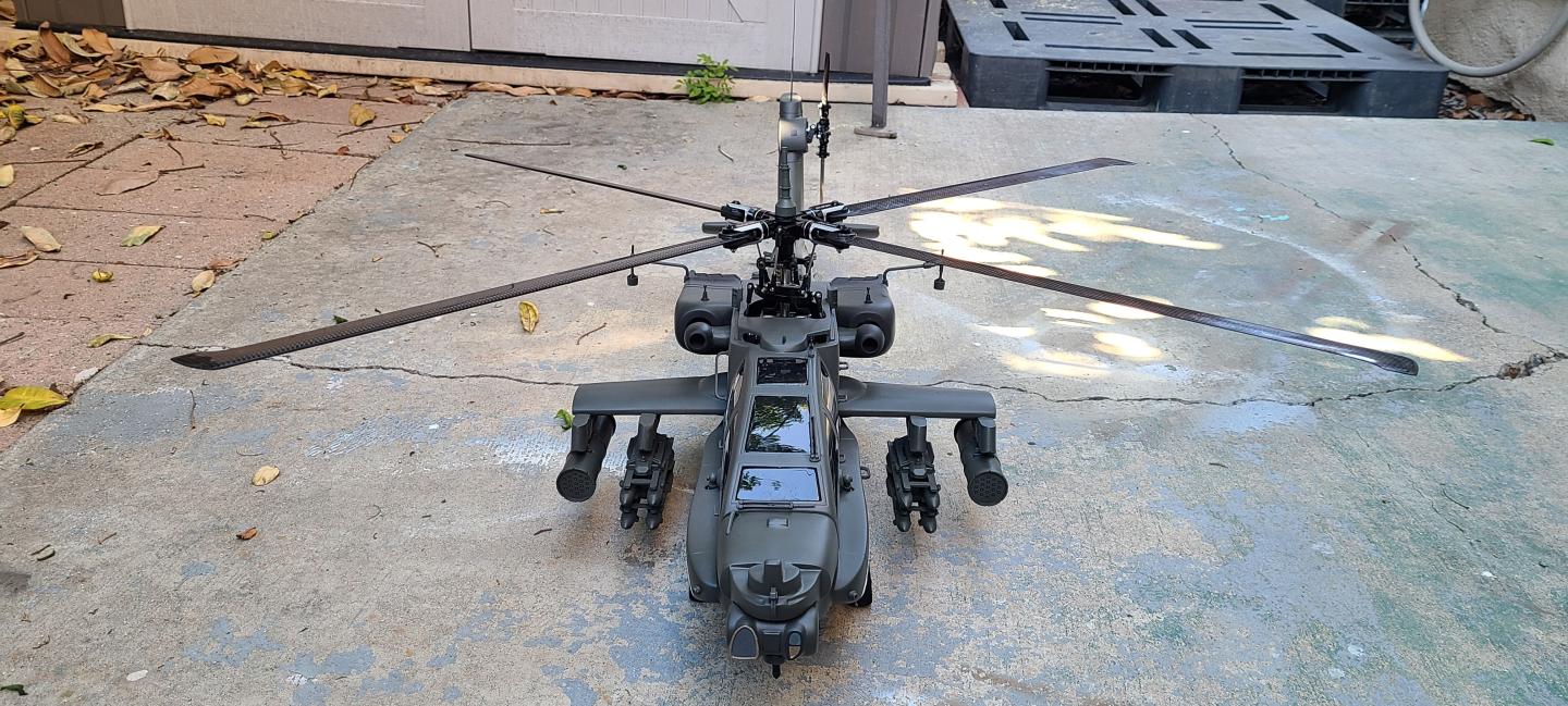

    Almost there. Couldn't find decals for it so a little bummed about it. Very nervous. I may just put it on display lol. But I will fly it at least once.

      Nice work, looks good! For decals, you can contact Callie Graphics and she can custom make some markings for you.

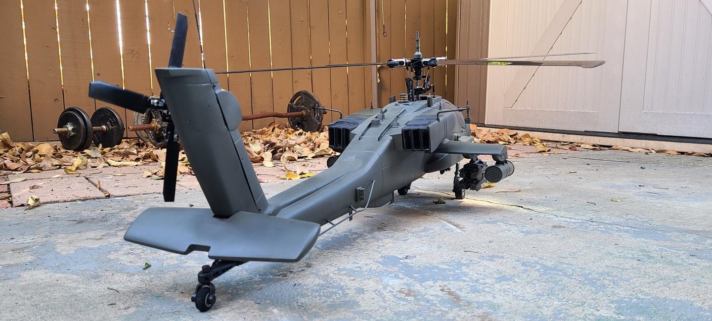

          Now is ready. Although i have yet to hear from Callie Graphics regardingthe decals..I'm using the Talon 90 and the throttle calibration was kicking my butt. The one I got was set up as vehicle mode: airplane. So had to purchase the castle link programmer. I will now find the courage to fly it. Thank you guys for all the help that was provided on here.

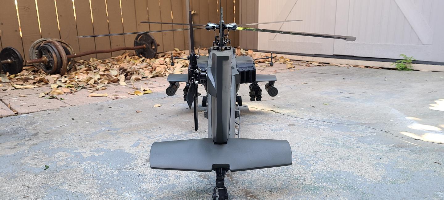

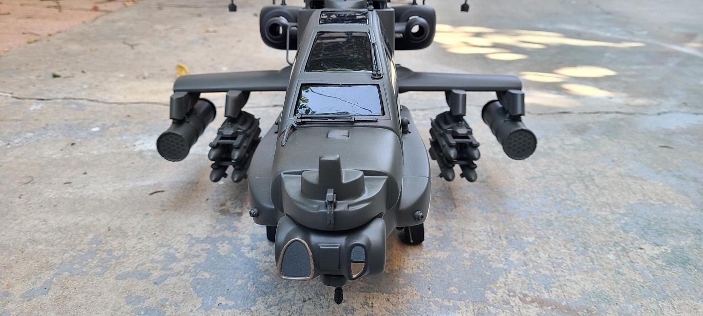

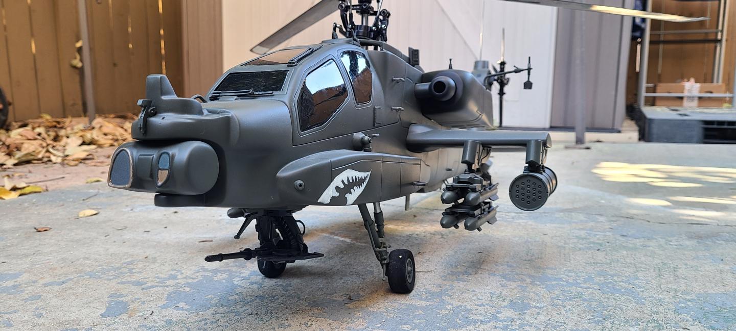

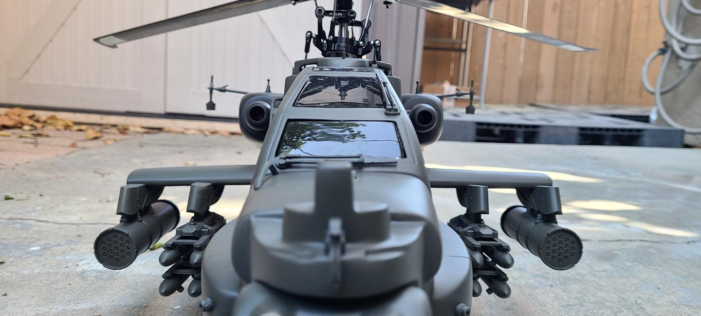

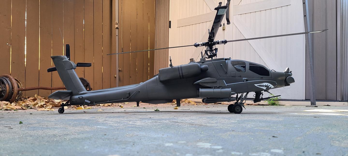

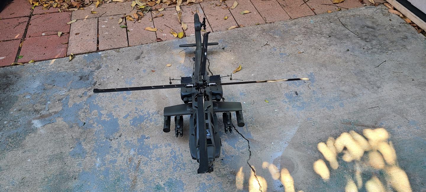

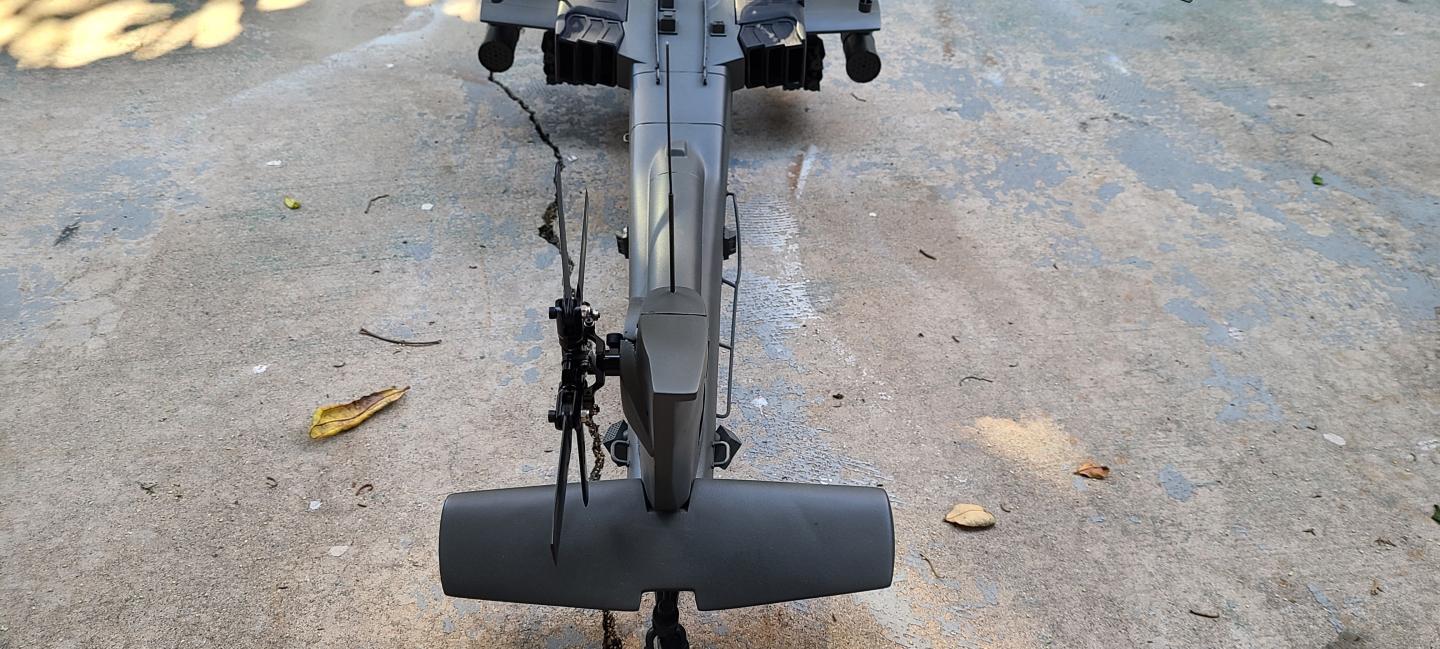

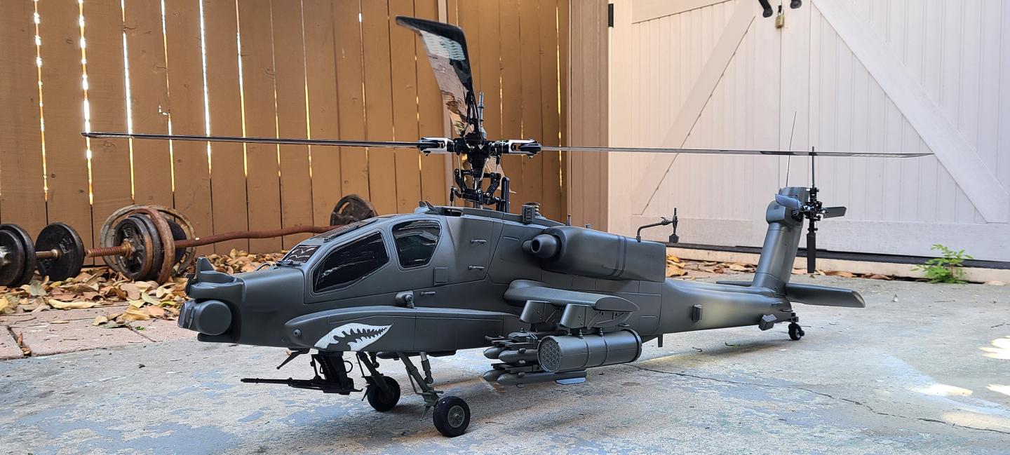

                    #309

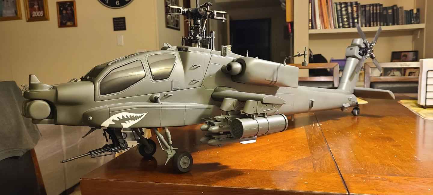

                    Well, ladies and gentlemen here's the end results. Got some decals on (thank you Delta). It flights!!! LOL. Hover it for a few minutes and reenforce the weapons as you can see them a bit loose. I got some video of it hovering. I did the first one with a 4000mAh and then 3300mAh. Turns out, it didn't make a difference so I'll stick to 3300mAh. Thank you all for the inputs on here without it, I would have not been able to accomplish this project.

                      #310
                      https://youtu.be/3Sxg39hg5J4
                      Congrats on the maiden flight, looked great!

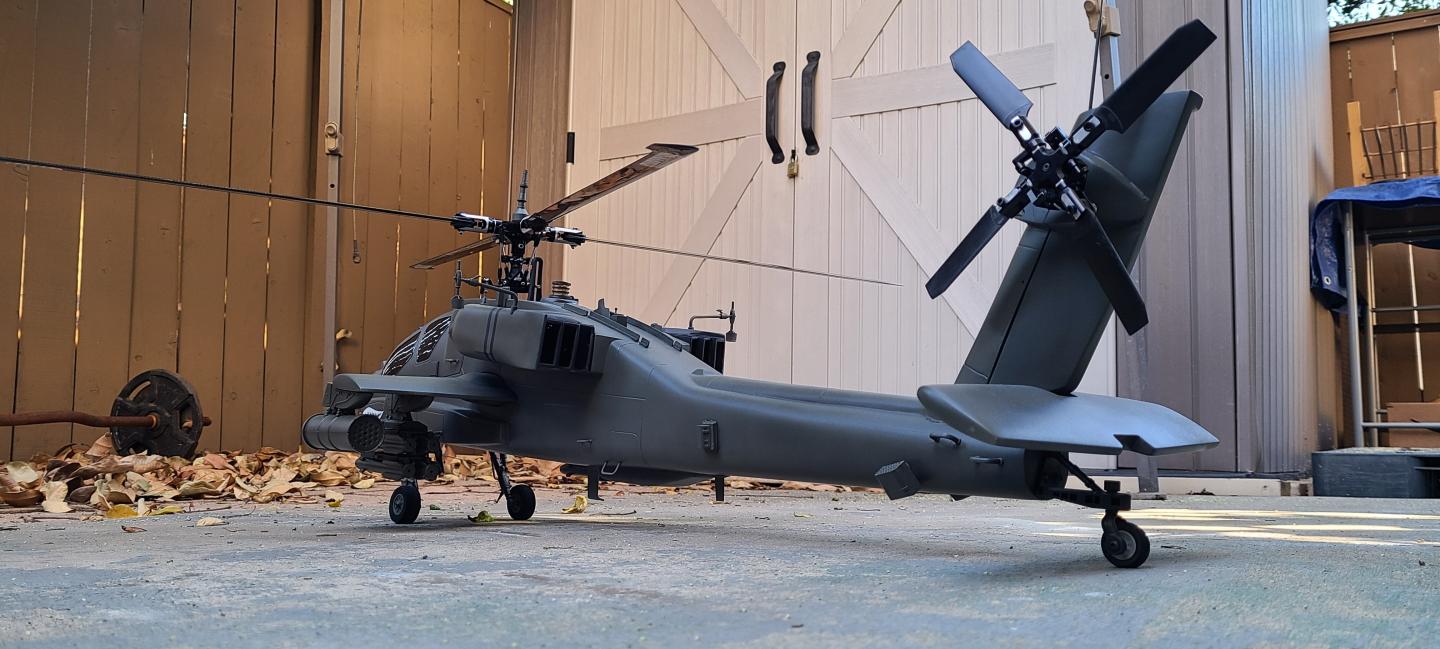

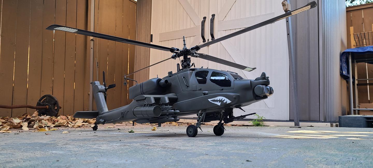

                          #312
                          Got in a few more flights on the Apache this weekend, still enjoying this machine!
