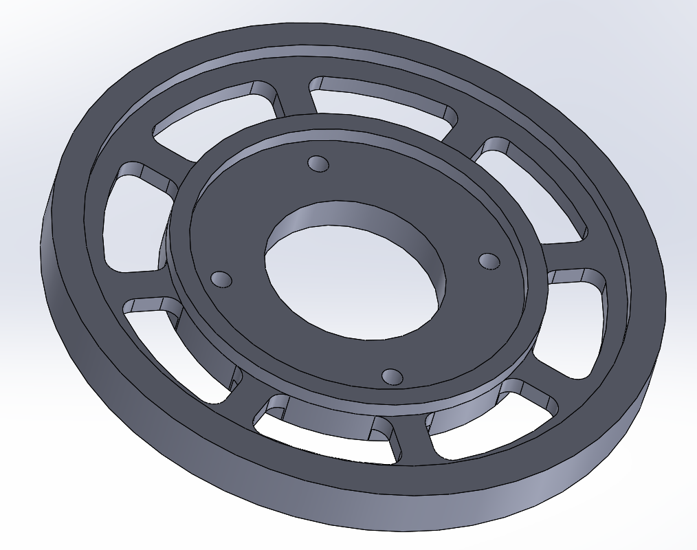

                                        After a lot of back and forth, I finally found a place willing to make me a gear in aluminum. This should be able to hold up to the stresses of a 4 blade head much better than the stock nylon (of which I have stripped 3 gears so far). It is a two phase operation. First, the gear has to be machined without the teeth on a machining center. It will come out of that machining looking something like this:Click image for larger version
                                        Then, I take the gear to a gear specialist that will cut in the teeth. Hopefully, the Apache will be flying again soon with a new aluminum main gear installed.
                                        • #80
                                          Finally received my Aluminum gear this morning, and I can’t wait to start getting the Apache back together. The gear came out great!
