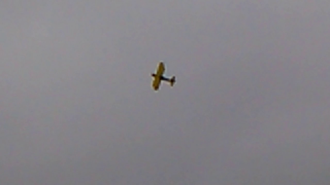

                Both flew successfully today, however on the stock setup i suggest 4s on the PT17
                  #348
                  Heres video of the PT17 on 4s.
