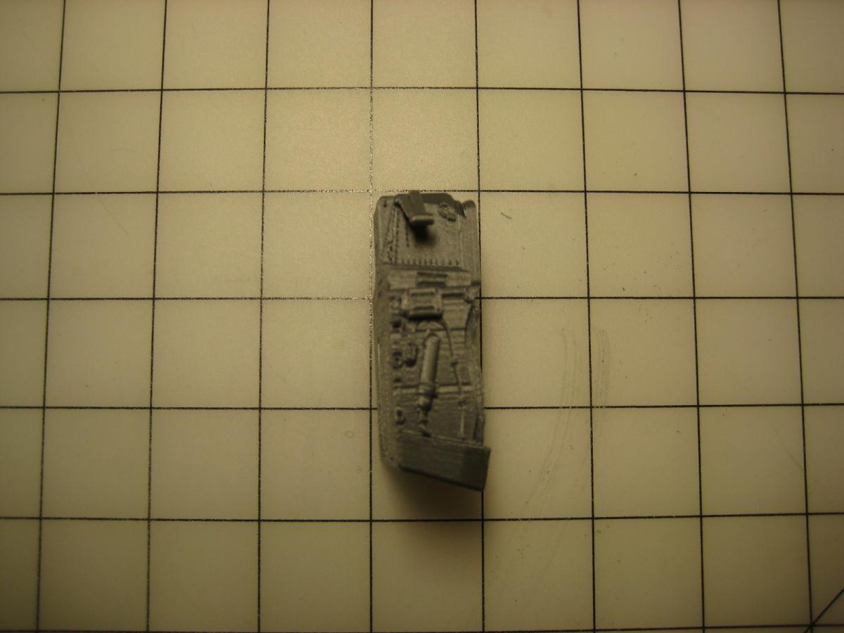

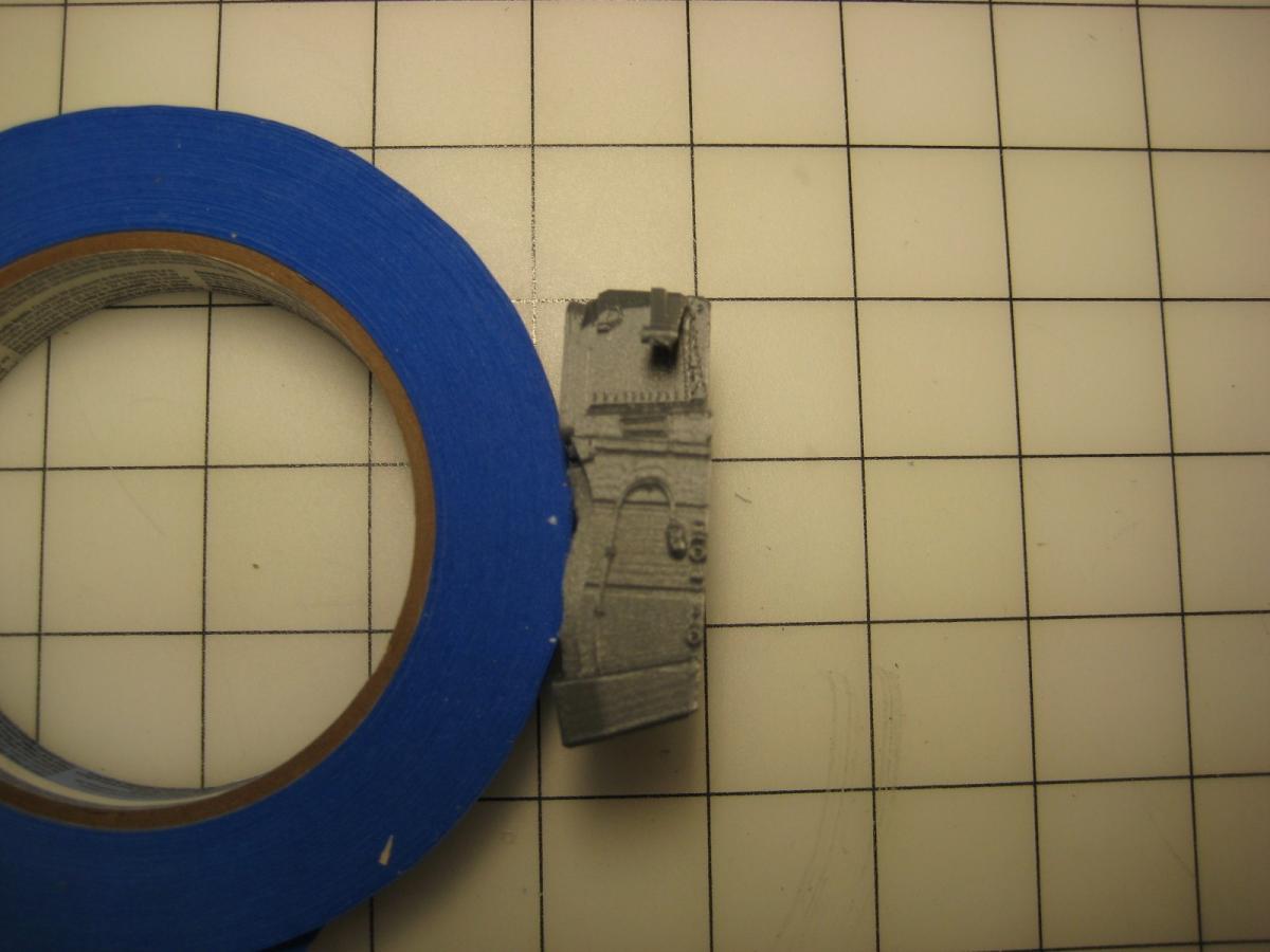

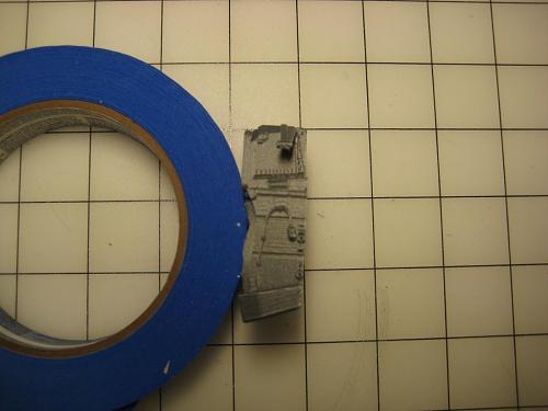

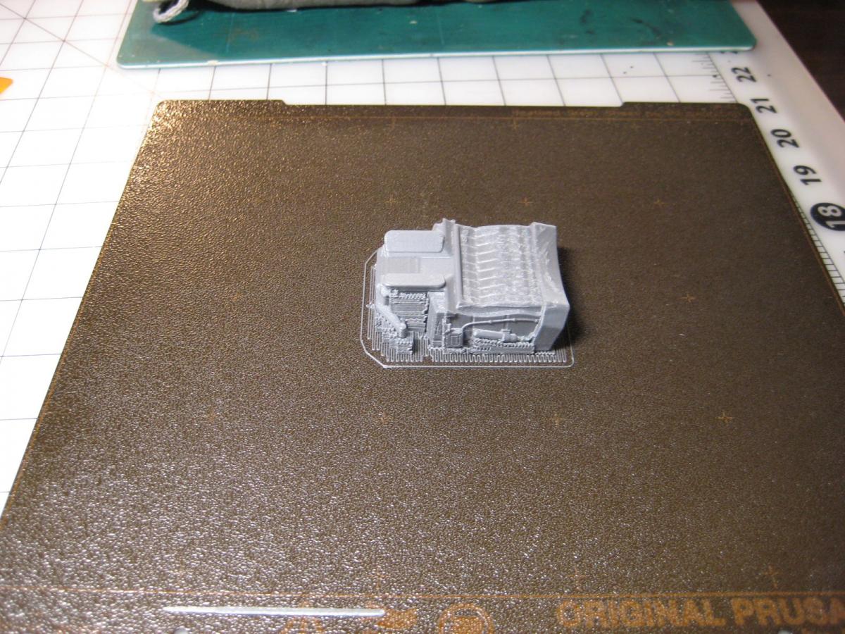

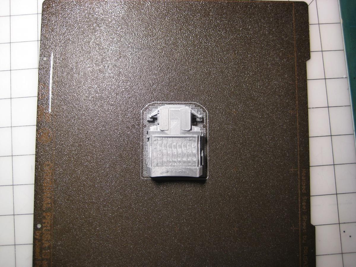

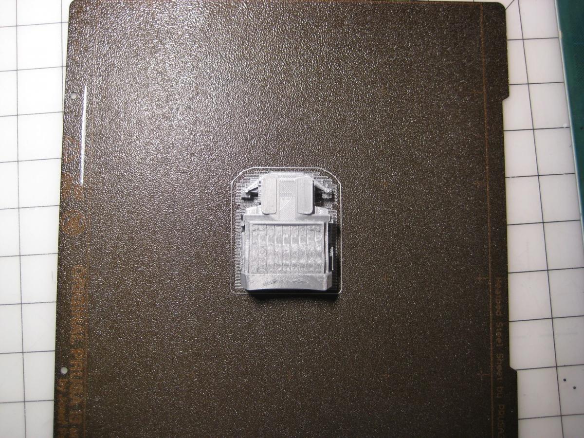

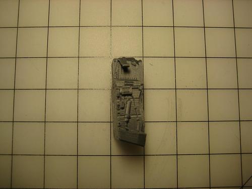

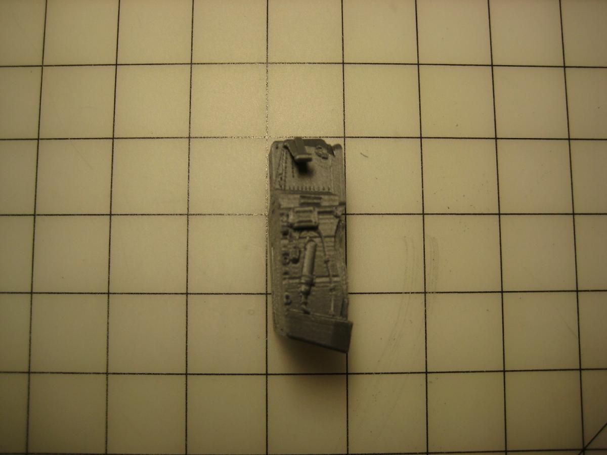

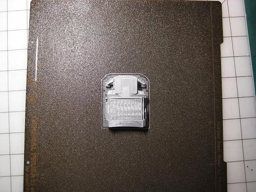

                PLA Print of the Raptor Ejection Seat. Detail setting Prusa i3 Mk3 with 10% fill. Nice detail on sides but not so much on face of the seat. I rotated the print to print seat face upward. Best, LB

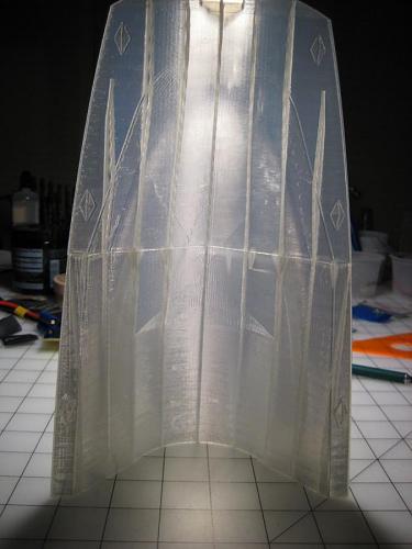

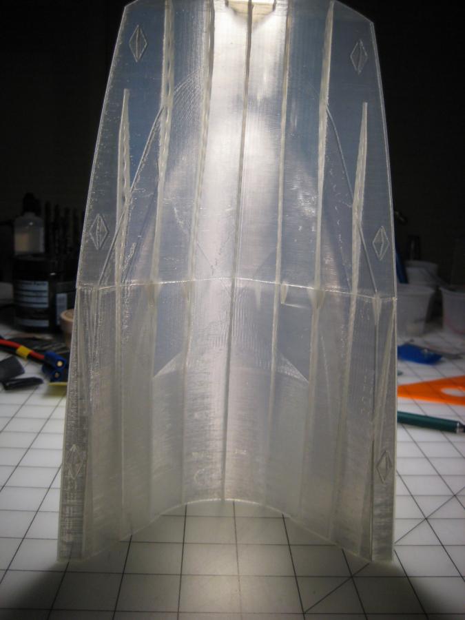

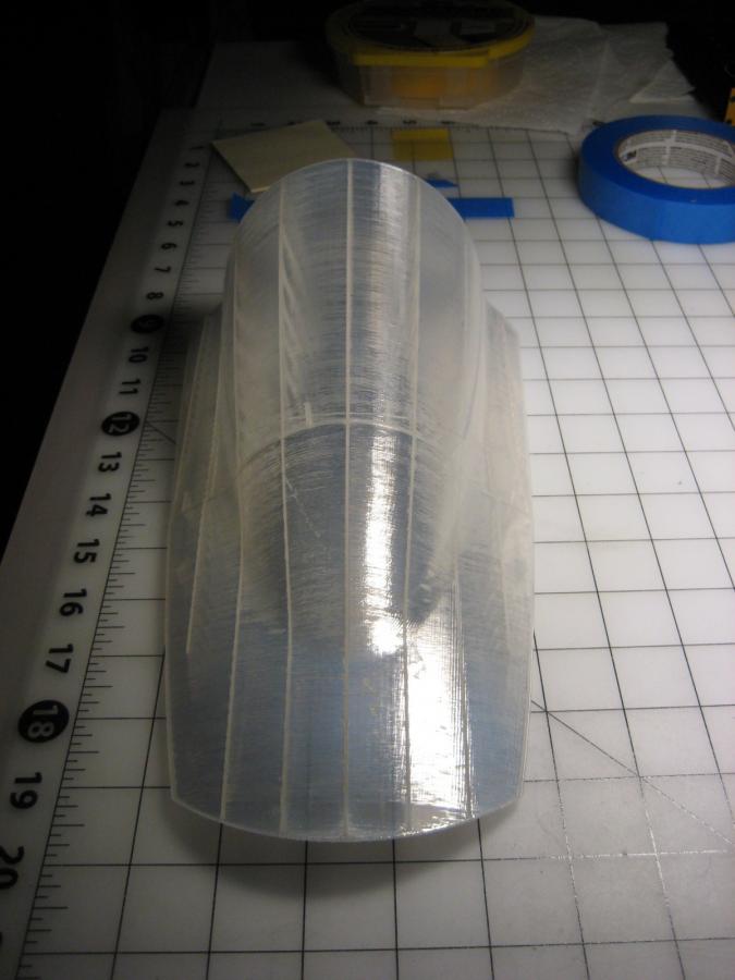

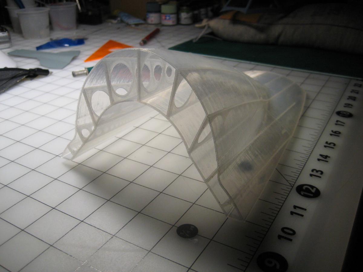

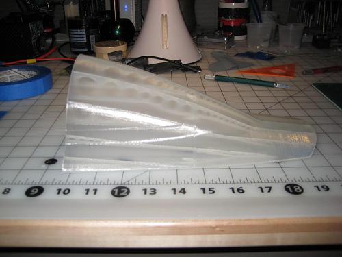

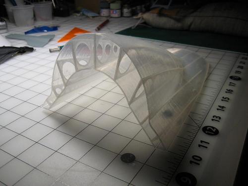

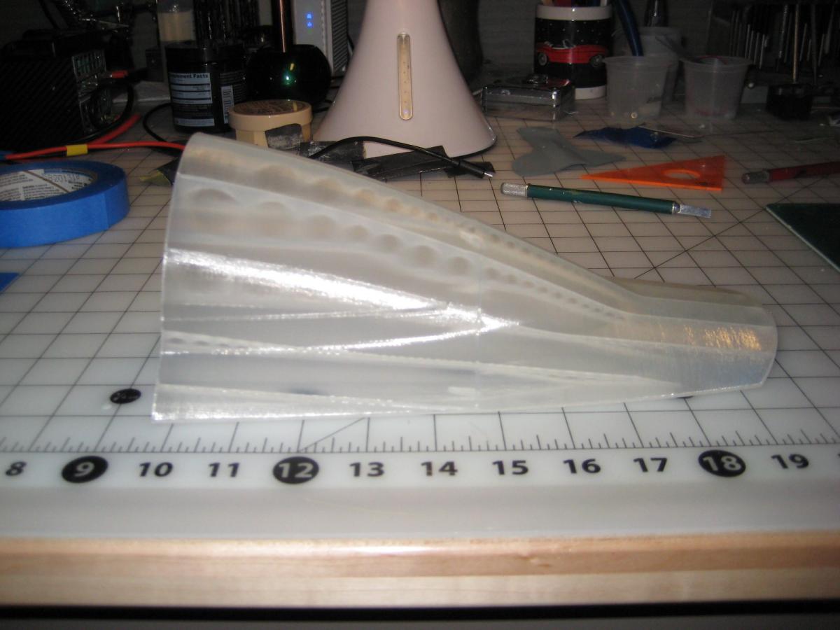

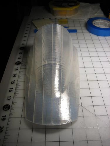

                  Hey Y'all, First print with MatterHackers 'Transparent White' on the first of the F-86 canopy sections. It is 'clear' enough for this project and I like the structure showing through. Would definately try PETG or Polycarbonate. Best, LB

                    Nice! If it weren't for needing to be a structural part with all the ribbing that would be fairly transparent.

                      RCJD, I dig the structure but using ABS you could polish it somewhat. I tried acetone polish on a piece of the PLA filament and it clouded it. Also, the walls are so thin I am certain it would melt it. Have you tried smoothing your ABS structure? Best, LB
                        #231
                        I have not yet tried Acetone. May do it on a scrap to test.

                          I wonder if it would be better in that case to use this canopy print as the base to create a buck for use in a vaccuform machine. You'd need to reinforce it with formers to retain the structural rigidity required of the original part, but at least the end result would be an actually clear canopy.
