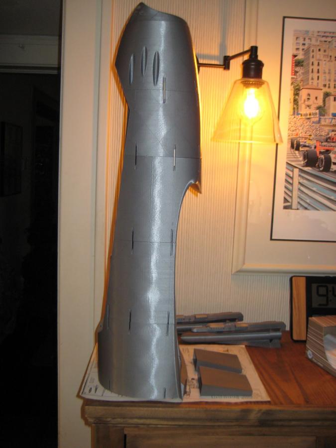

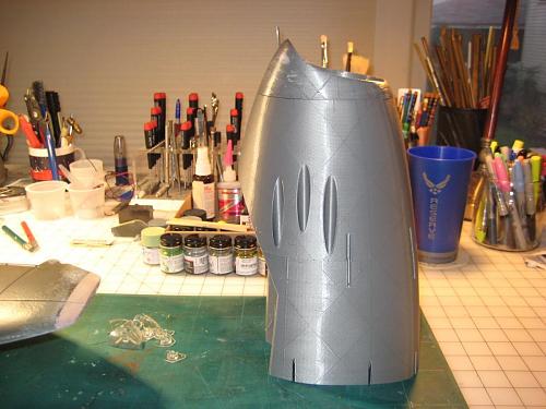

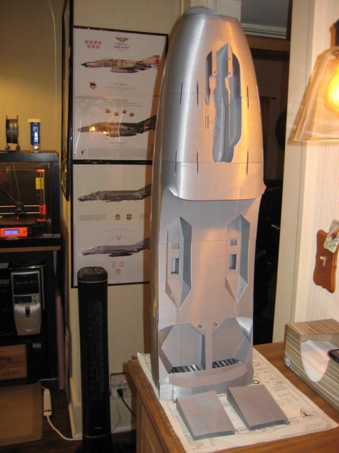

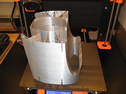

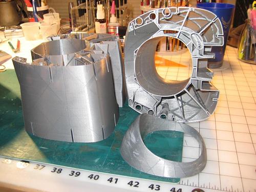

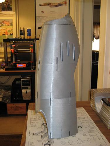

    Hey Y'all, Fuselage_3 completed and had some thin spots of the 'thin' wall construction. Chatted with 3Dlabs forum guys and it is not unusual so I will 'press on'. The structure of this is quite fascinating to me, though I am easily entertained. I have looked on MotionRC's site and I am thinking the F-4 90mm setup is the way to go here, but are all 90mm EDFs 8s? The recommended setup is 90mm EDF and a 1750Kv motor with a 100+ amp ESC. I'm in the learning curve just hiding behind the door. Any help here would be appreciated. Best, LB

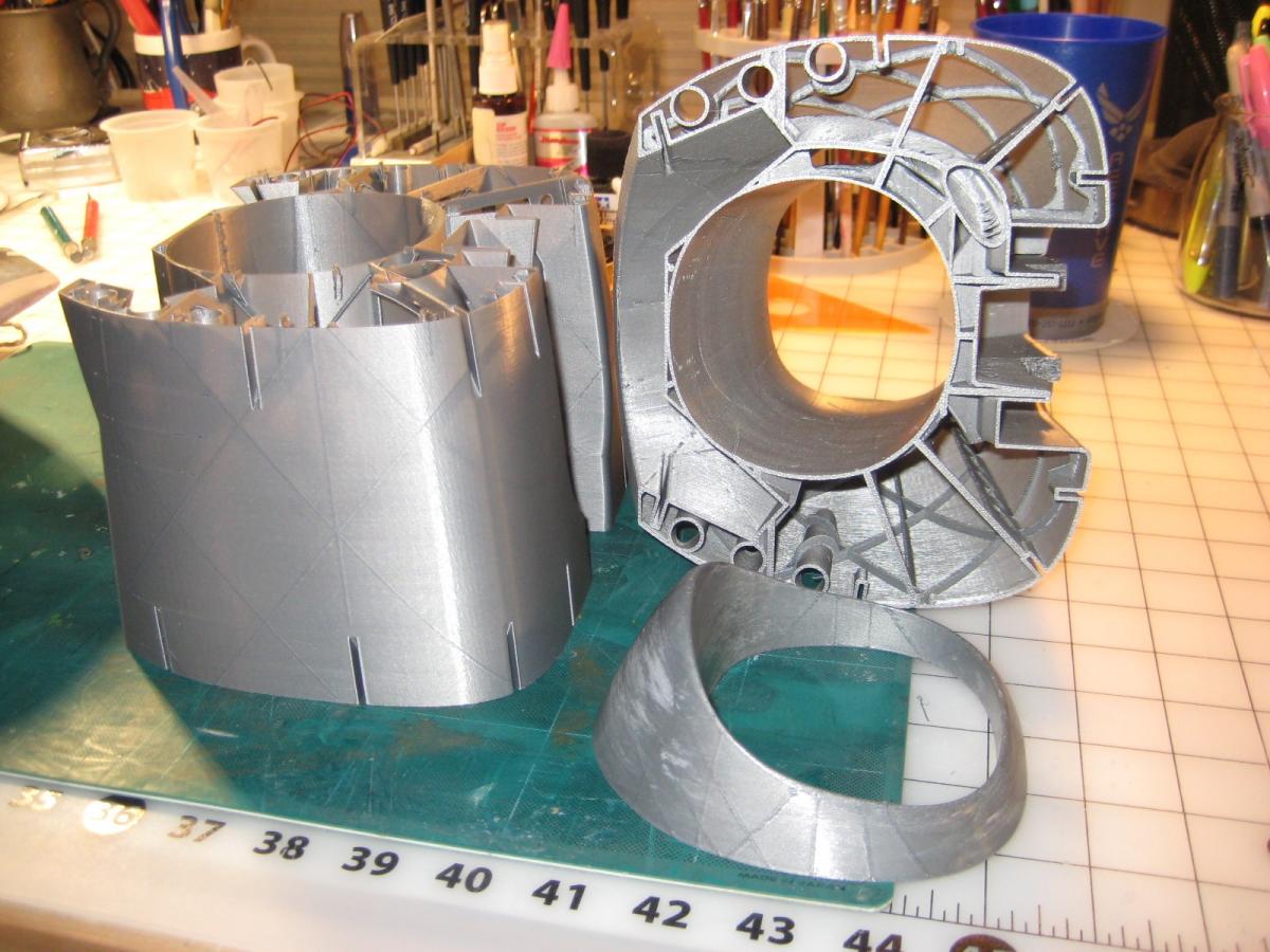

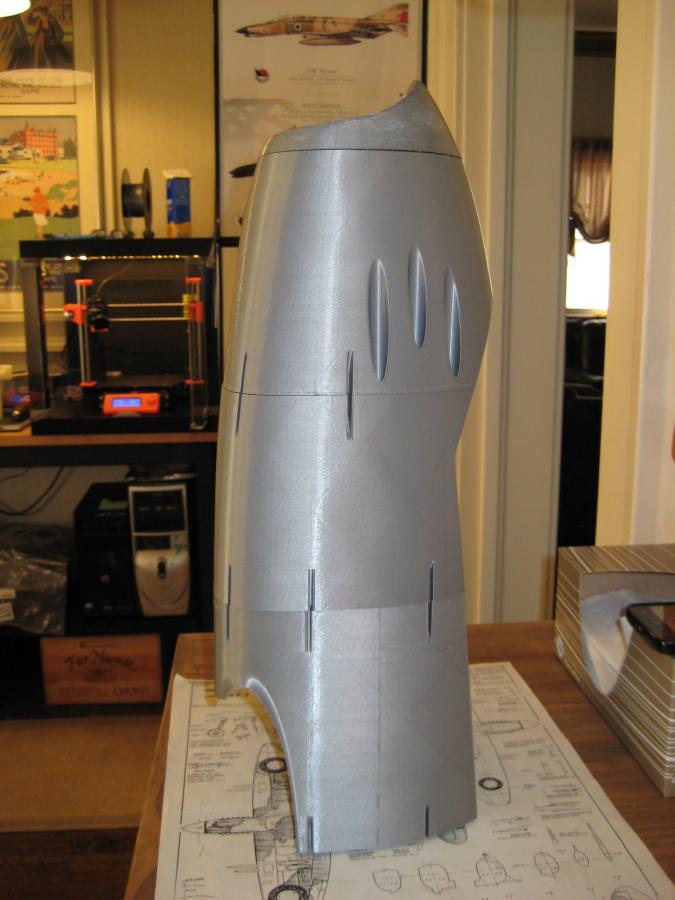

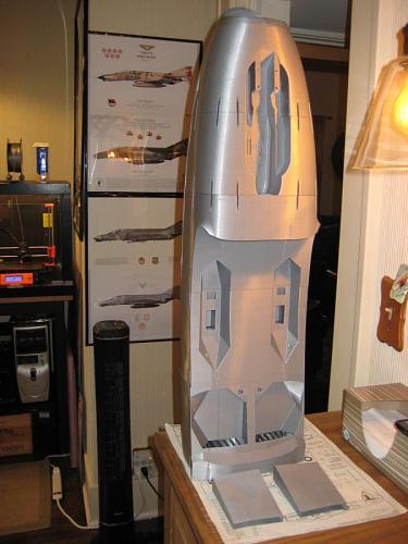

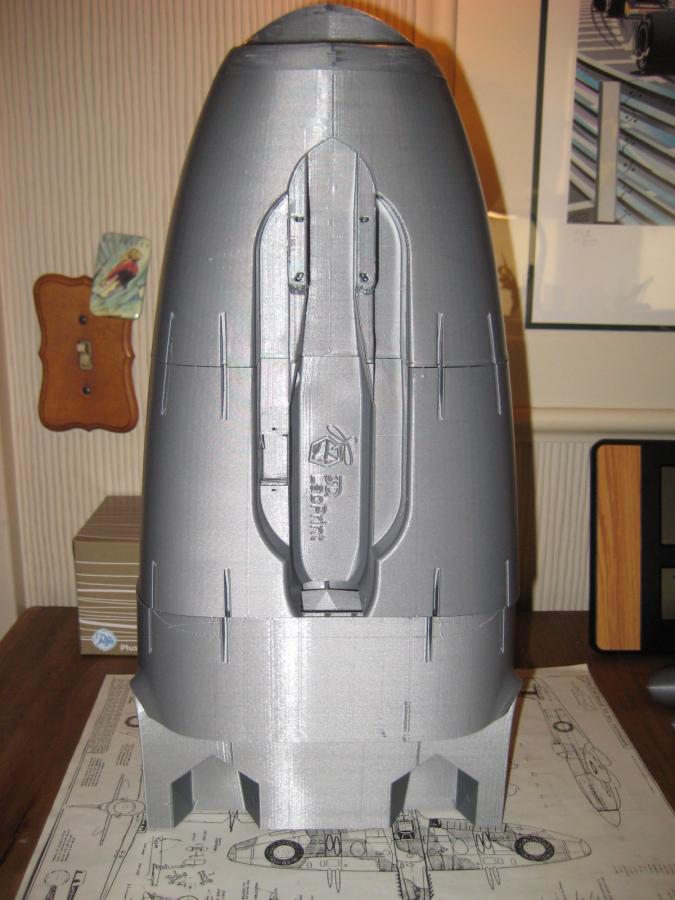

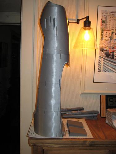

        RBTX, Thanks, I started out using the glue stick that came with the Prusa kit, which was just like Elmers Xtreme as far as I can tell. There is another better product called 3D Gloop www.3dgloop.com which works even on glass but leaves a residue. I have used both and these work. However, I have the Powder-Coated TXT Spring Steel heat bed sheet which once it is broken in no longer requires an adhesive. I clean it with acetone before each print and I scuffed it up before I printed my 2nd print as I had a problem with adhesion at first. Pic is Fuselage_4 the largest piece so far. Best, LB

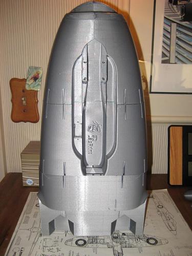

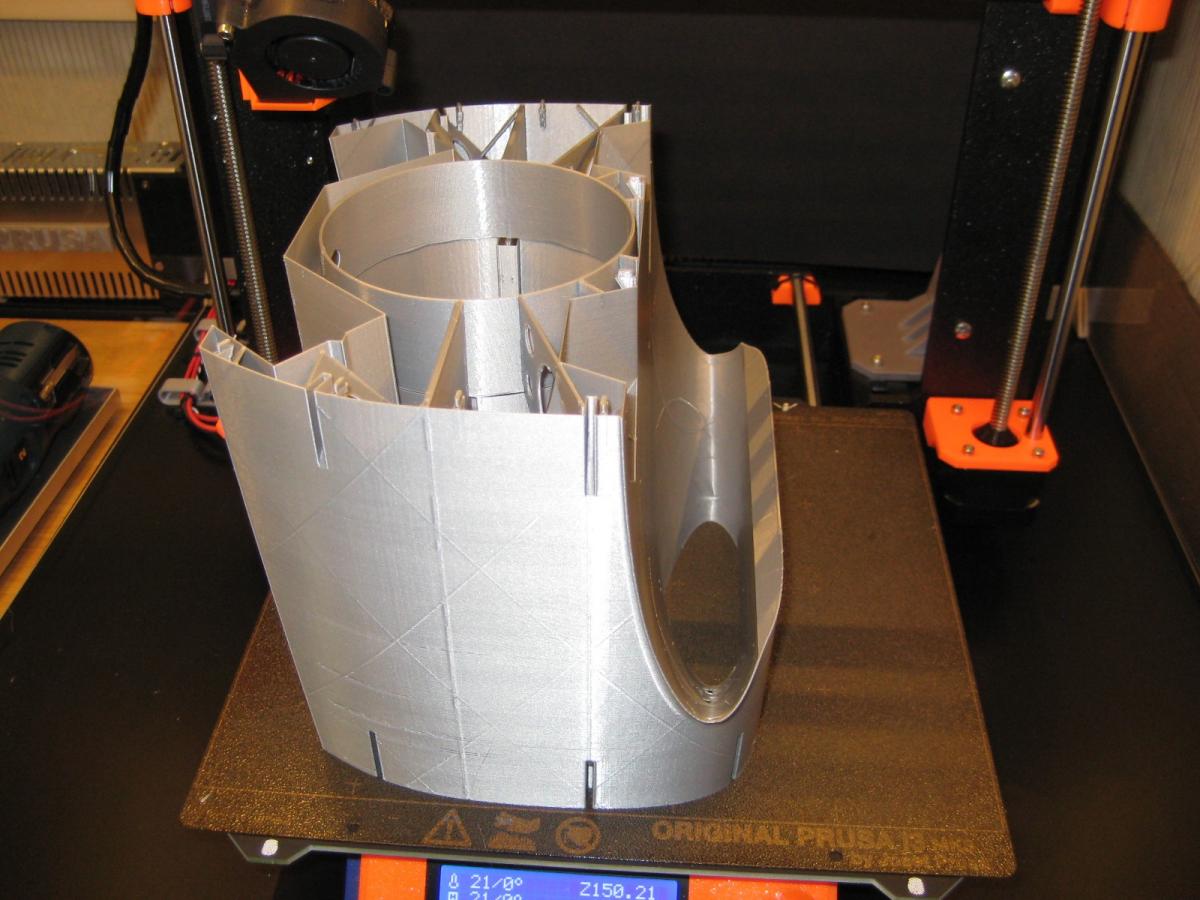

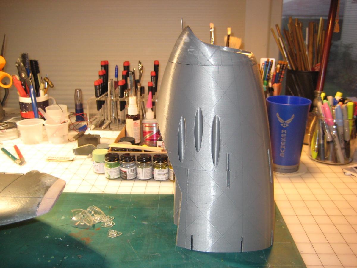

                                      RBTX, I like HO Scale, just difficult to RC gear in the airplanes. Fuselage_6 added. Tammes said, "It's getting so big." Cracked me up as my mind went immediately to the gutter. LOL I've said too much and she is just a champ for putting with me. Anyway, Best to all this Sunday AM and "Go Chiefs", LB
