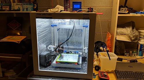

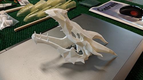

                  My printer was purchased second hand and came with the enclosure. It is a wooden cabinet with a hinged wooden frame glass door. The inside has been lined with that thin foil insulation material. Inside the cabinet in the front left corner is a cheap little space heater that is controlled by a controller I got off of Amazon. It turns on/off the heater based on a temperature probe. I have mine in my basement which is an unheated space and can get a bit chilly in the Winter but the heater maintains a nice 40C ambient around the printer. I replaced the print bed with a piece of mirror glass which was flatter than the original bed. You can tell by how the first layer goes down. I also use cheap hair spray to adhere the print to the bed. Tried glue stick but the hairspray works better. You need the kind that has a certain ingredient in it. Do a Google search and you will see what I am talking about. The only other tool I got was one of those thin metal artists spatulas used for painting. Works great to remove the print from the bed. With this setup I can print ABS like a boss.... It can be frustrating at times but don't give up. Plenty of helps out there for the slicing software you will need to use. I use Simplify 3D. I just went ahead and paid the one time fee for the license. I also am trying to get better at Fusion 360 which is free for hobbiest and some powerful software. I am only scratching the surface with it. Start with some simple objects off of Thingiverse. I was very ambitious when I first got mine and tried to print a Skyrim dragon skull right off the bat. That was a lesson in frustration but I eventually learned and was able to get a successful print with ABS. Good luck and happy printing.

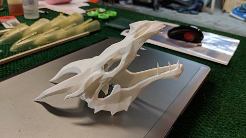

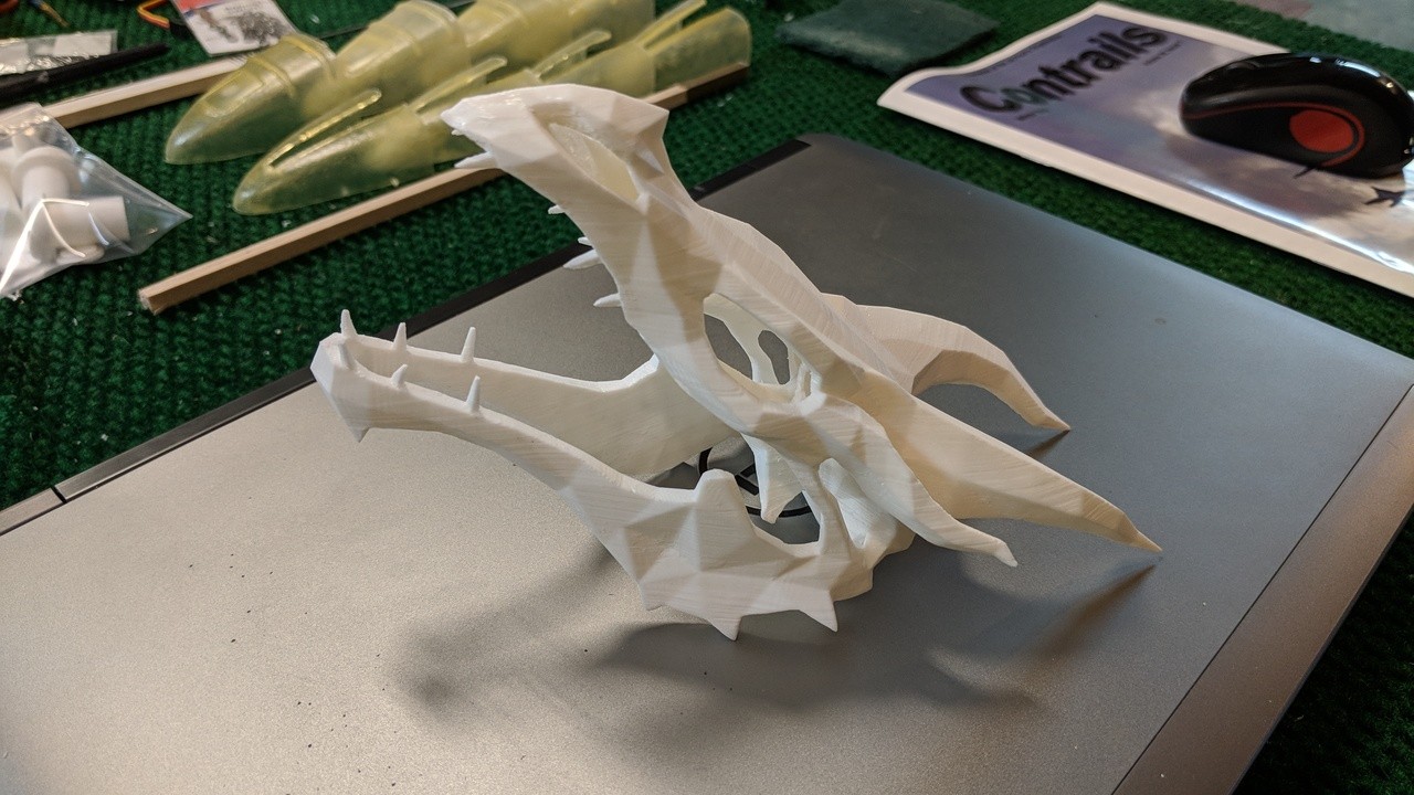

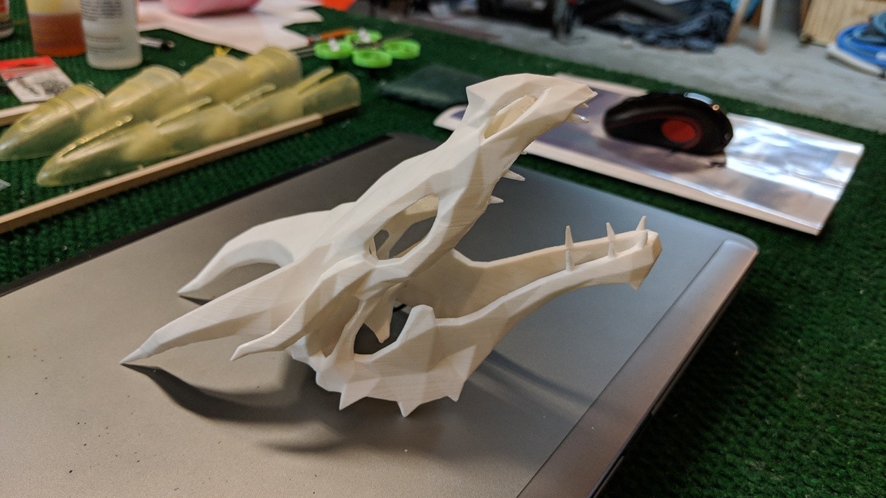

                  The dragon skull. Required a lot of support structures.

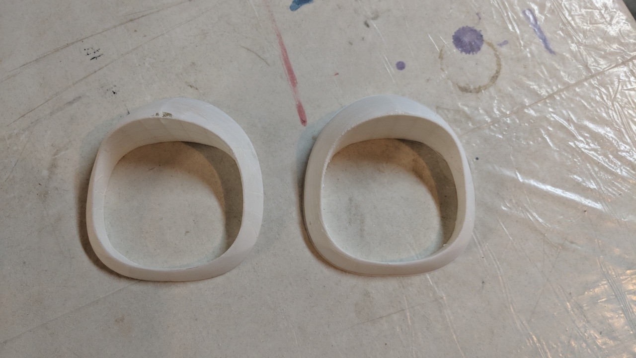

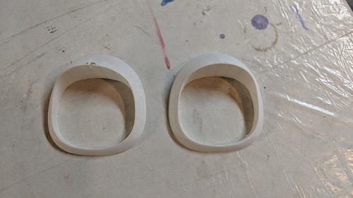

                                  Yes. I did a test piece on the intake to see how it would print and had to make some adjustments. First print was just too thin. Second one came out much better. I just got my first roll of Silver ABS today so now ready to turn it loose!
