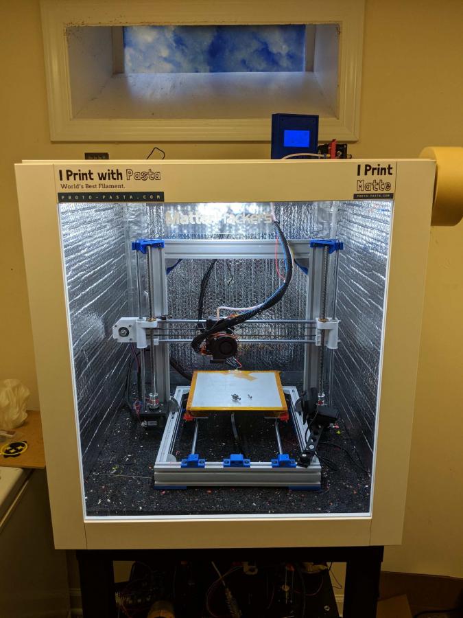

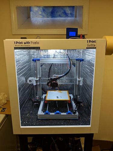

                              I am getting an Anet A8. Not the one I was talking about earlier but another even better one that is all ready to go and comes with an enclosure. It has all the same mods that the other one had but this one has an aluminum frame. Should be up and running by next weekend.
                              • Prowler901
                                • 940
                                • Gunnison, CO
                                #55
                                Cool, that's a good one. :Cool: Much better with the aluminum frame. Much more rigid. Have fun. :)
                                  #56
