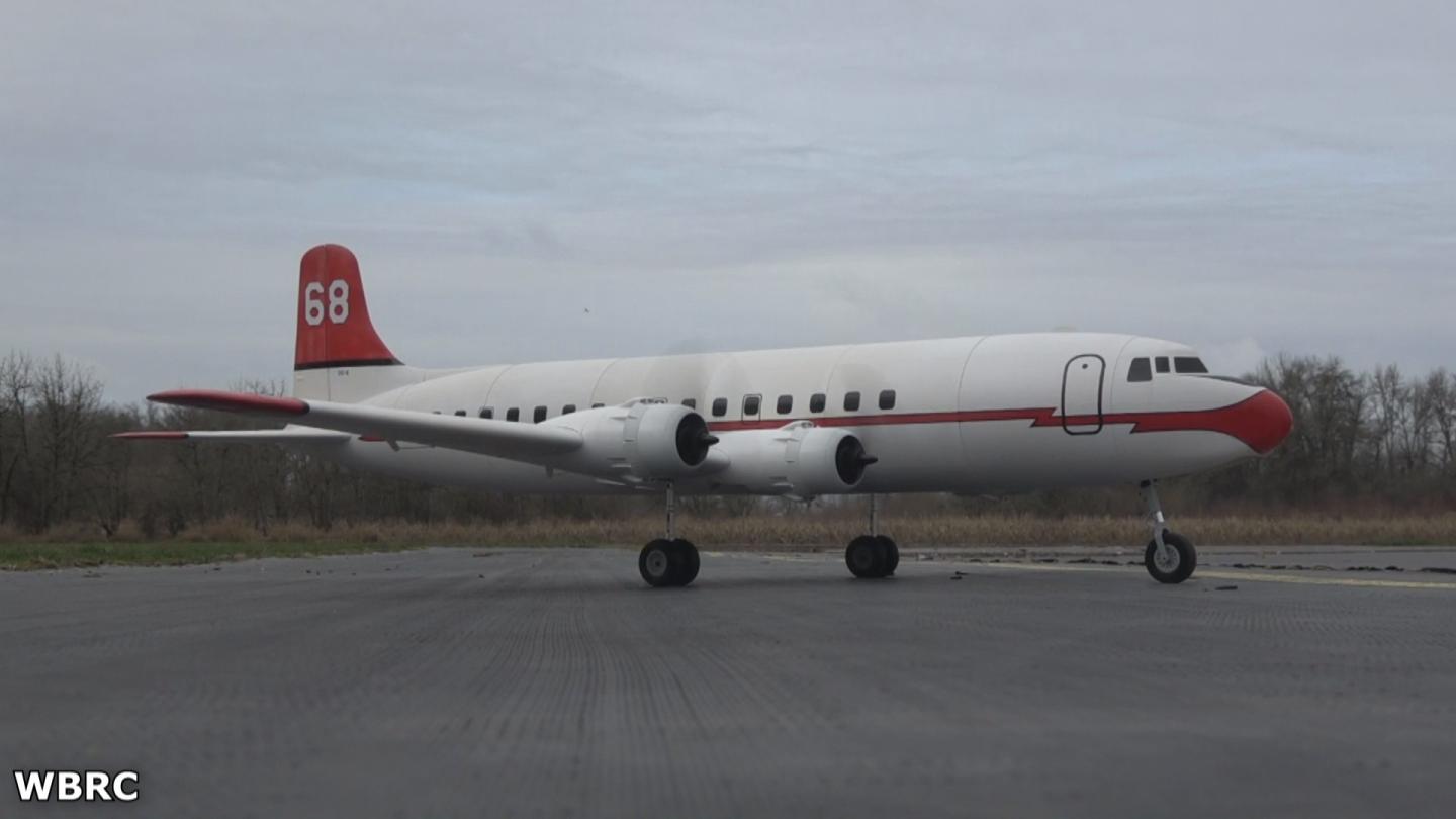

      I just maidened this beauty. 3D printing has come a long way in a short time. Click image for larger version

        WB, she is thing-a-beauty. Nicely done. What are her specs and equipment stats? Best, LB

          Many thx. 1800mm wingspan, 4s, 3600g AUW, 170 hours print time, LW-PLA, printed with Creality Ender 10 v2.
          No wing spar by design... seems strong enough, but flexes a bit. 40 years of using wing spars made me nervous about it. We'll see how it does in the long term.
          Rattle can paint and hand cut vinyl decals.

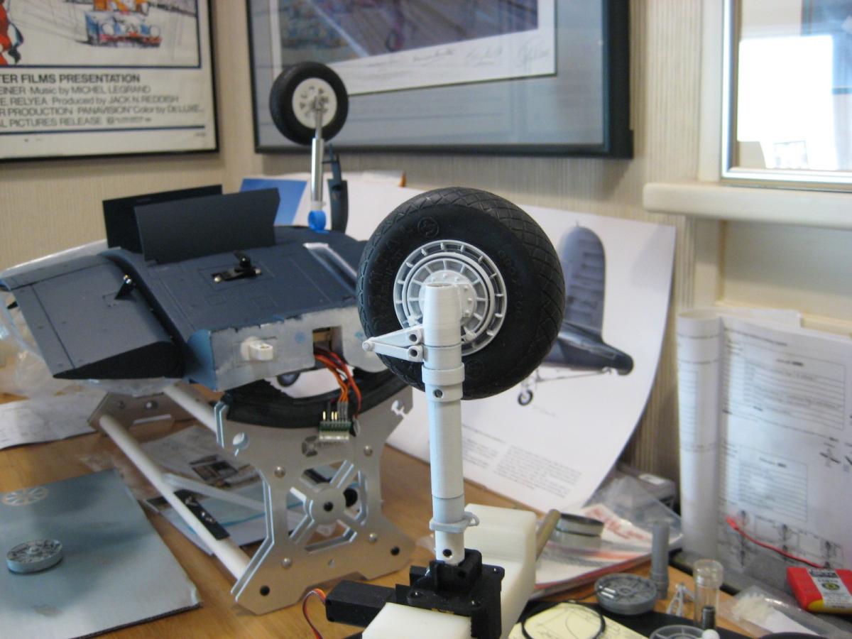

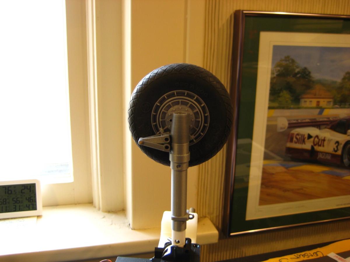

          Hey y'all, I've doing a bit-o-3DP for my FlightLine 1600mm Corsair. Though not as exciting as an entire airframe, I think it is always a good thing to add features. I've always thought strut covers could be improved upon. Robart are okay, but mostly for the music wire struts. These are my attempt at some updating, Best, LB

            Looks Fabulous, Elbee!! 👍👍👍

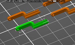

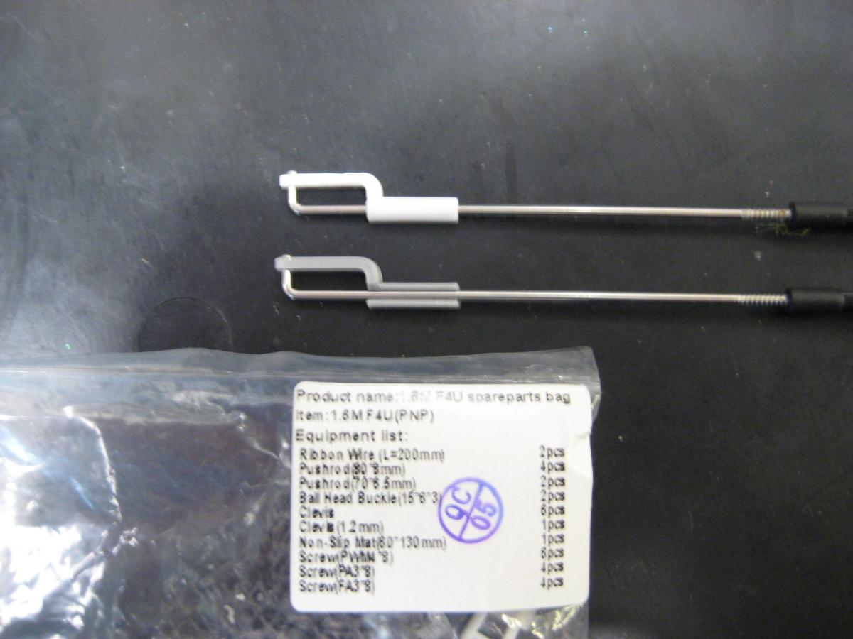

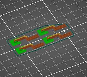

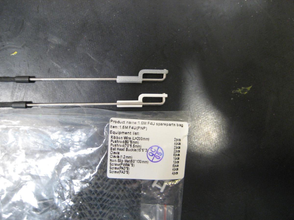

                                [ATTACH]n376290[/ATTACH]

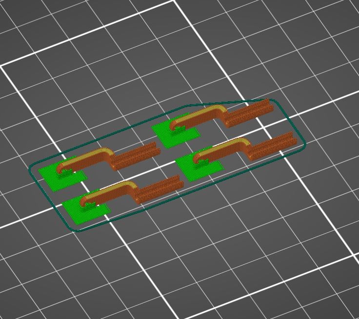

                                Hey 3DP Printers/Aviators,
                                I designed a replica of the Freewing/Flightline Clevis for the 1.5mm Pushrod.
                                I was given 5 for my Flightline 1600mm Corsair Bubble-Top instead of 6, see picture.
                                These are available from MotionRC in a package of 6 pcs for a reasonable $2.39USD.
                                Shipping these little fellows to me in the "Heart of America" is an additional $4.21USD via DHL and will take approximately 10 days.
                                So, what to do?
                                Best, LB

                                  Post the STL file on Thingiverse.

                                    Kallend, not really a guy that posts over there. I understand they are working on the website. Anyway, here's the STL if you want it. Let me know if it downloads poorly. I put it in a ZIpfile. Best, LB

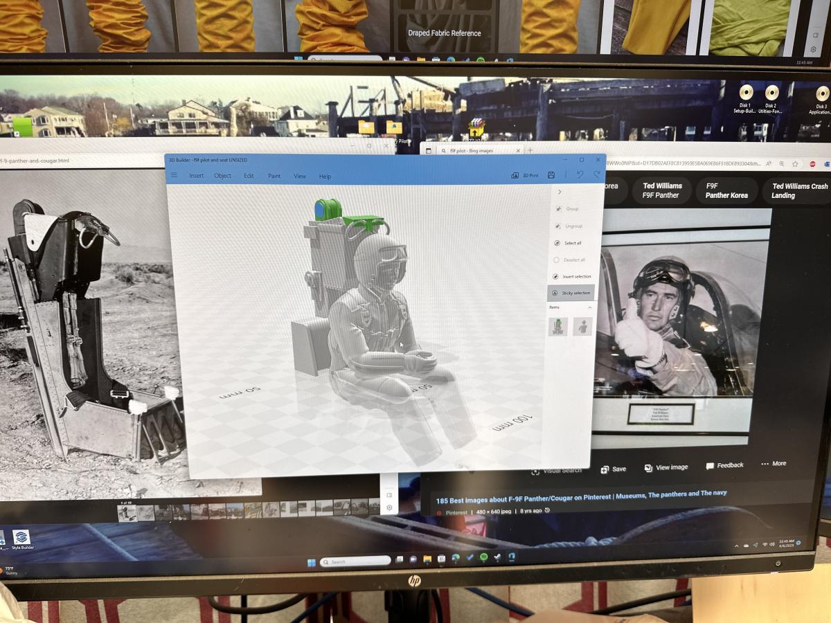

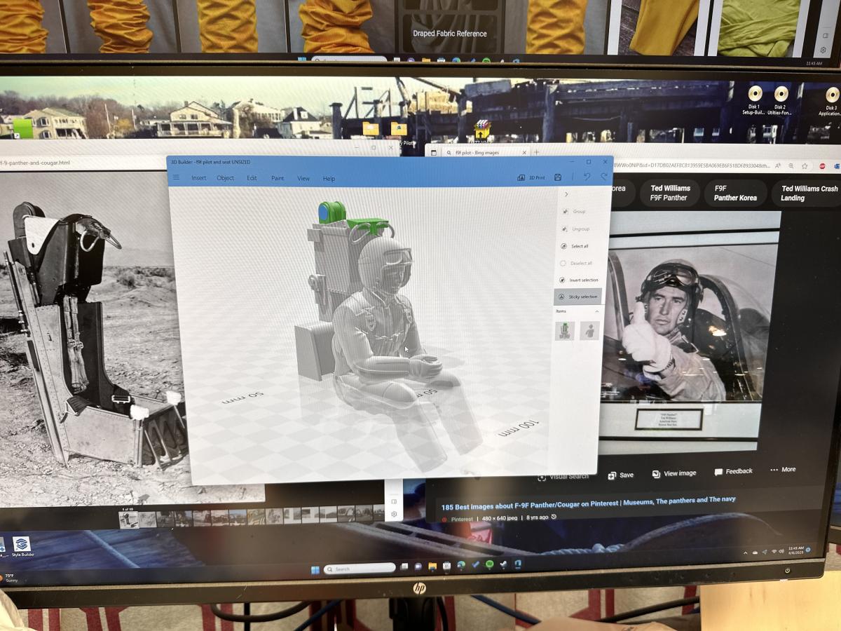

                                      I'm looking for a decent replacement for the ejection seat for the f9f cougar. It doesn't need to be perfect just good enough so the scale monkey on my back doesn't itch.
                                      I've been messing around but haven't found the right look yet. So I thought Idd cast about to see if anyone has a seat design similar to the seats Grumman made for the cougar
