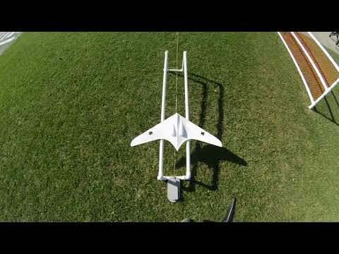

                            My next project is going to be a fun one! I made a smaller Ho-229 for slope gliding but adding an option for a prop/slot powerplant in the tail, and then will move on to the larger 1680mm wingspan for twin 50mm EDFs.

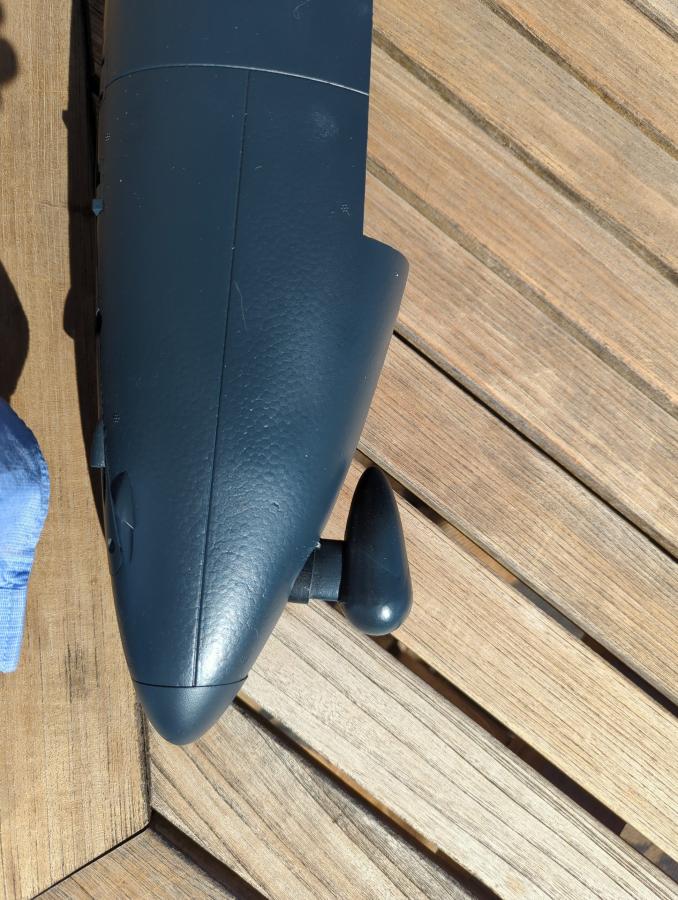

                                Whipped up a fancy nose antenna for an F7F project I'm working on. I'm also working on some drones to hang from the wing, but they aren't ready to show off yet.Click image for larger version

                                  GT, Very Nice. Bravo Zulu, Sir. Best, LB

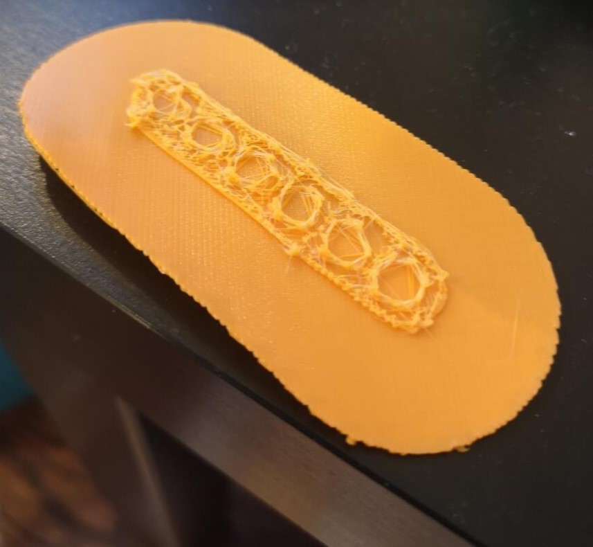

                                Hi there! When printing a test project of 6mm holes and something is wrong. PLA, 200x50, nozzle 0.4. Printed on Anycubic. Straight lines of the substrate, as well as on parts without holes are is ok, covers and sides are even. Printing a model in the form of a ring with a diameter of 50mm and a wall of 1mm, the first layer without a substrate is also thin snot, then it is approximately aligned to the 3rd layer. On printing parts with holes with a diameter of 10-12mm, the bottom of the holes is skewed, and the top is perfect. What can cause such a defect?

                                  B4, Would like to see the STL view of your design; however, it appears there is a layer height or registry issue between the oval base and the top detail. Layer height cause could be the detail portion is not flush to the top of the base in the design. A good way to test this is to raise the height of the detail from 0.0-Z (heat bed) to the height it is meant to be and combine the parts. This way the detail will be embedded as a part of the base. If you've tried that or it was designed in this manner, you might reprint the design in a different area of your bed. You control that in your slicer program. Best, LB

                                    Maybe over extrusion as well?

                                      Yeppers.

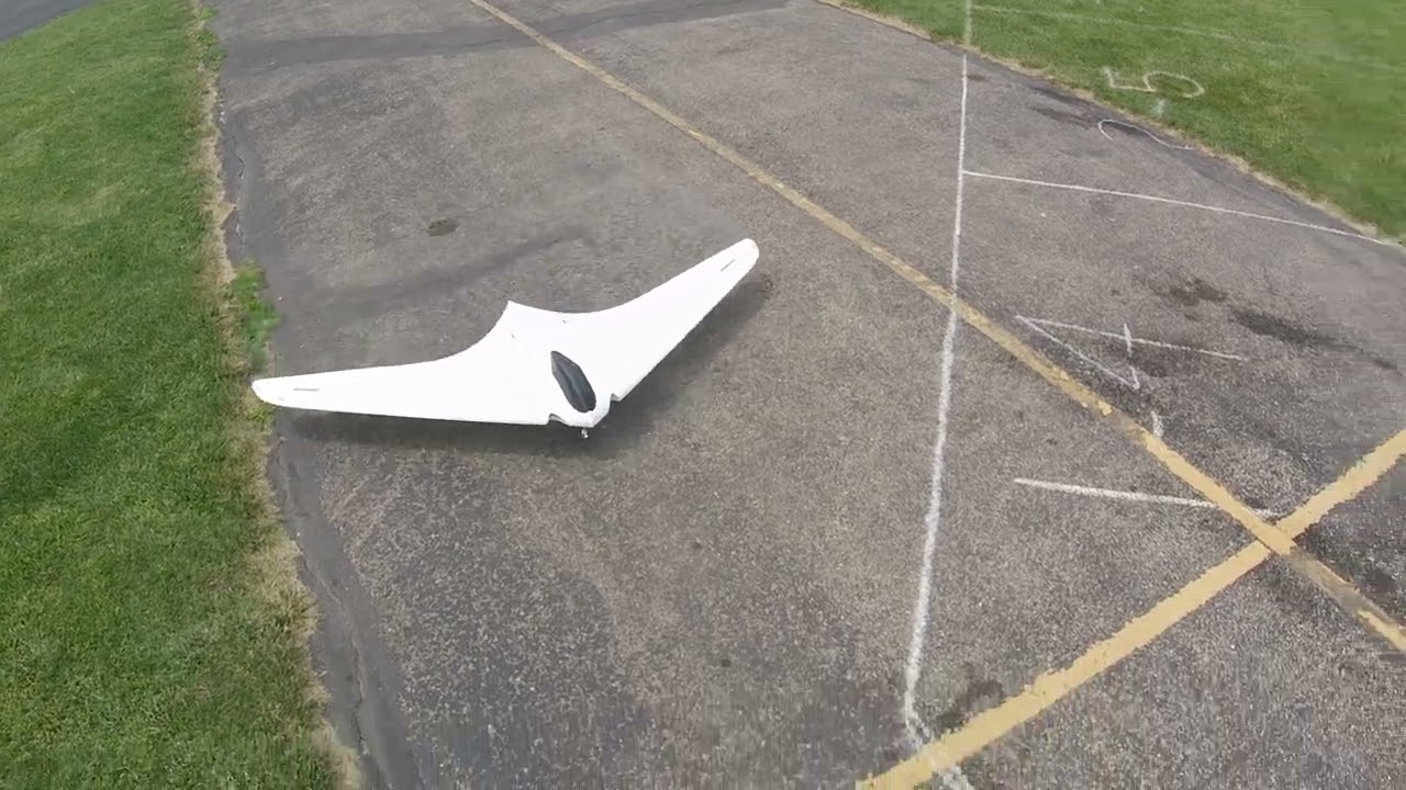

                                    Here is my 3D printed Horten IX (Ho-229). 1680mm wingspan. Flies close to 5 minutes on a 3700mAH 4S with twin 50mm EDFs
